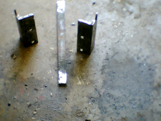

illinilefttackle 399 #13 Posted December 26, 2012 I dont have a better picture-this a bracket like yours I cut apart-the angle pieces mount up and down like this-except with the cutout part to the bottom- mount them in front of the axle tubes with lock handles sticking out the back-Al Share this post Link to post Share on other sites
