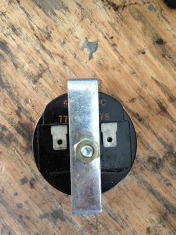

Wheelhorse84 87 #1 Posted December 24, 2012 I have a new hour meter for my c-160 but have no wiring kit and no idea how to install it. Any diagrams or advice would be appreciated. Thanks Share this post Link to post Share on other sites

Duff 206 #10 Posted December 24, 2012 (edited) If you take the mounting strap off so you can read and post the model number of the meter, there are a several on-line resources that might be able to help us with which terminal is hot. I'm guessing it's a Hobbs meter? Just a thought..... ~Duff :thumbs: Edited December 24, 2012 by Duff Share this post Link to post Share on other sites

Wheelhorse84 87 #12 Posted January 18, 2013 If I run a wire from the battery positive terminal and a ground wire the hour meter should run for me to test it ? I did and the meter did not tick. Share this post Link to post Share on other sites
Sparky-(Admin) 23,690 #13 Posted January 19, 2013 Is it a "brand new" hour meter, or a used one? Maybe its just shot? Mike............... Share this post Link to post Share on other sites
Wheelhorse84 87 #14 Posted January 19, 2013 It came with a tractor I bought a while ago but it was brand new no hours. Share this post Link to post Share on other sites

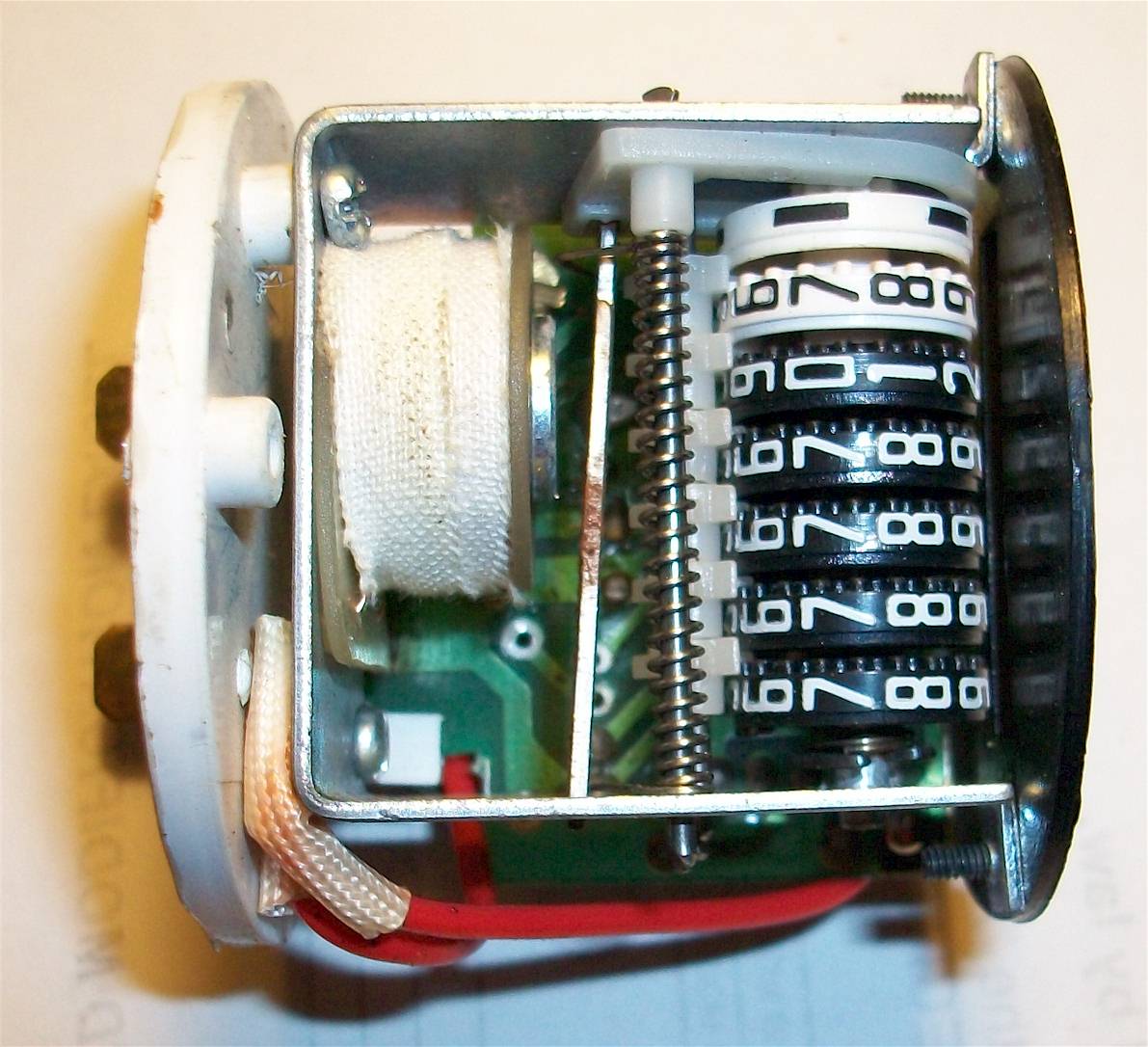

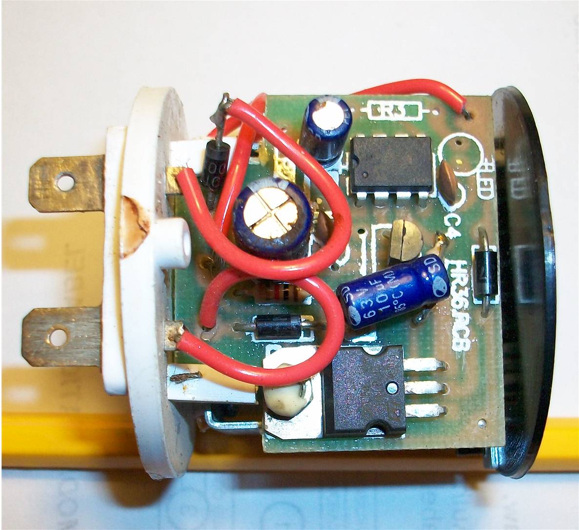

wheeledhorseman 579 #18 Posted January 20, 2013 So here's the internals of a modern electromechanical type hourmeter. It consists of a set of counter wheels, the tenths of an hour wheel is advanced by the solenoid driven by an electronic circuit. The eight pin chip isn't a 555 timer, it's a microcontroller which is a minimalistic computer on a chip. It has a tiny memory that can retain a simple computer program 'flashed' into it. It also has some memory for the program to use and an internal clock to run the computer. In this case the program will be making it count pulses from the clock with an end result that it produces an output pulse to drive the solenoid every 6 mins. Getting back to the thread - this one at least has a diode in the power line to the board that protects it from the external power leads being connected the wrong way round. The terminals are marked + and - but if incorrectly connected then it won't operate but no internal damage will be done. Andy 1 Share this post Link to post Share on other sites
