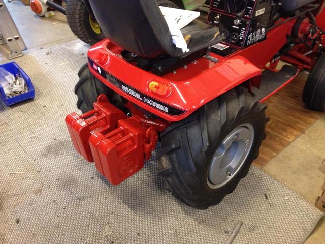

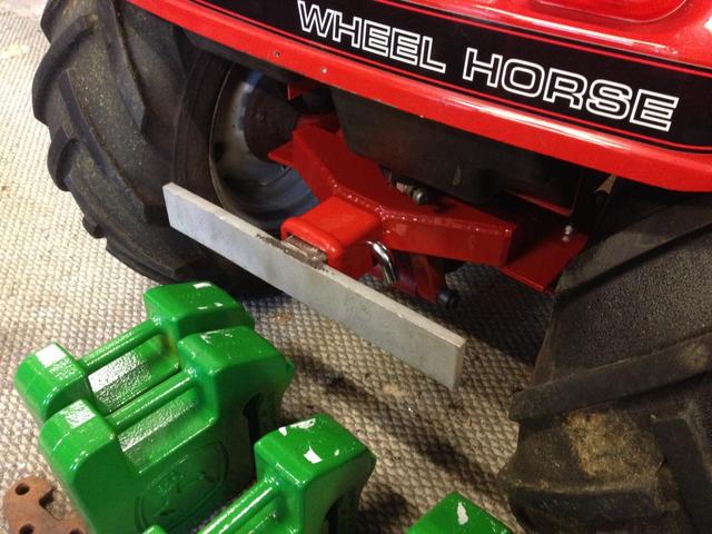

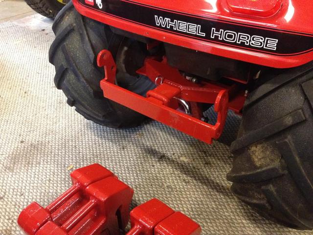

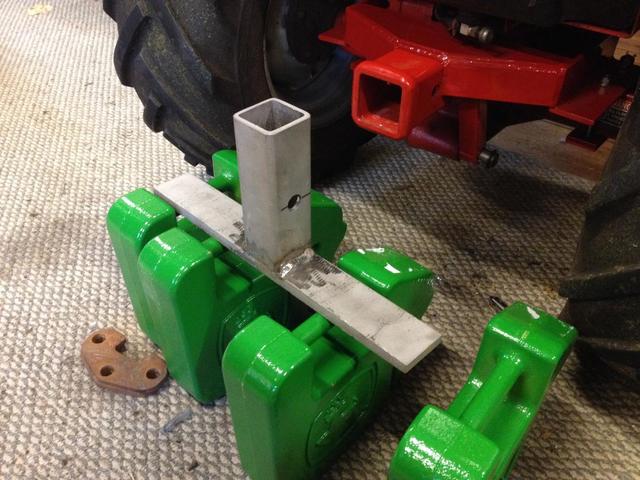

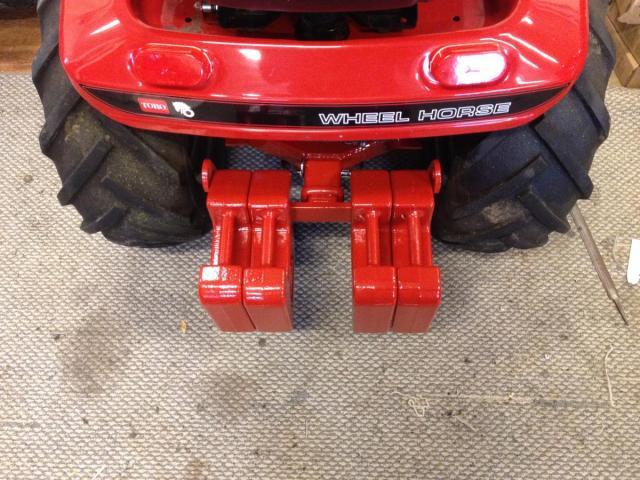

Martin 2,134 #76 Posted December 4, 2014 was entertaining the idea of buying a heavy hitch bracket for the suitcase weights, but one thing led to another and i ended up throwing together a bracket out of some scrap laying around. i did it much the same way Scott did above on his. piece of 2 " square about 7 inches long for the insert, piece of 3/8 x 2 inch flat for the weights to rest on and a couple odd brackets on the ends to stop the weights sliding off and also so i can put a piece of 1/2 round rod across the top of the weights to keep them in there position. they are probably not going to move very far as they are reasonably snug on the bracket, but if i feel the need to put a rod across the top the provision is there. i also got rid of the green paint. for the time being the john deere branding will stay there....... 5 Share this post Link to post Share on other sites

Martin 2,134 #81 Posted December 5, 2014 (edited) Paul, i don't like using chains on my driveway, so the weight is all I've got. the ags really don't grip that well and i thought about getting a set of the all trail tires i have on the other 416. as far as the weight bracket goes, i just gathered a couple pieces of steel and welded them together. as far as being my idea, i stole it from Scott Moreau, he posted above with a pic of his and the same weights. the bracket is made from the following pieces....... 2" square tube 7 inches long, need to drill a 5/8" hole for the drawbar pin to go through. 3/8" (i think so) x 2" flat bar approx 15" long. weld the 2" square to the middle of the flat. then weld a piece of plate say 1" x 4" to each end to stop the weights sliding off. i don't think you really need a bar across the top to hold the weights down. that would be handy if the tractor rolled, but if that was the case, i think i would have more important concerns to deal with than the weights coming off. they are a snug fit on the bar and some finesse is needed to pull them off without a little resistance. i don't have any more bar here, it was just a piece i had laying around and the 2" square can be had already with the hole drilled in the right position from one of the towing equipment suppliers that stock them. its the most basic of brackets i could think of doing and seeing that pic Scott posted, prompted me to go ahead and make one. i was going to spend $120 +ship to get a Heavy Hitch weight bracket that would hold 6 weights. I seen one on the back of one of John Matthews' tractors (shallowwatersailor), they are a neat bracket and i may even get one in the future. but for the time being, I'm being cheap, Chrismas is coming along quick and i have a large family!!!! Glenn, i would see if somebody close to you could whip one up for you, could probably get it done for what it would cost for me to ship you one...... heres the Heavy Hitch..... Edited December 5, 2014 by Martin 2 Share this post Link to post Share on other sites
