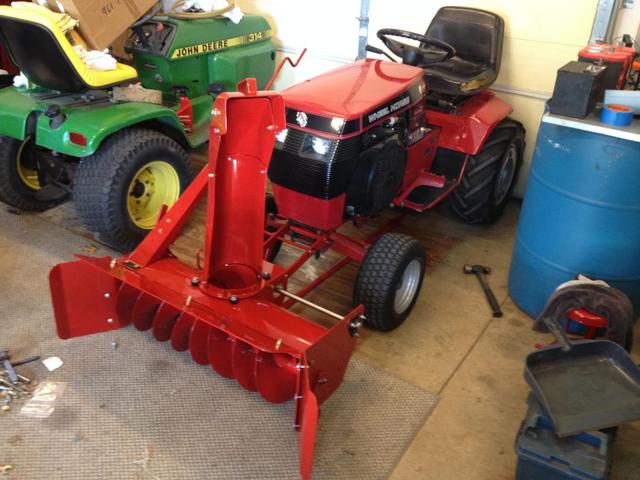

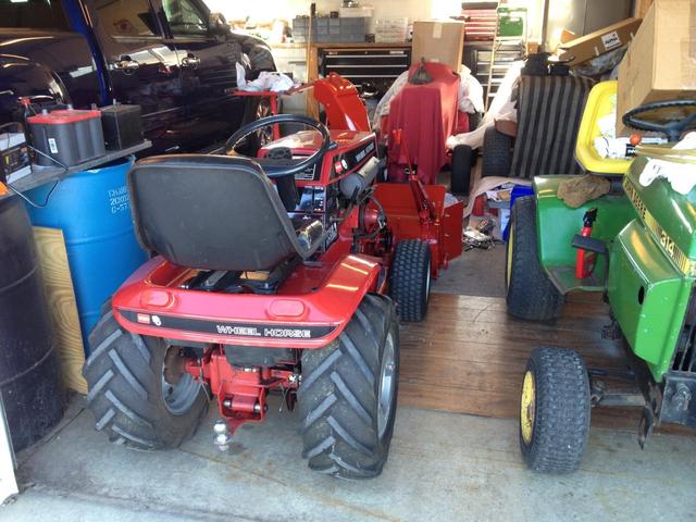

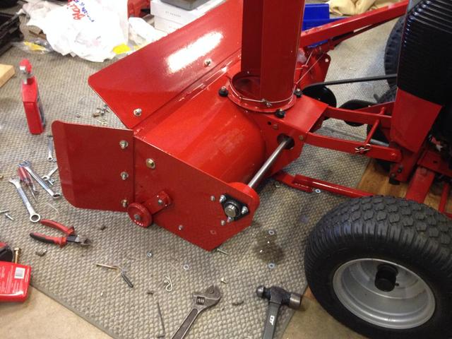

Martin 2,133 #52 Posted November 21, 2014 thanks Jack, i think that measurement was posted earlier on an xi blower thread on here. there has been a couple of you real helpful with pm's on the measurements as well and i appreciate it! got today off and all next week so should be able to spend some time getting things finished up. i needed a rest from working on the calendar this morning, so went out and hooked up the blower to the 416 just now. 2 Share this post Link to post Share on other sites

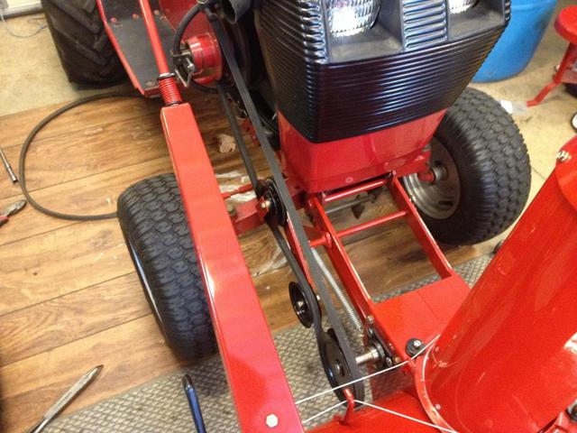

PaulC 342 #53 Posted November 21, 2014 Looking really good Martin!! Bring it up here to Buffalo and you can do more then try it out. Not sure whats up with your camera though?? there are green and yellow smudges in all 3 of those pics 1 Share this post Link to post Share on other sites

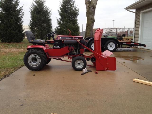

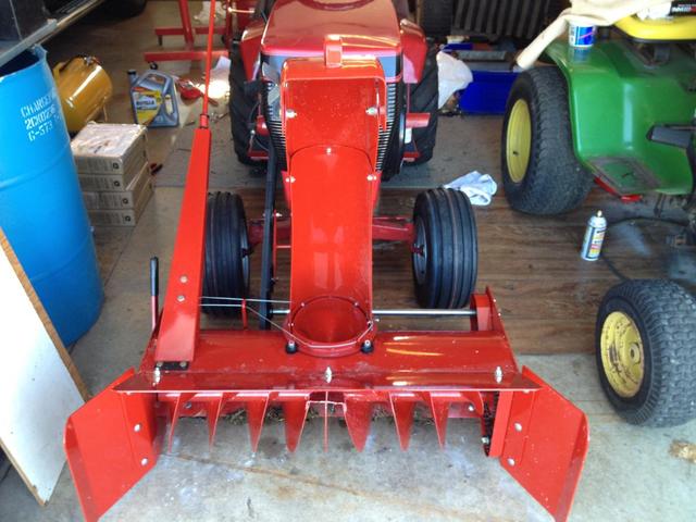

Martin 2,133 #55 Posted November 23, 2014 i can't tell you how well they work with wet snow. i know my walk behind Ariens does ok with the snow, wet or powdery, just push it in and let it work. it has never really clogged that bad it didn't clear itself. but we are talking about a two stage compared with a single. when it gets all done and the snow starts flying, i will let you know....... weather was warmer today, so i pushed the 416 out and set up the blower as much as i could. still have a few things to finish off as well as the chain, but got the chute rotating nice on the rollers, i hate them by the way, but thats what this one has and i will just deal with it. adding the plastic base that was offered would probably help, but a small amount of lithium grease in all the right areas got it rotating smooth. i will hook up the cable when i get some more time. also had an old belt, so checked out the pulley alignment and operated the belt a few times turning the drive shaft. nice, quiet, smooth... more pics for the pic junkies...... 6 Share this post Link to post Share on other sites

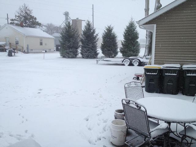

Martin 2,133 #56 Posted November 24, 2014 just looked outside, if i take the blower off the tractor and mount the blade, go out and pile it all up in a few areas, i might just be able to blow some snow once my drive belt comes in today..... they are calling for an inch, its going to have to snow a bit harder to get anywhere near that........ 1 Share this post Link to post Share on other sites

Lane Ranger 11,654 #59 Posted November 24, 2014 Don't bother pushing that snow into a pile Martin- you'll have bunch to try out your "new" snowblower on sooner than you think! Great job on this! Looks like I am going to have to find you a new taller 90"s blower for a trade! 2 Share this post Link to post Share on other sites

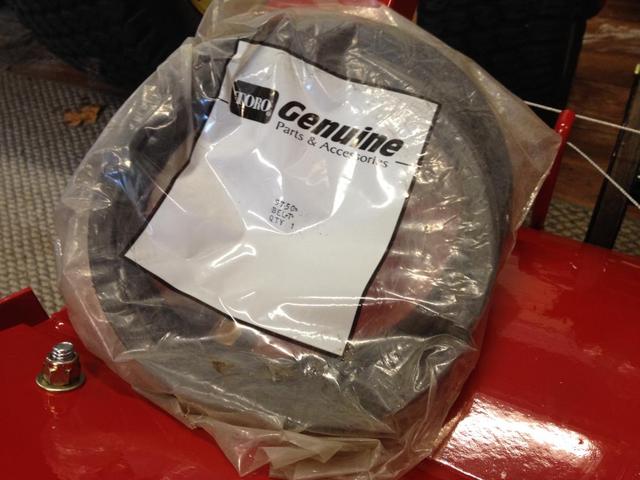

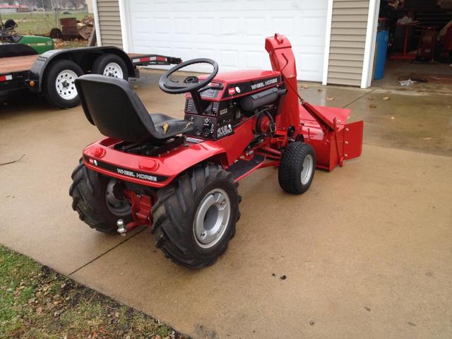

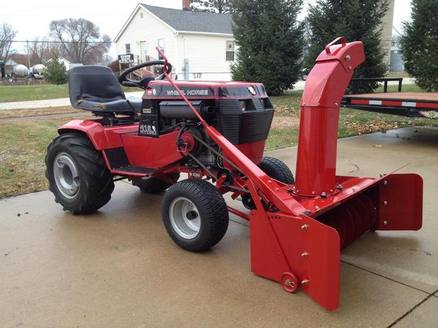

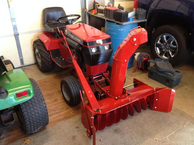

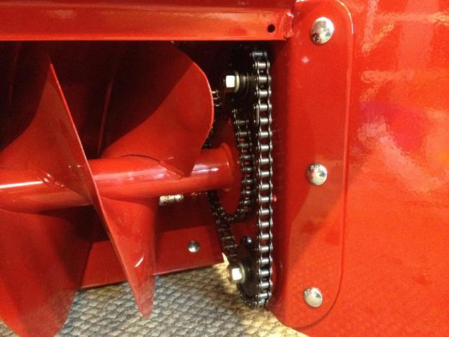

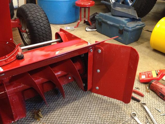

Martin 2,133 #60 Posted November 24, 2014 (edited) got the drive belt in the mail today, so went out and finished up everything on the blower. got the chain all set up, cut the length to 51 links like the original, lined up all the sprockets with shim washers and installed the chain. double checked all my bolts, installed cotter pins in all the areas i temporarily put hairpins and gave the whole blower a good spray down with quick wax. chain, idlers etc installed.... new belt fresh from ebay, this one was $20 in a sealed bag, not sure what they run at the dealer, probably more i would guess. chain guards on. all done.... came inside to get a bite to eat and after a while look out the back window to see Kent out on the back driveway with a shovel messing up all my test snow........ so i finished up my lunch and went out there, but not before putting my coat and slippers on. i thought to myself how dare he exert energy! i was wondering if he was feeling ok, working and all.......after all he is a teenager, what will he be up to next????? actually i already know the answer to that, having 4 others that have gone through those years already...... anyway, i said to him to stop that working thing immediately, he might break out in a sweat and I'm sure he didn't want that to happen. i did manage to get him to hold my phone for a few minutes while i tested out the blower on what was left on the driveway (which wasn't very much-darn kids......) Edited November 24, 2014 by Martin 7 Share this post Link to post Share on other sites

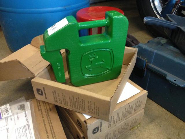

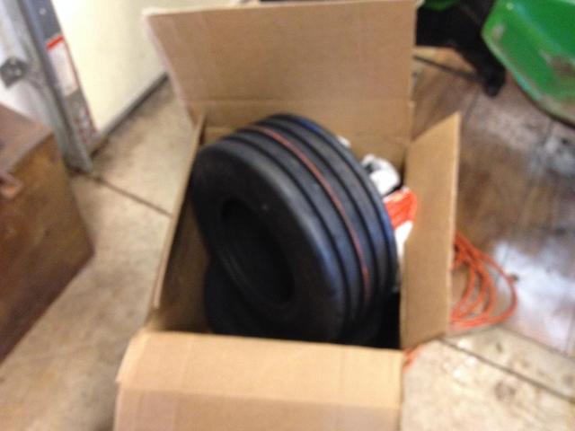

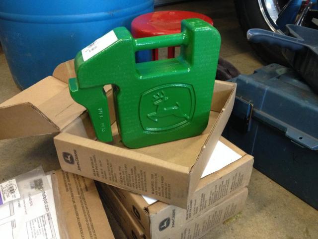

Martin 2,133 #66 Posted November 26, 2014 (edited) got some parts delivered today to help out with the snowplowing duties..... now i got more work to do, making a weight rack for the rear and mounting some tires on the front to get rid of those horrible in the snow oem turfs. oh, and some painting to cover up that green.... home depot had the best deal on the weights, free 3 day ship as well. bought 4 of them. the tires are the same v61 vredesteins i put on the 416-8..... Edited November 26, 2014 by Martin 2 Share this post Link to post Share on other sites
Geno 1,930 #67 Posted November 26, 2014 Noooooooooooo not the green ones! 2 Share this post Link to post Share on other sites
PaulC 342 #68 Posted November 26, 2014 Gonna need ALOT of red paint to cover up that nice buck on the side of those weights!! I plan to add some weight to the rear of mine as well never had any just chains curious to see the difference. I was also thinking about tri ribs for the front. I love the look and read about them being better in the snow. I don't have many issues with the turfs though? Are the tri ribs really that much better? 1 Share this post Link to post Share on other sites
Martin 2,133 #69 Posted November 27, 2014 my front turfs on this 416 are the oem dico turfs. i have plowed with this tractor for a couple seasons and hated the way they slide around on the snow. I've heard the 5 ribs are great in the snow, never tried them as yet even though this is the second set i have purchased. never tried tri ribs either, but others on here say they work well. in my opinion the 5 ribs look better on the wider wheels, but thats just how i feel about them. 1 Share this post Link to post Share on other sites

smoreau 658 #71 Posted November 27, 2014 (edited) got some parts delivered today to help out with the snowplowing duties..... now i got more work to do, making a weight rack for the rear and mounting some tires on the front to get rid of those horrible in the snow oem turfs. oh, and some painting to cover up that green.... IMG_4022.JPG home depot had the best deal on the weights, free 3 day ship as well. bought 4 of them. the tires are the same v61 vredesteins i put on the 416-8..... I picked up 4 of these also this year. Next spring they will get a little filler and paint for sure. Cant beat the Home Depot price and free shipping Edited November 27, 2014 by smoreau 2 Share this post Link to post Share on other sites
Digger 66 3,488 #72 Posted November 27, 2014 Better get the die-grinder for the venison . 1 Share this post Link to post Share on other sites
Martin 2,133 #73 Posted November 27, 2014 I picked up 4 of these also this year. Next spring they will get a little filler and paint for sure. Cant beat the Home Depot price and free shipping looks like you used a piece of wide flat about 1/2 to 3/4 thick which was welded to a 2 inch drawbar insert to carry the weights? i was thinking of something similar, but up higher. how much ground clearance do you have Scott? i have yet to swap the drawbar (one of the ones that you were making) from the c125 over to the 416 and try things out. i am wanting to have them up high in the rear with only just enough clearance to remove them without disturbing the seat pan. 1 Share this post Link to post Share on other sites
