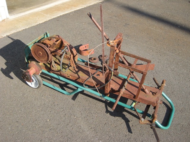

What I started out with was a ruff condition 1955 Cable Steer RJ35. It was missing the hood, engine, seat, original front rims and most of the cable steer parts. It did although have the veri drive, belt guard and rear drive intact.

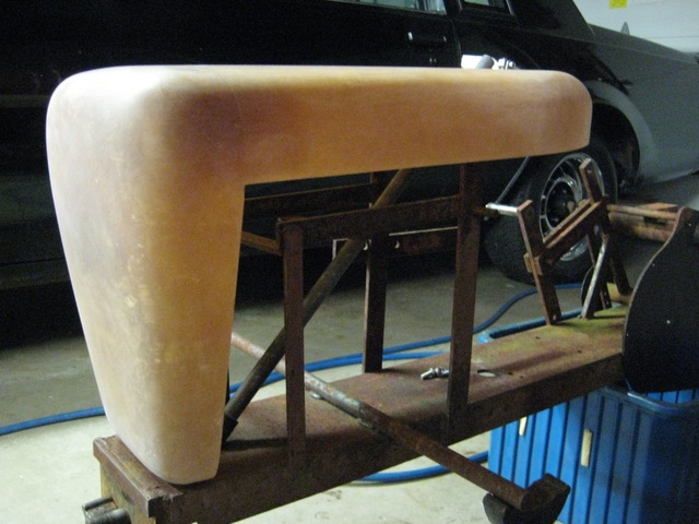

Some of the parts which I had to make in order to clone the Prototype correctly was the fiberglass RJ hood, pilot steering wheel, most, if not all of cable steer parts and speed selector items.

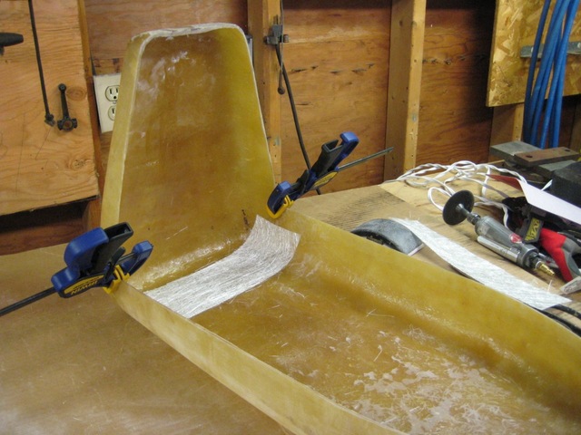

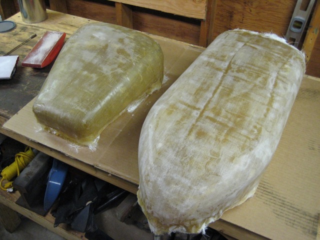

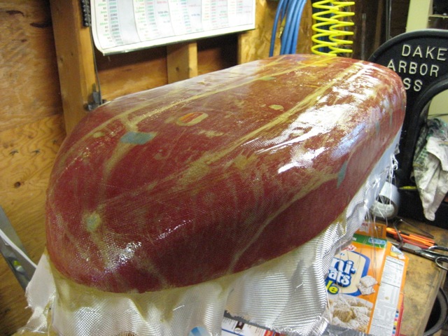

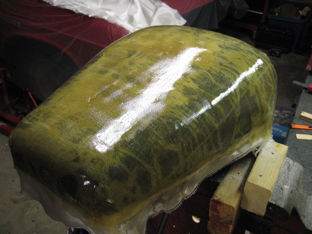

Posted below is a pic of what I started with and the biuld of the fiberglass RJ hood.

As you can see from the attached pics I used a RJ hood as the buck for the fiberglass hood. I made the top and nose in two parts and them married them together. What a mess it made.

I told Vin he should reproduce these hoods and sell them to fund his Tractor hobby. I know i'd pay in excess of $300 for one in just the ruff finish and do the rest myself!
wallfish
We had the chance to see Vin's fiberglass hood in person at one of the engine shows. That thing came out amazing!
Looking forward to seeing the entire tractor completed
