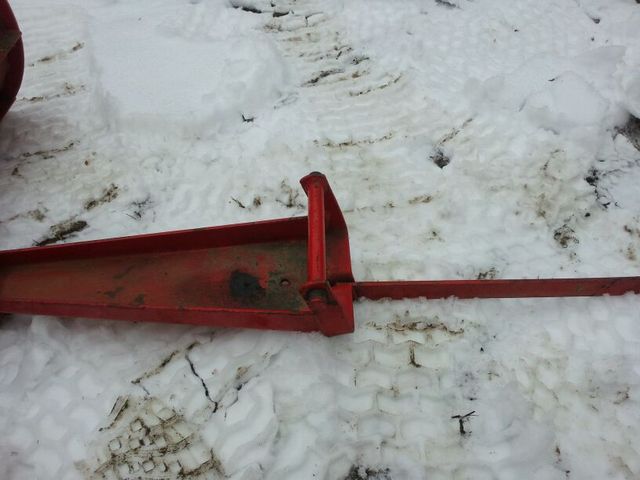

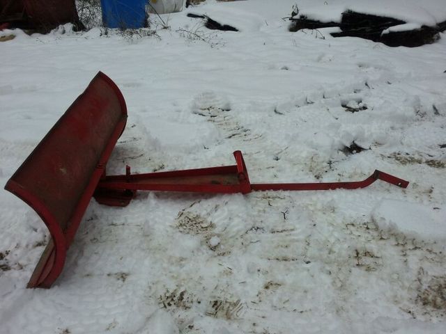

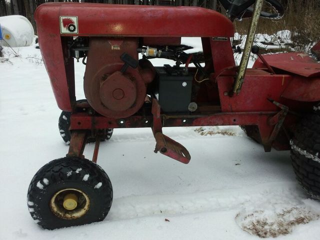

roscoemi 245 #1 Posted December 15, 2012 I bought a 1967 Lawn Ranger for my son for Christmas and need some help hooking up the snow plow. I could find no numbers on the plow, but assume there is a bracket to bolt the pivot point to the frame. I'm thinking it should bolt up in the area under the motor where holes are located and the front deck swing arms mount. I'm going to look at the attachments forum to see what I can find, and contact Kelly to see if he has any ideas. If anyone has pics or one they are willing to part with please let me know, as I would really like the plow on when my son finds his special present from Santa. Russ Share this post Link to post Share on other sites
roscoemi 245 #2 Posted December 15, 2012 After searching, I believe the plow is part #6-3111 (supercedes bdr-385). The bracket part number is 4123 and the wear bar number is 5863. Share this post Link to post Share on other sites

KC9KAS 4,744 #4 Posted December 15, 2012 You need a front Attach-A-Matic Share this post Link to post Share on other sites
roscoemi 245 #5 Posted December 15, 2012 Thanks guys, I really appreciate the info. the link has great pics and I can fab them to the print, but will not get them done in time for Christmas.Just another chance to work with Porkchop and teach him some fab skills. He will be excited to get his own 'Horse, but to work on it to get it plowing snow may send him into parts unknown! Thanks again guys! :thanks: Share this post Link to post Share on other sites

roscoemi 245 #15 Posted December 18, 2012 Thanks Kelly, was going to pm you to see if you got them shipped. Thanks also to the others who took the time to help me out! Some good info there. Do you suppose that a speed hitch could be modified or one fabbed to work with a 1/4" spacer on each side to make enough clearance? Is the pivot bar the same diameter to work in the speed hitch? Share this post Link to post Share on other sites

TT-(Moderator) 1,162 #17 Posted December 18, 2012 Do you suppose that a speed hitch could be modified or one fabbed to work with a 1/4" spacer on each side to make enough clearance? Is the pivot bar the same diameter to work in the speed hitch? You'd have to widen the latch assembly enough to clear the blade mount and shim the side plates away from the tractor frame to match. The mounting rod is 3/4" and will fit in the speed hitch slots. Share this post Link to post Share on other sites

Kelly 1,033 #21 Posted December 19, 2012 I'm not sure the stubs of the shaft on the plow, will extend all the way through the latch and the hitch on the speed hitch, can you tell me how much shaft you have sticking out? and I can see if it might work. Share this post Link to post Share on other sites
roscoemi 245 #22 Posted December 19, 2012 I'll try to get some dims tommorrow but, we're lookin at a foot of snow starting in the afternoon so it might not happen. I guess there is about 3/4" on each side which can be modified. I would just like to make an easier/faster way to mount the plow as he will run the wheels off this tractor when he gets his little paws on it. If i can get a speed mount along with a regular set of brackets, I can figure something out and post the results. Share this post Link to post Share on other sites
