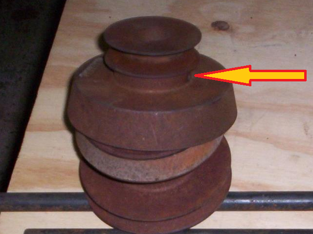

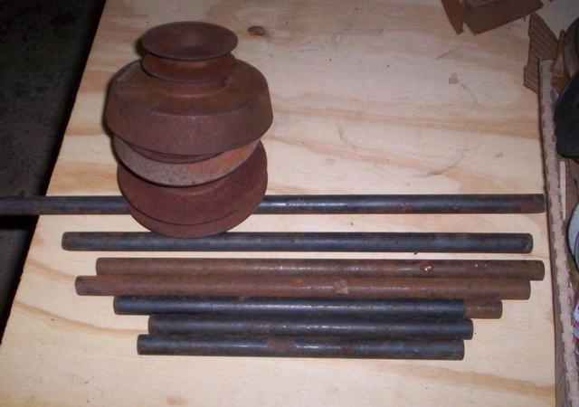

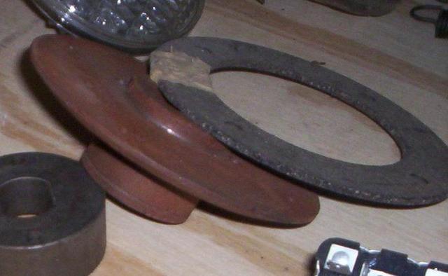

groundhog47 448 #1 Posted December 15, 2012 The first clutch, no pulley on back side has the new friction material unriveted, four equal spaced wholes around ring, the second cluth and hub are probably a vertical assembly, any help IDyng appreciated, plan entering on class ified if identifiable, thanks for any help. Share this post Link to post Share on other sites
Jim_M 179 #2 Posted December 15, 2012 The cone shaped ones are from a vertical shaft tractor , such as an LT1642. What's the diameter on the other one? Share this post Link to post Share on other sites
TT-(Moderator) 1,185 #3 Posted December 15, 2012 (edited) The first one should be D series. (18 Automatic / 160 / 180) The second one is for the B series lawn tractors like a B-82/112/115, etc. Scratch that...... I'm going to go with rear engined riders on the second one. Edited December 15, 2012 by TT Share this post Link to post Share on other sites
Jim_M 179 #4 Posted December 15, 2012 I was thinking D series on the first one too, but can't say without knowing the diameter. I'm sticking with LT series tractors on the second one. Share this post Link to post Share on other sites

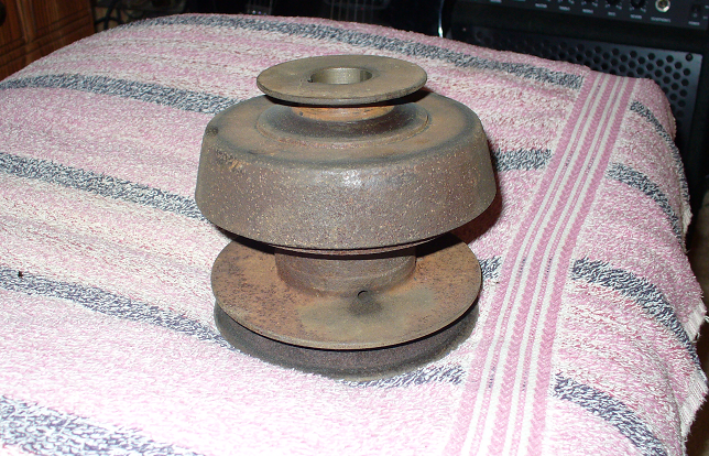

TT-(Moderator) 1,185 #5 Posted December 15, 2012 The space between the drive pulley and the clutch drum is the difference: The LT / B lawn tractor part does not have that gap: Share this post Link to post Share on other sites
Jim_M 179 #6 Posted December 15, 2012 Aha...Good catch! Share this post Link to post Share on other sites
groundhog47 448 #7 Posted December 15, 2012 The first one should be D series. (18 Automatic / 160 / 180) The second one is for the B series lawn tractors like a B-82/112/115, etc. Scratch that...... I'm going to go with rear engined riders on the second one. That was my guess on second clutch also, Thanks so much The space between the drive pulley and the clutch drum is the difference: The LT / B lawn tractor part does not have that gap: A ha I see, Thank you a bunch :bow-blue: Share this post Link to post Share on other sites
