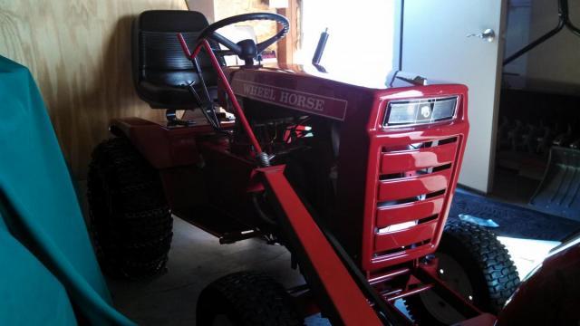

B-100 flutters at higher rpm's
608KEB
In late summer, I put a new spark plug, fuel filter, air cleaner on. I just put a carburetor kit in today.Hoping to solve problem, motor misses or flutters a little a higher r.p.m.'s. Looking for suggestions.

What's it do with a load on it?
I have a few that act a bit strange until they're actually working.
608KEB
I was thinking maybe it needed a little more fuel. I have not adjusted the carburetor. I guess I can wait until it snows and see how it does under load with the new carb kit.
midnight rambler
open the jet a 1/8-1/4 turn it should clear up
Wheel-N-It
Or it could take a half turn or slightly more. Don't use BP gasoline, its too dirty for carbs. Use Exxon or Shell 89 octane.
