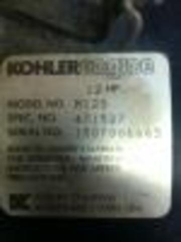

smoreau
Here is the spec # for the magnum

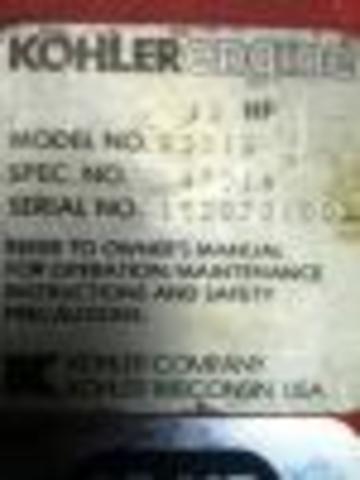

And the crank I compared it to was this
The only difference I saw was the way the flywheel was held on. M12 has a bolt and the K301 is a nut. But will it work in a k301 without a issue?

TT
They will interchange - providing the PTO end is correct for your application.
Many of the last K cranks also had the flywheel retaining bolt/washer.

rmaynard
I'm trying to find a definitive answer, but the K301-47814 shows up in the Kohler parts list as a Gravely. The replacement crank is 47 142 25-S.
The M12-471527 shows as a Wheel Horse, and the part number is 45 142 21-S.
I don't know what the difference is, but I have the Kohler crankshaft manual on my other computer and I will look it up.
smoreau
Interesting as that was on a WH. Some one must have changed the sheet metal, and or the engine at some point
So it should work as it was off of a WH
