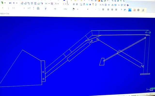

Ivegotahorse 4 #1 Posted December 9, 2012 Alright guy.....i know this topic has come up millions of times but i need some help building a loader for my 417-8. i have a basic idea/design but i need some input on what to do and what to change. i was planning on using 2x3x3/16 box tubing for th arms and uprights, 1/4 plate for the bucket and anywear i reinforce joints??? next i am stumped on the supports from the uprights to the front of the tractor...... what size tubing would u use and where to attach it??? the front attachamatic is what i was thinking.for the sub frame what sze tubing would u use? also should i bolt it to the frame or use the mid mount attachamatic or both? lastly i have the rear tiller bractet on my machine and i dont want to take it off everytime i have the loader on. Can i us that for my back mount instead of mounting it to the rear axle? thanks for any and all input Share this post Link to post Share on other sites

baerpath 517 #3 Posted December 9, 2012 Normall they attach to the front quick attach for the uprights like your diagram, The sub frame mounts in the center quick attach and around the rear axle. You can leave the tiller hookup on too. Share this post Link to post Share on other sites

wallfish 18,822 #5 Posted December 9, 2012 The factory design for the supports to the uprights uses a bracket that is bolted to the front frame of the tractor and doesn't use the tach a matic. It has tabs welded on at an angle so when the tubes are bolted on, they line up to connect to the angled tabs on the uprights. Keeping the tubes straight will keep the strength in them. 1/2" black plumbing pipe is about the size of the original support tubes so you could easily use that material to make them. You really don't need to build the ENTIRE bucket out of 1/4" since that will make it kind of heavy which means the less you can lift and more counter weight needed even when it's empty. Share this post Link to post Share on other sites

wallfish 18,822 #8 Posted December 10, 2012 Here's a link to download a FEL file which should help with some guide lines for building one. You can certainly build it with 1/4" material which will make it bullet proof but the trade off is the weight of it. Share this post Link to post Share on other sites
sorekiwi 761 #9 Posted December 10, 2012 I would think 1/8" would be plenty thick enough to build the bucket out of. The little tractors struggle to get enough weight on the back to counterbalance the front as it is. Share this post Link to post Share on other sites

SousaKerry 503 #11 Posted December 13, 2012 1/8" plate is actually 10 gauge (.135") just for clarification when you call the steel supplier.. And I would build the bucket from 10ga steel and reinforce the edges with 1/4 strip to save on weight. Share this post Link to post Share on other sites
