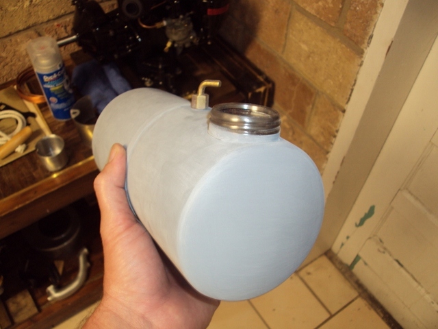

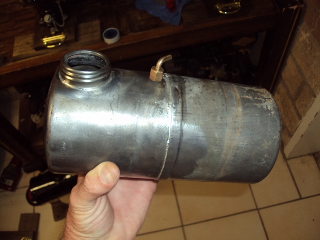

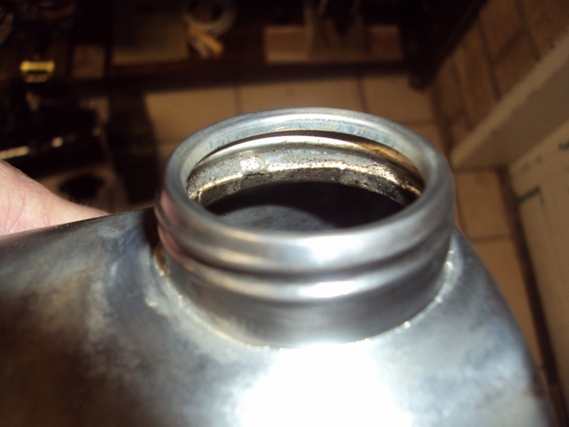

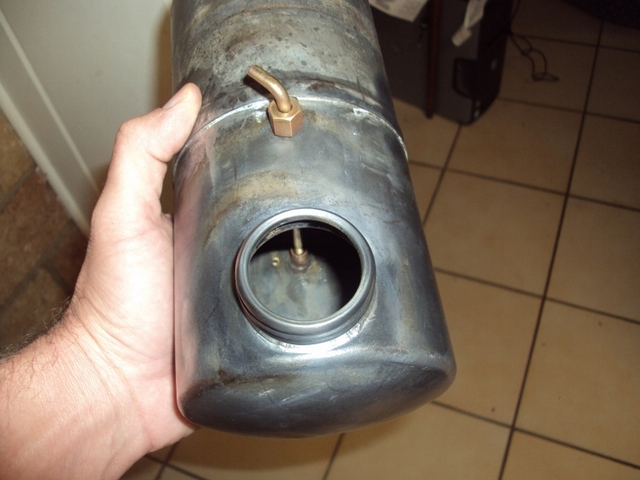

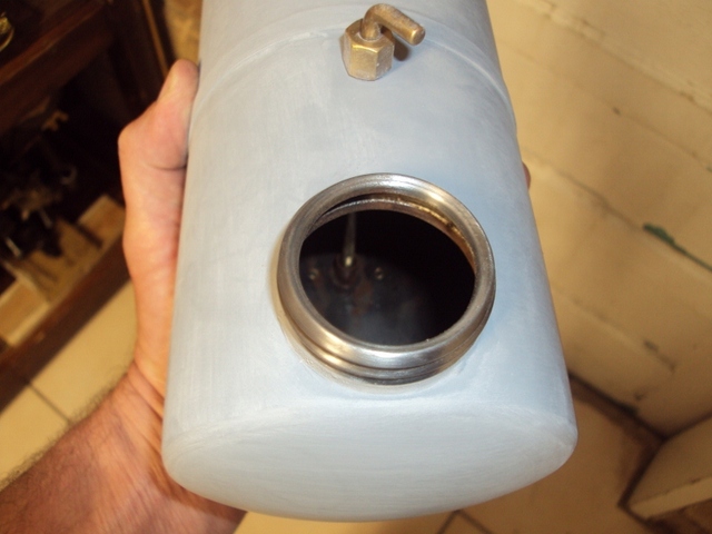

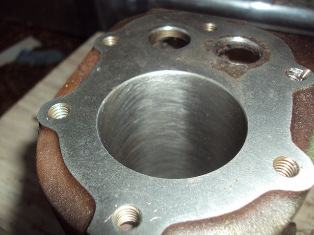

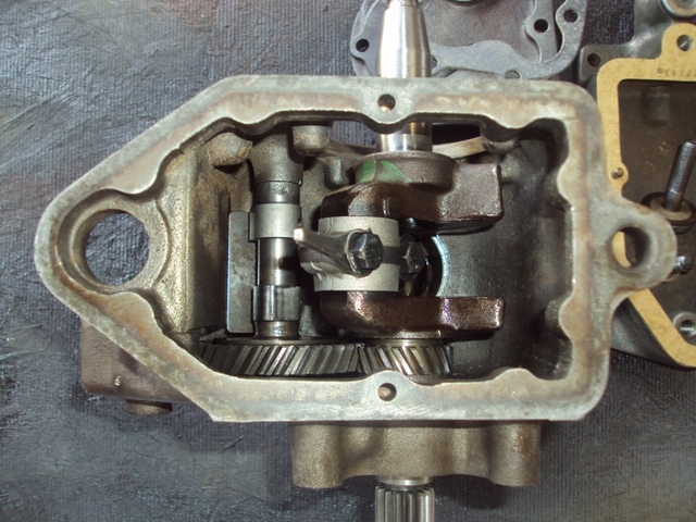

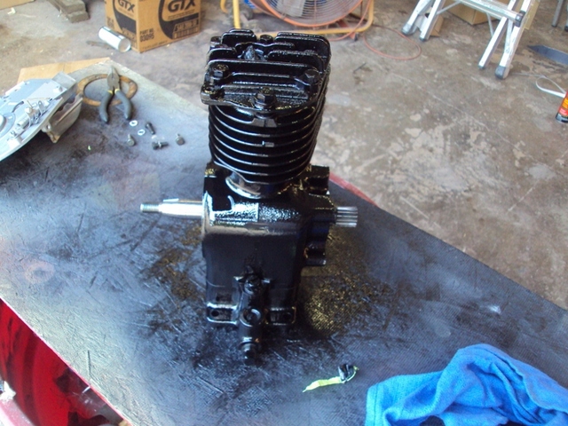

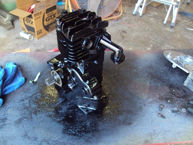

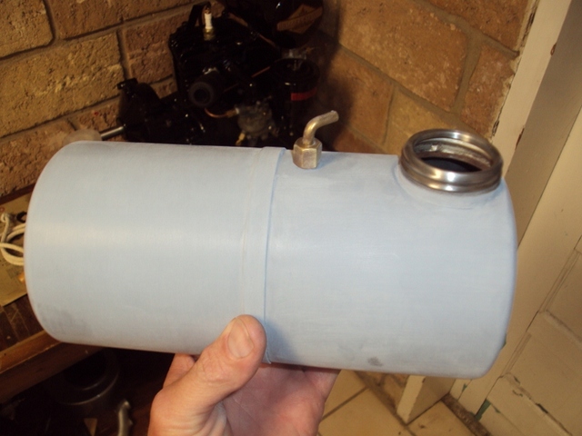

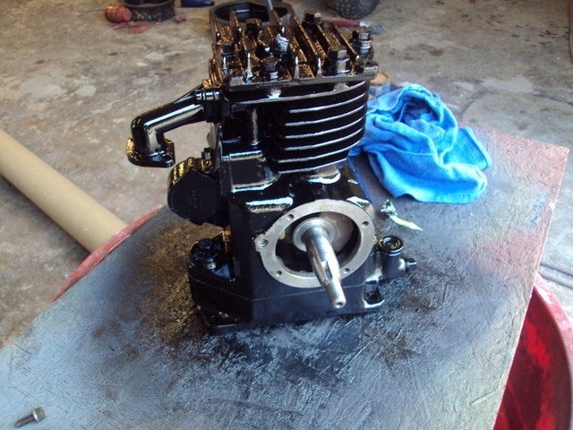

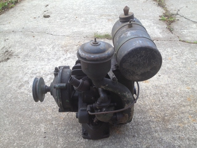

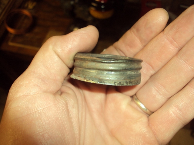

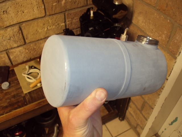

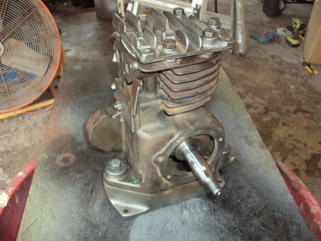

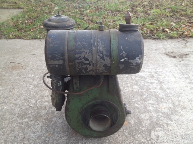

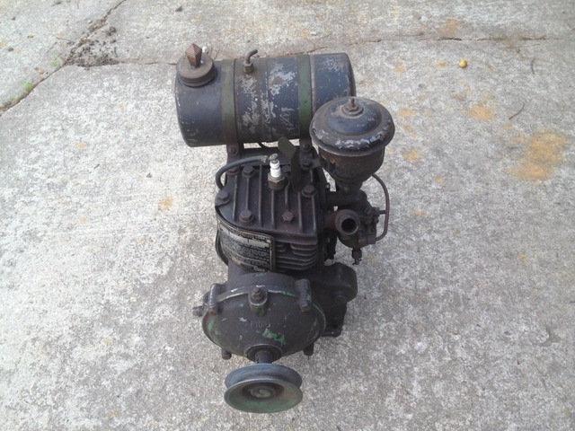

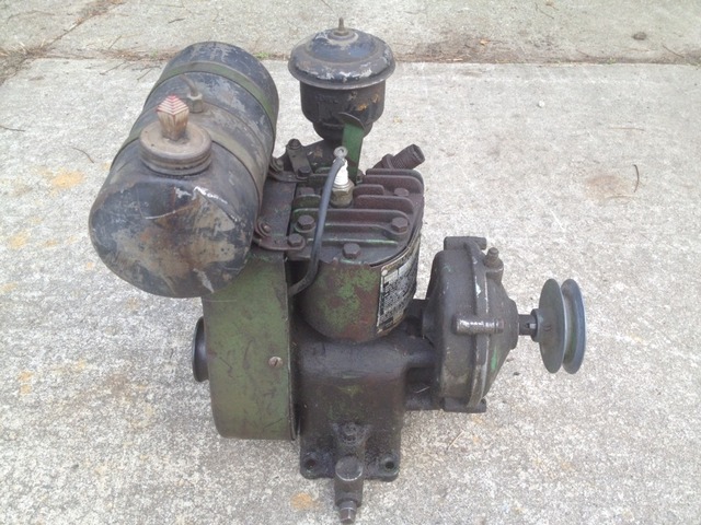

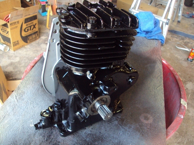

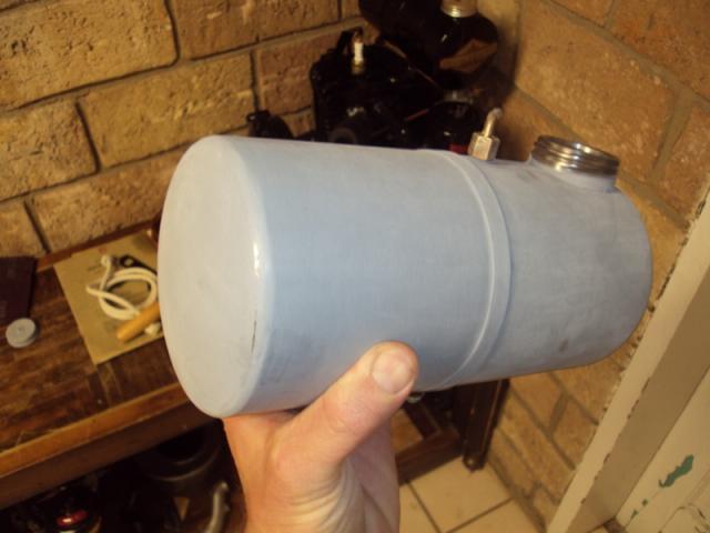

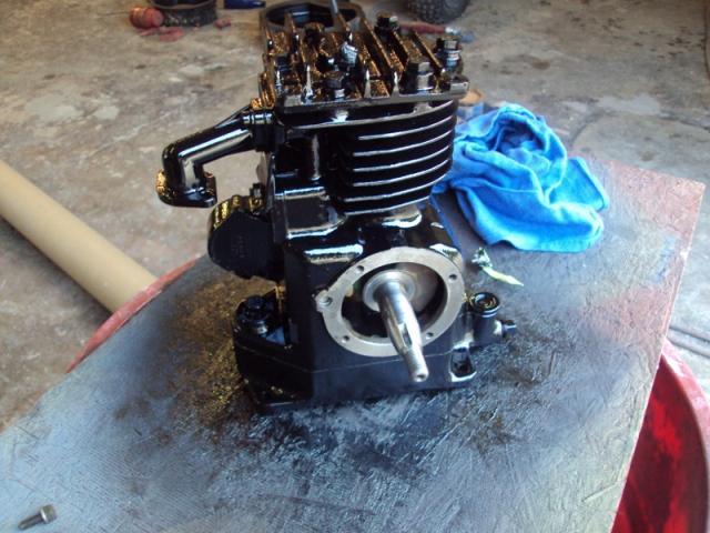

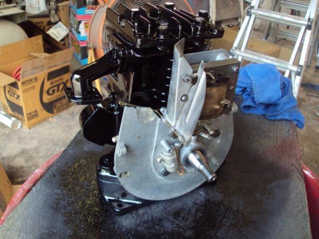

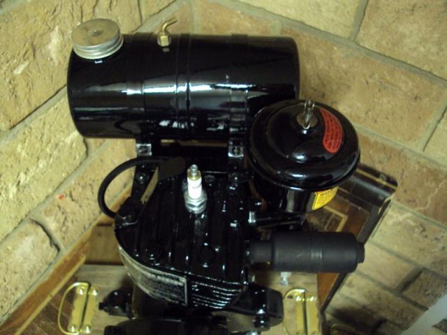

bowtiebutler956 650 #1 Posted December 9, 2012 I still haven't got another to fix up yet, but I have picked up a few more antique Briggs engines. It seems like they're multipling like rabbits every time I turn my back! This one is from a Bolens Power Ho. I bought this one because its gas tank has a thu rod fuel shut off, which none of my other Briggs engines have. It also has the the long S bend pipe going to the air filter. Upon opening it up, I found it had alot of rust pitting on the deck of the block, paticularly around the exhaust valve, including some on the head gasket sealing surface. Strangley enough, the cylinder was beautiful with no rust at all, or ridge. I gave the cylinder a quick hone to break the glaze in the cylinder. I took it to the machine shop to have it decked, and the exhaust seat cut. There is still some pitting on the deck, as I told them only to remove enough to give me a cleand head gasket sealing surface. The gas tank was pretty rough too. I had to open it up, so I could remove the dents, and rust. I had to replace the threads for the gas cap as well. I then resoldered it back together, and primed it. I now have the long block assembled, and painted. I know its not , but its what I've been up to lately. Matt 4 Share this post Link to post Share on other sites

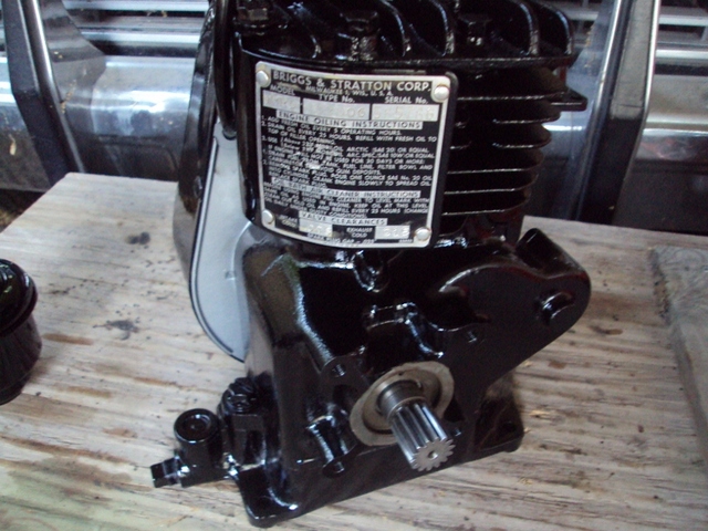

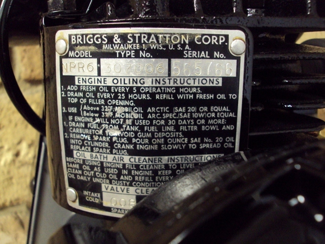

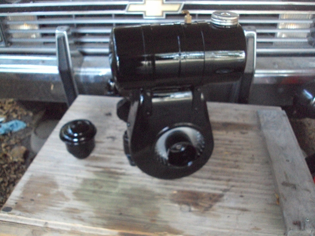

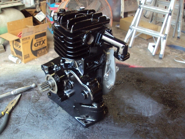

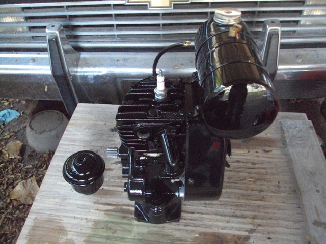

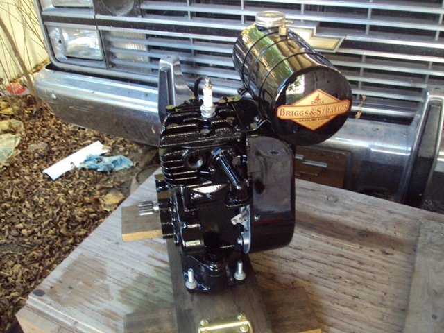

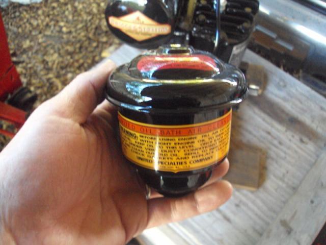

bowtiebutler956 650 #14 Posted December 11, 2012 I got the rest of the engine painted yesterday, and the paint turned out great, all except the gear reduction box, which had a bunch of fish eyes in it. I guess I didn't clean it well enough. Oh well, I'll strip it, and repaint. Here are a couple pics. One of the pics is a little blurry, but I'll post some better ones soon. Matt :flags-texas: Share this post Link to post Share on other sites

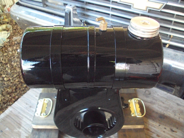

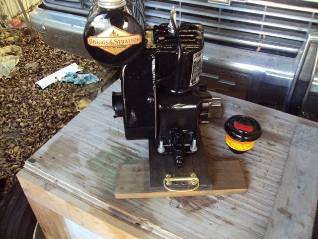

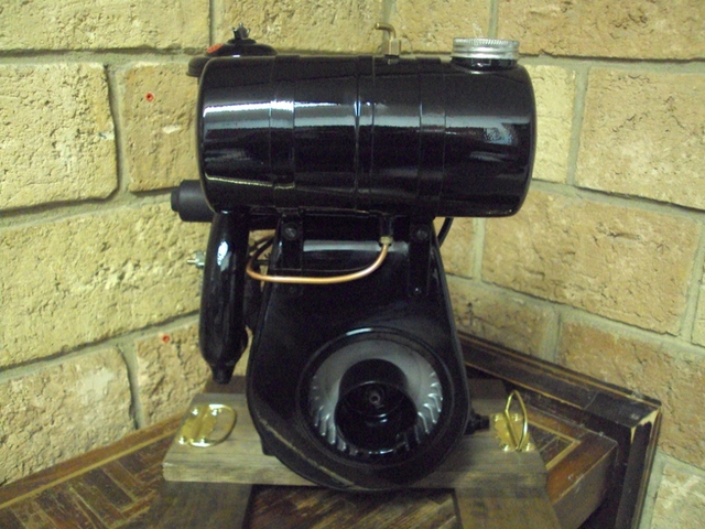

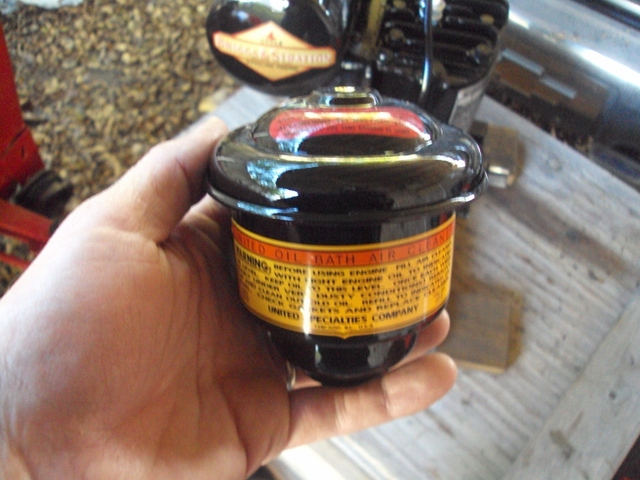

bowtiebutler956 650 #16 Posted December 13, 2012 I've been busy the last couple days, so I haven't done much with the little Briggs. However, I did get the decals in the mail, and I had to put them on! I love putting new decals on restored old iron, as it really makes them stand out. Here are a couple pics. Matt :flags-texas: 1 Share this post Link to post Share on other sites
Lars 526 #17 Posted December 13, 2012 Wow it looks awesome Matt.. you sure do great job on those engines.. Lars 1 Share this post Link to post Share on other sites

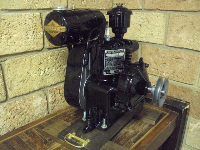

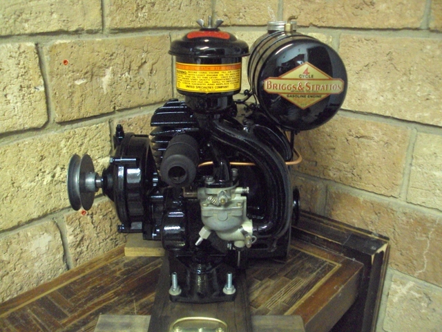

bowtiebutler956 650 #18 Posted December 16, 2012 Well I finally got it finished! As soon as I get a chance I'll take a video of it running, and post it. Here are a couple pics. Matt :flags-texas: Share this post Link to post Share on other sites
