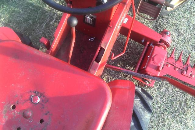

wp205a 43 #14 Posted January 21, 2013 There have been several days since August when I'd just as soon not received this 854 as a gift from one of my coworkers. Today is not one of them. Steering much better, no leaks (yet) at the tank, Decided to check my drive belt, looks like it's just about had it. Will look for pitch & length here later. Anybody have a guess as to why this cutout, and another one on the bottom of the belt cover, might have been done? Share this post Link to post Share on other sites
glgrumpy 35 #15 Posted January 21, 2013 Belts run pretty close to cover in some spots. Maybe if it has too fat a belt and rides up on pulleys, it HIT some of the tin. PO just cut out spots to clear it. OR..... Cover is from an auto and had the park brake lever up thru it? (doesn't explain the lower cut). On this steering pull......Why doesn't someone make a fat based puller for them. Big circle, maybe 1" slot to pass over shaft and still set on some metal in the wheels to pull on? I've ripped off wheels and left behind the metals, wrecking all of it. I've also been afraid of mashing the end of a hollow shaft on my Power Kings, even with nut back on a little. I didn't wholly understand the open end wrench part. How'ld you connect that to puller? Only one end of wrench would stick out to grab! That is idea of the part I mention above, but bigge and would just use a standard puller big enough to reach accross wheel center. Could drill holes in plate and thread, or just use bolts and nuts on back to pull against. This could be left on under pressure and oil away and wait for days, maybe tighten a little more each day if it seems to move at all. I suppose tractors with trim and tubes in way would be harder to get puller close enough to shafts and metal part of wheels. How about one of those split bearing pullers with tapered center and flat other side? Might squeeze into tight areas with that, then use reg puller on it. Pullers I'm thinking of are not the ones with three arms and bent end, but the channel like ones that have bolts slipped down thru them. OR, harmonic balancer type. 1 Share this post Link to post Share on other sites
