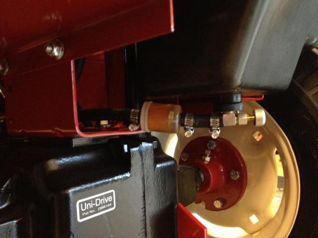

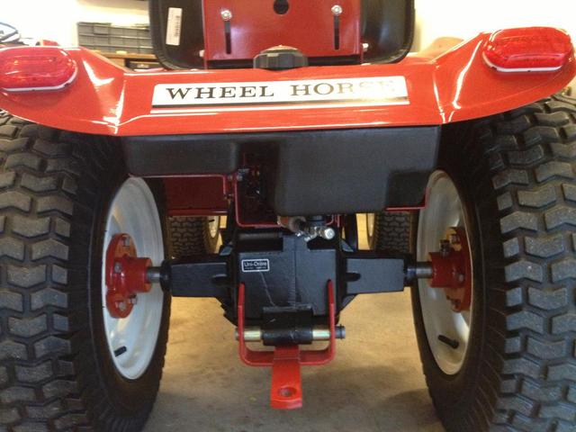

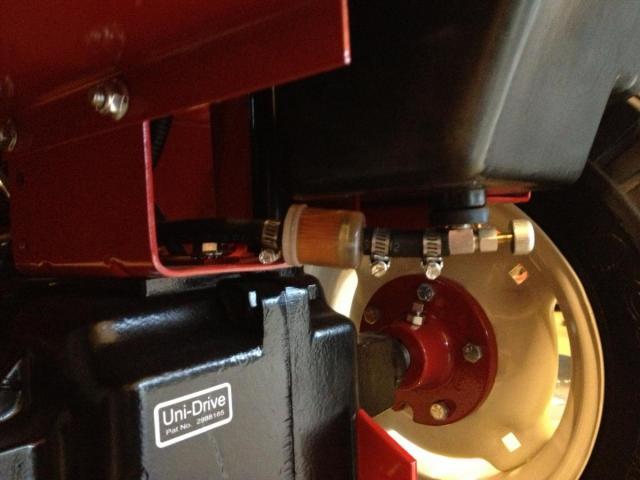

Martin 2,133 #16 Posted December 10, 2012 just went and had a look at the c125 again and the tank shape right below the filler is deep, but just to the left and forward of that area theres the raised up part of the tank where its nowhere as deep. that corner is real close to where the sender would sit, and i was just wondering if the wire carrier for the float was slightly bent it would hit and bind up in that corner. i cant see where the screen for the shut off valve would interfere with anything as its a reasonable distance from where the sender would be. ( unless theres a bend screen in the tank, but those screen socks arent any longer than an inch or so and i think you have more than that to the sender)....maybe it has a nonstandard screen in it, but you did say that you have another one with the same situation.....and thats why im leaning towards slightly bent sender. 1 Share this post Link to post Share on other sites
Butch 194 #17 Posted December 10, 2012 Martin I'll have to wait until the fuel level goes down to see what's up. And that won't take long at all for this fuel hog. Looking at your main shutoff it looks to the right of the filler hole and I believe mine was to the left of the hole. Your machine sure is clean lookin also!! Share this post Link to post Share on other sites
Martin 2,133 #18 Posted December 10, 2012 yeah, i tried getting it dirty, but the tractor says it spent a bunch of time in its past life looking like a real pig and its not ready to get dirty yet.......... Share this post Link to post Share on other sites
