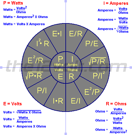

KATO 115 #14 Posted December 2, 2012 Watts divided by Volts = amps Example :standard 1156 bulb is about 27 watts. / 12 volts =2.25 amps Share this post Link to post Share on other sites
smoreau 658 #15 Posted December 2, 2012 (edited) Watts divided by Volts = amps Example :standard 1156 bulb is about 27 watts. / 12 volts =2.25 amps Remember that when the engine is running it is not 12 volts, its 14 volts = 1.93 amps. The tractor that it's going in has larger head lights and 2 tail lights. 86 312-8 to be exact. Edited December 2, 2012 by smoreau Share this post Link to post Share on other sites
