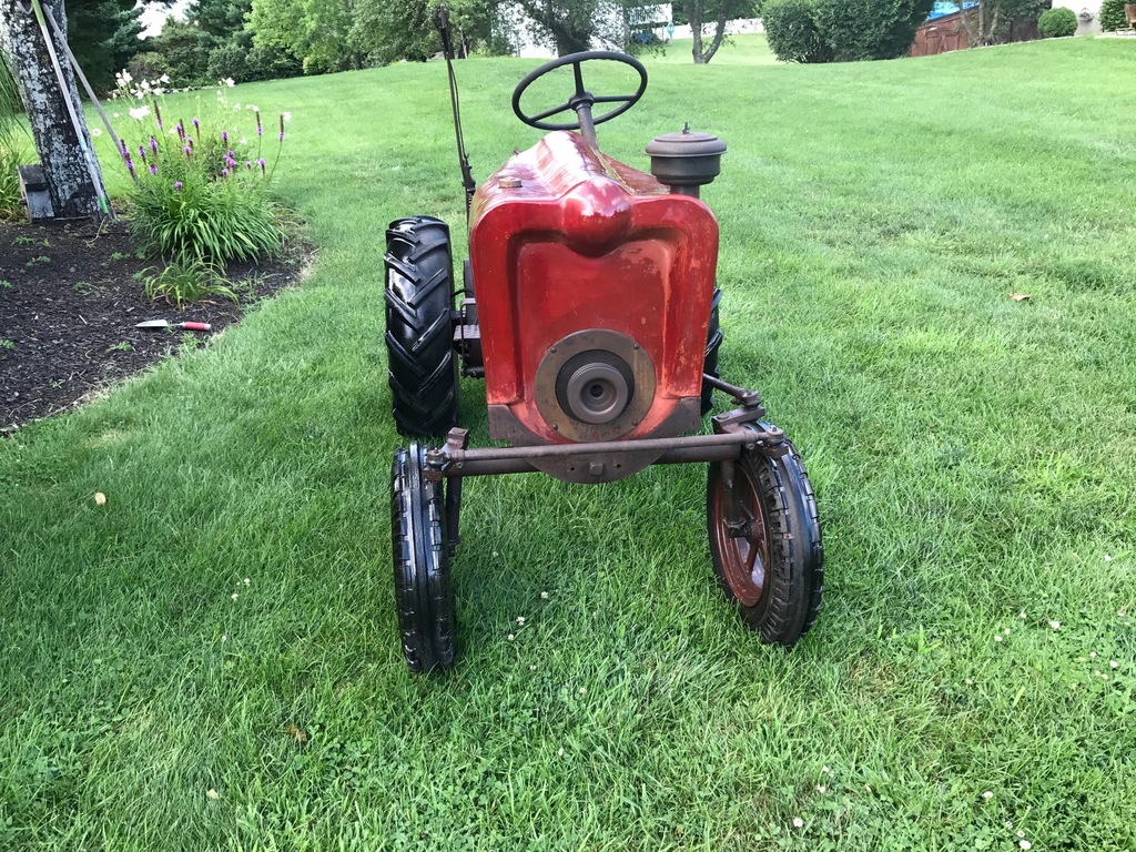

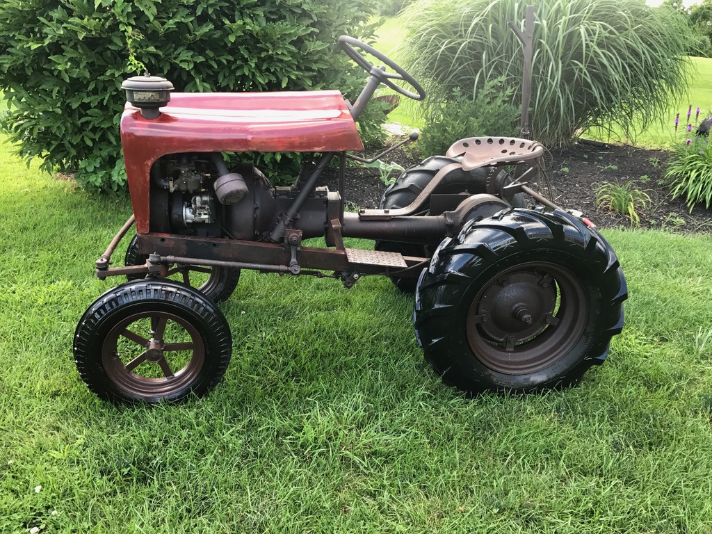

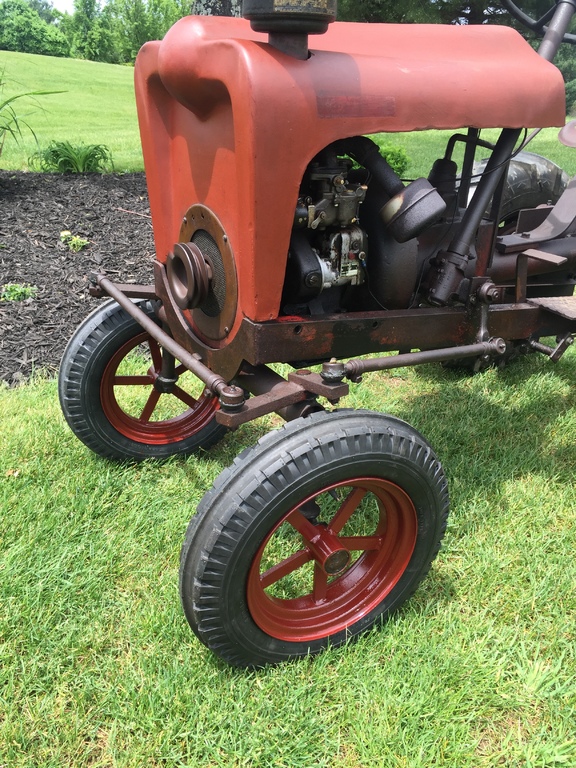

stevebo-(Moderator) 8,742 #76 Posted December 3, 2012 Guys- If you remember a few years ago my next door neighbor took some really nice photos of the RJ35's. I usually do not ask him to take pics of my tractors however I asked if he would take some of the SR. Last night she got a mystery oil bath and today she was gently scrubbed using the oil and soft scotchbrite pad. I then degreased it and washed it with soap and water. Here are a few pics just after it was washed. The old girl really cleaned up well. 1 Share this post Link to post Share on other sites
Wheelhorse84 87 #77 Posted December 3, 2012 She's a beauty. I've never seen one in person how would you compare it's size to other models. Share this post Link to post Share on other sites
stevebo-(Moderator) 8,742 #78 Posted December 3, 2012 It is about the same size as my economy. The rear tires are 8-16 if that gives you an idea. Share this post Link to post Share on other sites
Kevbo 81 #79 Posted December 3, 2012 Wow! You did a great job cleaning it up!! stevebo could you explain the process of a "mystery oil bath"? :text-imnewhere: Share this post Link to post Share on other sites
stevebo-(Moderator) 8,742 #80 Posted December 3, 2012 This is a long story.... some call it "salad dressing" lol. When I have a tractor that is "crusty" I spray a light oil on it and use tranny fluid and acetone lightly brushed on moving parts to get them moving again. The oil soaks in and helps remove the crusty rust etc. I then use a brush and scotchbrite pad to smooth everything out. After I wash it down with degreaser and water to remove the heavy oil. I blow it dry and then go back and used a very light coat of the oil (mystry oil, wd-40 etc) and wipe it off. When you apply the oil it pulls out the original color. This is a much talked about process. Others have clearcoated over the original patina with much success and others will not even consider putting any type of oil on they're tractors. It is personal preference. I prefer this method. :) Share this post Link to post Share on other sites

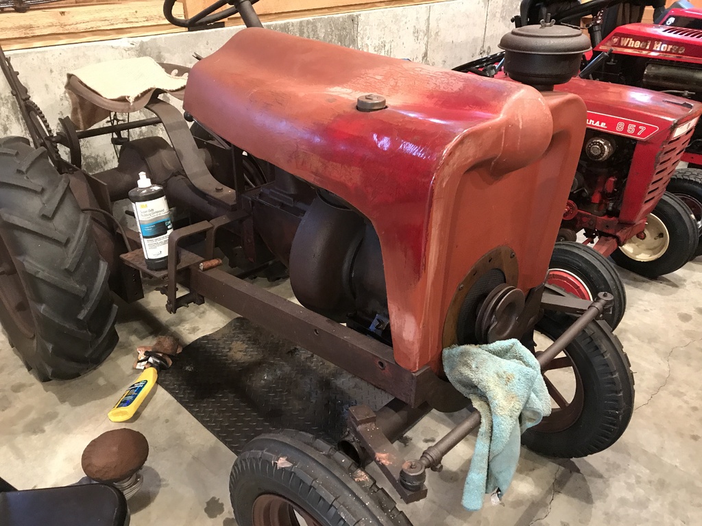

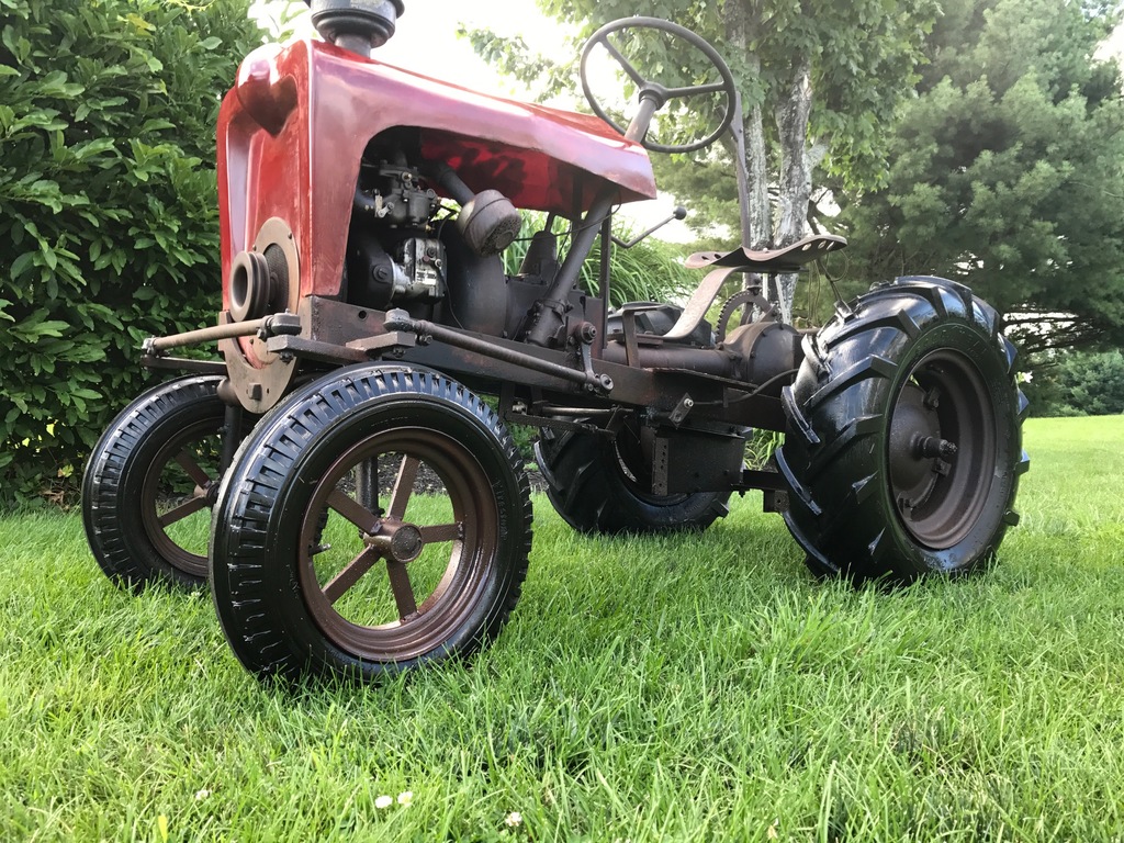

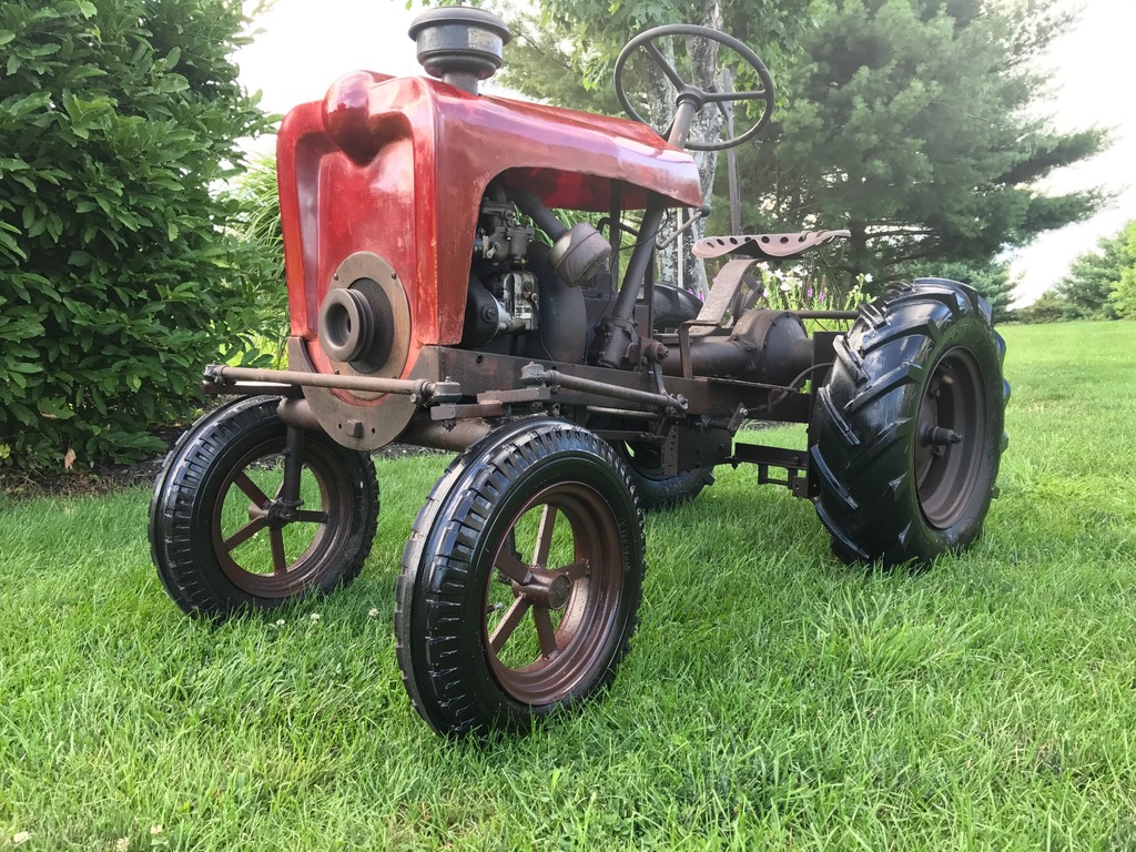

stevebo-(Moderator) 8,742 #94 Posted July 26, 2017 I finally decided to take the next step to get the primer off and it is coming out great. 6 Share this post Link to post Share on other sites

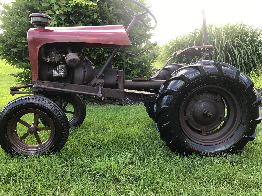

stevebo-(Moderator) 8,742 #95 Posted July 26, 2017 I think this is the finished product. May work on it a little more but overall I think it looks much better. 9 Share this post Link to post Share on other sites
rmaynard 17,526 #96 Posted July 26, 2017 That looks great Steve. 1 Share this post Link to post Share on other sites
TDF5G 2,074 #97 Posted July 27, 2017 That looks great! Mighty fine! I like it! Share this post Link to post Share on other sites
WHX?? 57,768 #98 Posted July 27, 2017 What product is on the tires? Share this post Link to post Share on other sites
stevebo-(Moderator) 8,742 #99 Posted July 27, 2017 1 hour ago, WHX11 said: What product is on the tires? Just an auto spray on like black magic or something like that I think. Share this post Link to post Share on other sites
