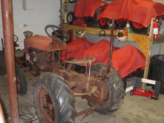

fireman 1,022 #29 Posted November 30, 2012 (edited) Steve and I are working on the Senior right now (Friday at 11:45am). I used my video camera bore scope and managed to get the camera end in under the hood far enough to read the engine i.d. plate. Got the serial number and went to the Wisconsin site to check the date of manufacture. Turns out the engine was made in the month of January 1956. That makes his tractor definitely a 1956 RS-83 . We cleaned the fuel system and made a new gasket for the fuel bowl. Changed all the fluid in the entire tractor and are now getting ready to fire it up. Will post the results after we see what happens! Edited November 30, 2012 by fireman Share this post Link to post Share on other sites

fireman 1,022 #31 Posted November 30, 2012 (edited) IT'S ALIVE !!!!!!! Had to clean the points in order to get spark. Here is a video of it running for the first time. Edited November 30, 2012 by fireman 1 Share this post Link to post Share on other sites

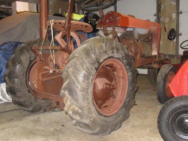

stevebo-(Moderator) 8,663 #36 Posted November 30, 2012 Well tires are off the economy and the tire shop has them mounted on the SR rims. We took the tires off of ourselves using tires spoons. I was very concerned about breaking the nuts loose holding the rims to the brake drums however after soaking them for a while they came off like butter!! Momma is on her way to pick up the newly mounted tires from the tire shop now and should be back around 830 ish. I will mount them back on and be ready for a ride in morning. I need to thank Jeff (Fireman) for putting is a lot of his time today to help me get this going. I also need to thank KenB for hooking me up with a set of turf tires and rims for the economy. Share this post Link to post Share on other sites
fireman 1,022 #37 Posted November 30, 2012 I didn't want to tell Steve that when I first turned the engine over with my hands by the starter pulley, it felt very different than mine. I was skeptical that it would start without major intervention. We got to the point where we were ready to fire it up. Wrapped the rope around and gave it a pull. At first it was very hard to pull. After a few times it seemed to get easier but were weren't even getting a cough out of it. Steve went to get a tractor as our arms were getting tired and I had already whipped myself across the face once. We figured we use the pto from ones of his others to turn over the engine with a v-belt. In the mean time I pulled the plug wire and checked for spark. There was none. Steve pulled the cover off the magneto and we cleaned and re-gapped the points. Put it back together and she fired off with very next pull of the rope. Man we were ecstatic! Let it run at a low idle for a while seeing as the engine hadn't been run in 3 years. It really sounds great. We had it up on jack stands in the rear and let it run for a few minutes in all 3 forward gears and reverse just to get everything moving inside with the fresh fluids. We shut it down and moved it back inside and back up on Jack stands. Removed the rear tires which came unbolted like a dream. Then took the old tires off the rims the old fashioned way with spoons and muscle. Low and behold when we had the tire and tube removed, we found some of the original paint in perfect condition on the inside of the rim. We dropped the rims and another set of tire and rims off at the local tire shop so they could swap them over. Steve will be getting these back at 9:00pm tonight and i'm sure he will have it out for a moonlight ride!!! 2 Share this post Link to post Share on other sites

stevebo-(Moderator) 8,663 #42 Posted December 1, 2012 Here are some pictures of it with the newly mounted rear skins... Share this post Link to post Share on other sites
