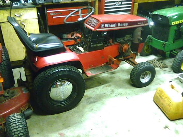

Wheel-N-It 2,978 #53 Posted December 14, 2012 Hey, I thought I would show ya'll what the 416 is looking like in its running/driving state. Remember the wheels and tires on it in the pic are not the correct ones. The rears are 8.50's so they are too skinny, and I think they may be 22 inches in diameter. The rear tires should be 23 inch in diameter x 9.50 inch wide. The front tires are not the correct diameter either. The front wheels on it now are 6 inch diameter. The correct front wheels should be 8 inches in diameter. Also remember I had to put these wheels/tires on because one of the rear tires and one of the front tires would not hold air. So after Christmas I got to get serious about what kind of tires I am going to put on this Horse. I am open for suggestions about what color to paint the wheels. Please give me some ideas on wheel colors. Share this post Link to post Share on other sites
Tankman 3,528 #54 Posted December 14, 2012 The Stallion will look great with the new donuts. 400 series wheels were silver, I used Duplicolor "Wheel Paint" Silver on my '88 414-8 and '85 416-8 rims. Look great, original. Paint dries very fast. Used the rattle can, simple. Just changed, '85 416-8, wheel studs to bolts (7/16-20 x 1 1/2" long), flat washers and lug nuts (7/16-20 thread), blue Threadlocker on the bolts, all chrome. Nice! Followed instructions in this forum, Thanks New Hampsha! "Shoeing" the Horse has never been easier. Going to change the other three Horses over too. 1 Share this post Link to post Share on other sites
Kevbo 81 #55 Posted December 14, 2012 They sell that Duplicolor wheel paint at pep boys. It is some good stuff! 1 Share this post Link to post Share on other sites
AMC RULES 37,259 #56 Posted December 14, 2012 I like the photography you've included in this thread Van...a good eye you've got there. If you're considering a change, I'm voting you change to a high gloss BLACK on all four corners. Really serves to make these ol' horses look tough. 1 Share this post Link to post Share on other sites
