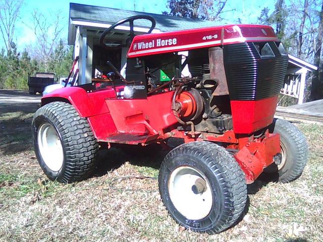

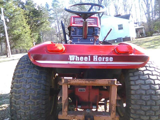

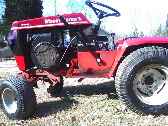

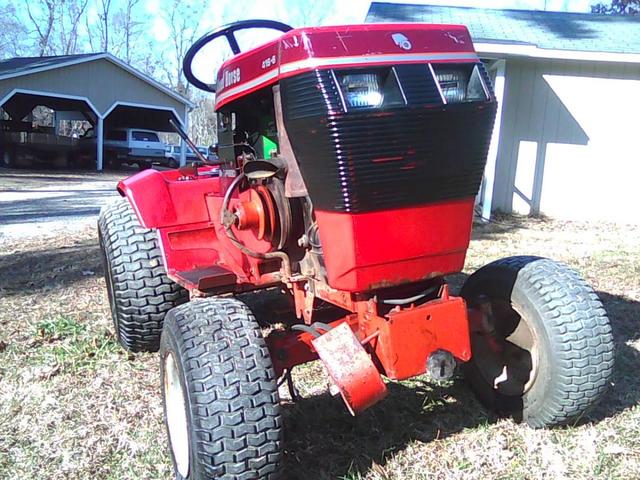

Wheel-N-It 2,978 #29 Posted December 1, 2012 OK guys, update time: Picked up the 416 this morning. Brought it home and gave it a good bath, and then another bath, then a blow drying with the backpack blower. Then followed that up with a WD-40 bath and rubdown. I removed the seat for this due to the seat has some cracks, and I did not want to get the foam wet. Then it was time to grease everything that had a fitting so it would steer and roll easier when I pushed it from one place to another. Then it was pic taking time, and it looks pretty darn good eh? :) 3 Share this post Link to post Share on other sites
TT-(Moderator) 1,170 #30 Posted December 1, 2012 It looks great! It must not have spent much time in the ocean air like many I've seen from down your way. Share this post Link to post Share on other sites

Tankman 3,528 #34 Posted December 3, 2012 Very nice cleaning job! Looks great, a worker for sure. Not an '85, must be an '86. The dash has the monitoring lights, my '85 ('88 414-8 does) does not. Looks like the steering has the same usual ailment. Been soaking the steering wheel for a week or two now but, did get the 1/4" x 2" roll pin out. Removed the battery and bent the upper panel inside flange down tightened up the steering until I can remove the assembly. Working fine. The '85 does not have the gas spring or slider assembly on the seat. The '88 does. Both the '85 and '88 have 23 x 8.50 x 12 rear tires. Yours look great. What size are they? Either way, a great Horse. The 416'll be the leader of the gang for sure. 1 Share this post Link to post Share on other sites

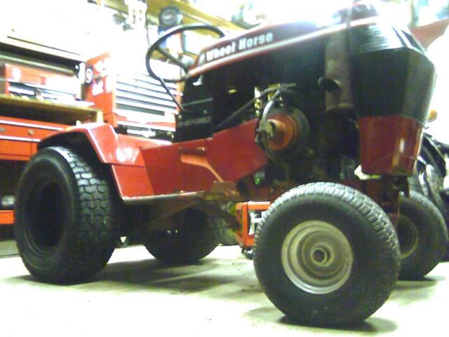

Wheel-N-It 2,978 #41 Posted December 5, 2012 Small update; I removed all four tires/wheels as two of the tires would not hold air. In their place I installed a extra set of wheels/tires from a 312. Now the 416 looks more like an old 310-8 due to the rear tires are 8.50's. I kinda like the look but its not going to stay that way. Probably will get some AGs on the rear and tri-ribs for the front. But the wheels have got to be cleaned and repainted before any new rubber goes on them. I may paint the wheels a different color, just don't know yet. Any suggestions? Also due to other obligations I probably won't back to work on the 416 till this weekend. Plans then are to remove the fuel tank and give it a good cleaning. I've done this a couple times before so no big deal. Replacing the fuel line will go along with the newly cleaned tank. My helpful hint to ya'll for that is to splice the new fuel line on to the old fuel line, soap everything up and pull it through the tractor like pulling cable through conduit. Share this post Link to post Share on other sites
