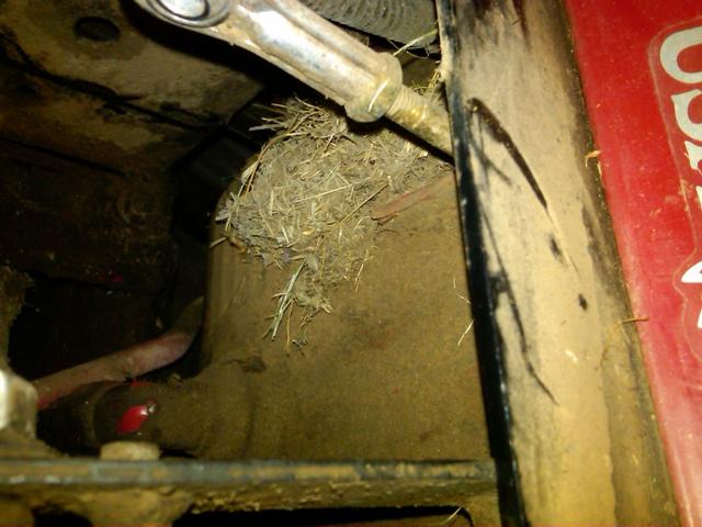

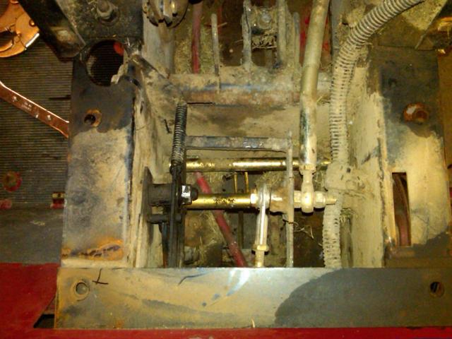

leeave96 495 #1 Posted November 27, 2012 When tearing my mighty 520H, I found the innards to be filthy with grass and dirt. I have a feeling the culprit of this was my 42 inch rear discharge deck. My question is - how many of you are using a RD deck with a hydro and if not, how dirty and packed with grass do you find your tractor? Thanks! Bill Share this post Link to post Share on other sites
855ownerJoel 32 #2 Posted November 27, 2012 Wow, I have a rear discharge but I hose everything off after every mowing. That could cause some heat build up, not good. Share this post Link to post Share on other sites
Tankman 3,526 #3 Posted November 27, 2012 I seldom find dirt on any of my four WH garden tractors except during use. After each use, usually, backed up to the barn, power washed (carefully), and blown dry with the Echo backpack blower before backing into their parking spaces in the barn. Takes 'bout five or ten minutes. When I had rear discharge mowers, same cleanup. Grease and/or oil are applied as needed. The Horses are well cared for in their old age. :-) 2 Share this post Link to post Share on other sites
tommy3horse 3 #4 Posted November 27, 2012 I recently worked on my Dad's '75 C-160 hydro with a side discharge deck. I replaced one of the axel seals. I took it to the car wash just to be able to see the rearend. Side, rear, does not seem to matter, I tend to wash them off with a hose after mowing just to keep the grass and leaf clippings out of the garage, with the side benefit of keeping the tractors somewhat clean. Tom Share this post Link to post Share on other sites
GlenPettit 1,718 #5 Posted November 27, 2012 That blow-back is a problem with the 42" Rear Discharge decks. Wheel Horse used to offer a metal extension for that 42" RD deck as an option; what I did is to just add on a 2" rubber extension (4' kitchen black base molding, cut; $2) beyond the back of the deck, the holes are already in your deck for exactly that application. Just that short 2", with the curve down, eliminates 95% of what we used to get, and no problem with the "throw, lay" of the clippings. Also, we use a blower on our air hose to blow-off most the dirt & dust, outside the barn, to keep the deck & mower dry. Note, that the carriage bolt heads are on the underside, with locknuts on top. 3 Share this post Link to post Share on other sites
ericj 1,579 #6 Posted November 27, 2012 rear discharge deck almost require that you blow the tractor off after use in my opinion. i back my tractors up to the shed and use a blow gun off my air compressor and blow the tractor and decks off. my 1st deck was a 36" rear discharge deck and after several months of use the tool box on my c120 was full of grass so i started using my leaf blower to blow it till i finially got an air compressor eric j Share this post Link to post Share on other sites
nylyon-(Admin) 8,602 #7 Posted November 27, 2012 I use a hand held leaf blower after every use and blow off the clippings on the entire thing. Every spring (although I should do it in the fall) I remove the access plates and clean it out really good. The other thing is that cam plate on the hydro itself. It needs to be removed (yes removed) to get all the debris out of there and the linkage. I hadn't done that and after a while the debris built up enough to actually make it go in reverse very slowly. Removed the plate, cleaned it out and it's back to full reverse (and forward as well). My 414 has a SD deck on it and I get a lot of the clippings right onto the engine flywheel from the left corner of the deck. Why, I don't know but that doesn't happen with the RD which is good for the Onan. 1 Share this post Link to post Share on other sites

squonk 44,973 #10 Posted November 28, 2012 That blow-back is a problem with the 42" Rear Discharge decks. Wheel Horse used to offer a metal extension for that 42" RD deck as an option; what I did is to just add on a 2" rubber extension (4' kitchen black base molding, cut; $2) beyond the back of the deck, the holes are already in your deck for exactly that application. Just that short 2", with the curve down, eliminates 95% of what we used to get, and no problem with the "throw, lay" of the clippings. Also, we use a blower on our air hose to blow-off most the dirt & dust, outside the barn, to keep the deck & mower dry. Note, that the carriage bolt heads are on the underside, with locknuts on top. I did the same thing with the rubber flap. There used to be grass all over the hydro, now just a few clippings. Share this post Link to post Share on other sites

SousaKerry 503 #14 Posted November 28, 2012 I used to hose down my C-175 after every mow with the 42" RD including getting up under the fenders and such, thought I was doing pretty good. The other day I was mounting the snow blower and had my head up underneath and noticed that the frame rails had a 1/2" of grass clippings on them still....I haven't mowed with this tractor in 4 years. But I would say that removing panels and fender to wash it out once or twice a year with a RD deck is a must. Share this post Link to post Share on other sites
