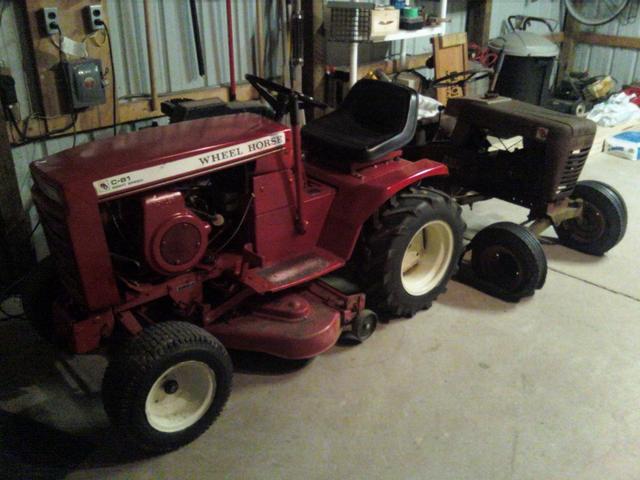

47JDG 65 #62 Posted December 2, 2012 Snapped this picture before I came in tonight after working on the 633. As you can see they have already made friends with each other. This will be the first night that old one has spent inside in who knows how long.. 1 Share this post Link to post Share on other sites

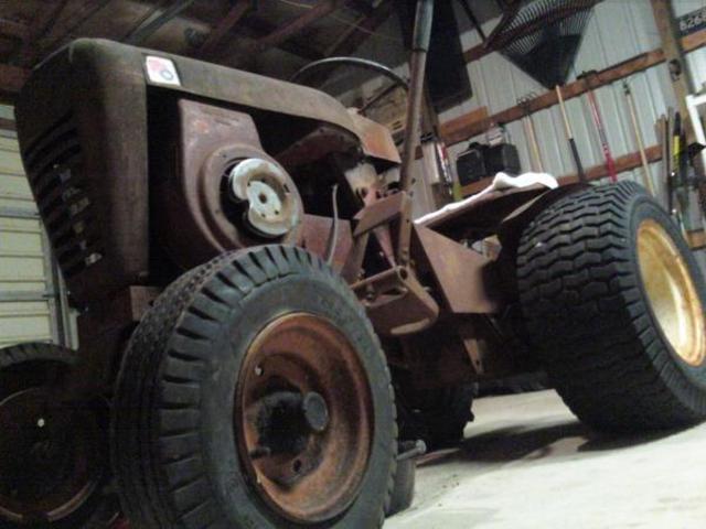

47JDG 65 #73 Posted December 8, 2012 Well I fixed my steering problem today. It was the pin in the front of the steering lower shaft as TT thought. I was able to tap it out lightly pretty easily once I picked up the front end. I replaced it and it seems reasonably tight now. Tie rods could use some work as well, but for now its OK because I can at least turn the wheels and push it around my shop when I need to. I picked up a pretty decent set of 23 x 10.5 x 12 tires on nice wheels today as well. My tires are all shot so these will do nicely. I would like to go back to the duals eventually with good rubber, but for now I just need rubber that holds air. A local store has the 4.80 x 4 x 8's on sale right now for $19 so I will probably pick up a pair of them and some tubes for the front. 1 Share this post Link to post Share on other sites
