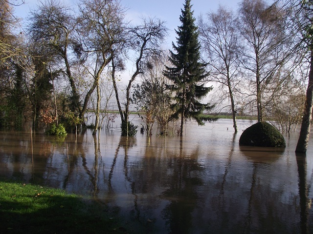

philpjuk 19 #37 Posted December 21, 2012 Not much left to mow!,had some mad canoeists through my garden,the river is very fast and dangerous,my BBQ,park benches,large clay pots etc are under the water (I hope) It is scary to see such a large volume of dirty water moving so fast without making any noise with still water over the garden.It has flooded before while I have lived here but never so high.The village upstream last night bult their own flood defences with clay and a JCB and saved the houses from flooding.We dont have huricanes in the UK (well not big ones) but get plenty of rain! Share this post Link to post Share on other sites
