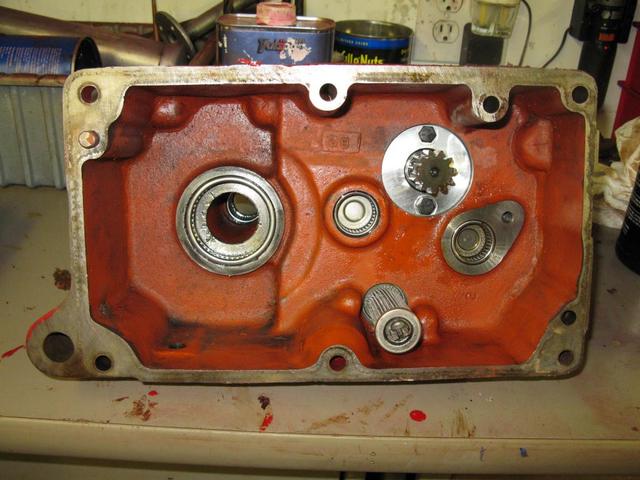

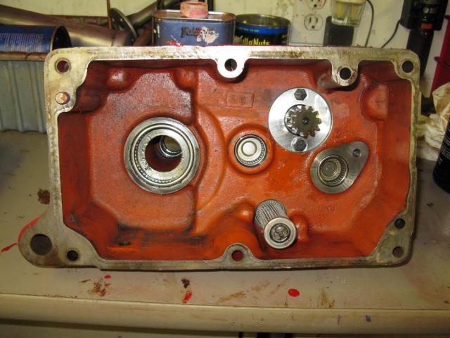

stevebo-(Moderator) 8,742 #12 Posted November 23, 2012 the second picture shows the screen. once you pull the motor off the screen flange is right there Share this post Link to post Share on other sites

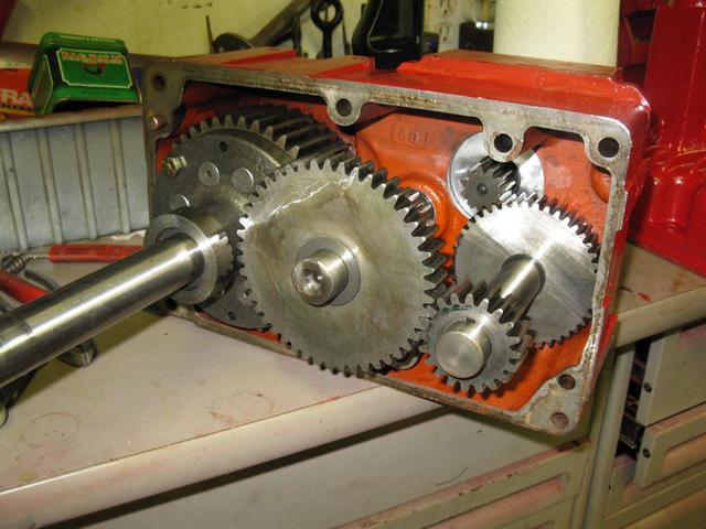

mattd860 163 #15 Posted November 27, 2012 Ok I starting taking stuff apart today and found some oddities but nothing that clearly explains why the unit has failed. First off, the instake screen has totally come apart. The screen was floating around in the reservoir/transaxle area and I had to fish it out. These are the three pieces I found, but I'm not sure if there are any more pieces in there. Also - the charge pump gear looks to have some minor wear on it. It's hard to see in the pictures but look closely. I'm not sure in the scoring on the gear is enough to prevent the unit from pumping up the oil from the reservoir. Additionally - the main sippers (or whatever they are called look good. I haven't taken apart the motor yet because for some reason it was not coming apart. I am also having trouble separating the valve body from the motor but I'm sure I'll figure it out. The problem I may be experiencing could be in the valving, but remember, I also lost the lift cylinder so that would assume that ALL valves (forward, reverse, lift, and check valves) have dirt or corrosion which is odd.......???? Since I also lost lift cylinder control, I guess it's safe to assume there is nothing wrong with the motor or motor sippers either. Could the lack of intake screen have caused my problem? I wonder if any part of the screen plugged the hole of the intake port. ALSO - WHY IS THE FILTER AT THE END OF THE LINE??????? THIS IS STUPID IN MY OPINION. The filter only cleans fluid that has already gone through the system so how does it prevent gunk from the reservoir from entering the system???? Seems lame to me. Share this post Link to post Share on other sites
coldone 35 #16 Posted November 27, 2012 If the charge pump is that badly damaged, I am betting that that your valve plate is toast. The valve plate is the brass/steel plate that was under the cylinder block. If there is severe scoring on the Valveplate then all the pressure built up by the charge pump is just slipping by from high pressure side to low pressure side. Be careful with the cylinder block piston combo, the pistons are supposed to be matched to the individual bores. Share this post Link to post Share on other sites
