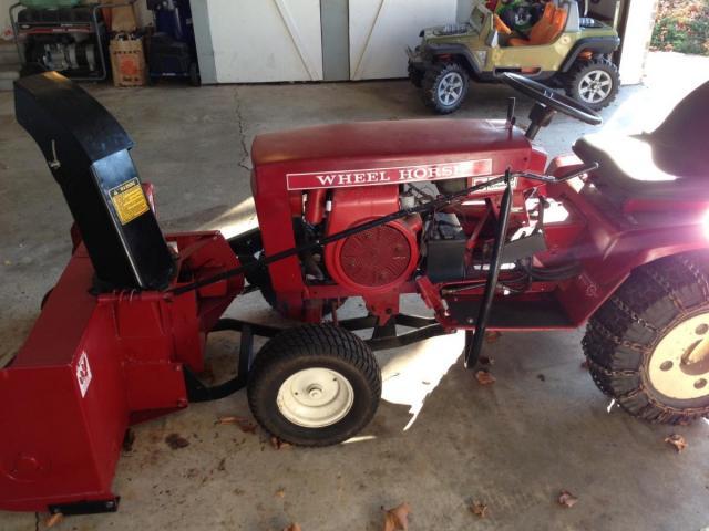

bigfkd22 11 #6 Posted November 12, 2012 So here is my blower on. The subframe needs quite a bit of adjustment when installing or it wont lift correctly. I also had to drill a few holes into my foot rest in order to install the crank support. My dad and I turned it on and it was spinning but barely. Then I had adjusted the pto as it wasnt fully engaged then turned it on. Holy cow this things was spining like crazy it blew my dads hat off in the garage. I dont really get enough snow to use a 2 stage but its all really in the eye of the beholder right? Thanks for the help! derrick ps I have a really nice single stage short shoot if any one in lansing mi area needs one shoot me an offer Share this post Link to post Share on other sites
Kelly 1,036 #7 Posted November 12, 2012 So Derrick you got it, you will have your little drive done in two passes with that, and if anyone is looking for a blower the single stage he has for sale is very nice. Share this post Link to post Share on other sites
Jeremy Watson 22 #8 Posted November 12, 2012 That looks really good! I know what you mean about the eye of the beholder. I have a city lot and driveway and I have a 48" deck and a 42" snowblower on a 520h. Can you say over kill! But I like it. Hope you get some snow to try it out! Jeremy Share this post Link to post Share on other sites
