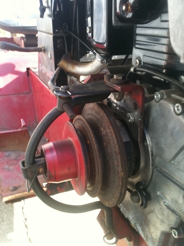

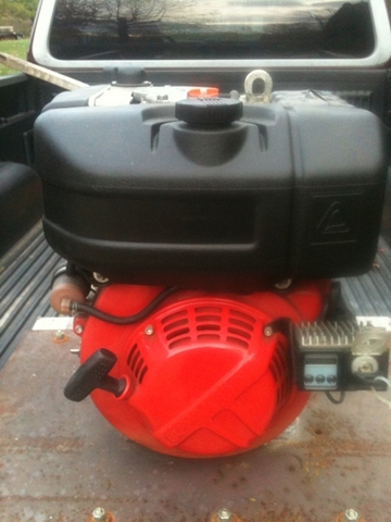

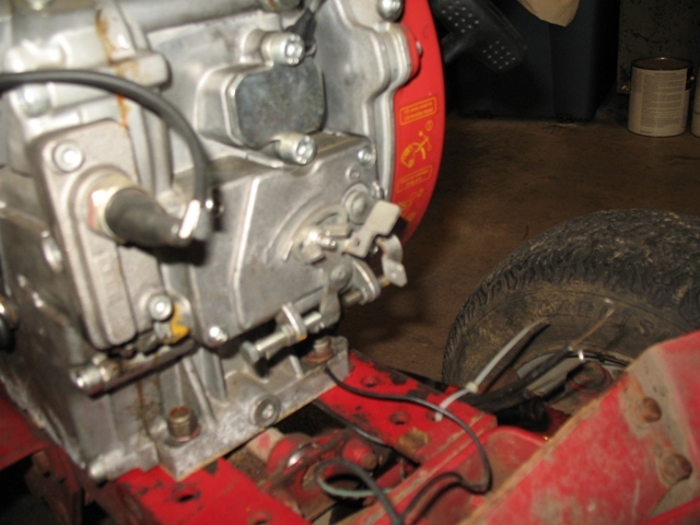

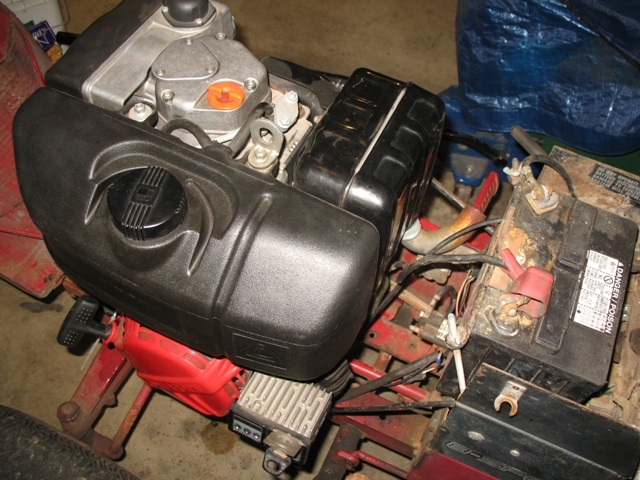

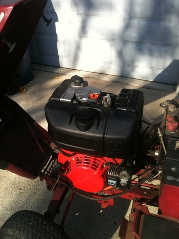

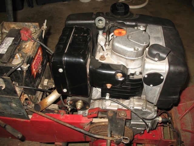

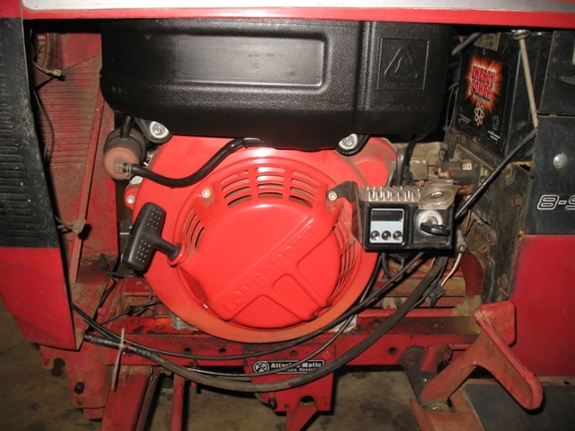

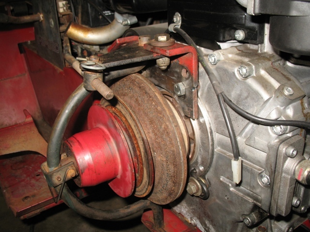

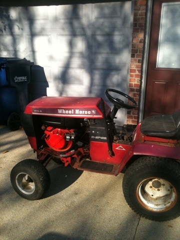

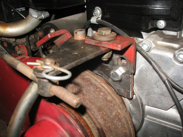

Tgblanken 27 #8 Posted December 18, 2012 Yes it can be done. It is not a direct replacement. You will have to get a pulley from a 8hp kohler and you will have to fab up a PTO bracket. You will also need to drill new mounting holes to bolt the engine in the correct place. Is it worth it? Yes, plenty of power easy on the fuel and love the sound of the diesel barking. "Junk Yard Diesel" Terry Share this post Link to post Share on other sites
Tgblanken 27 #9 Posted December 18, 2012 More pictures. 2 Share this post Link to post Share on other sites
