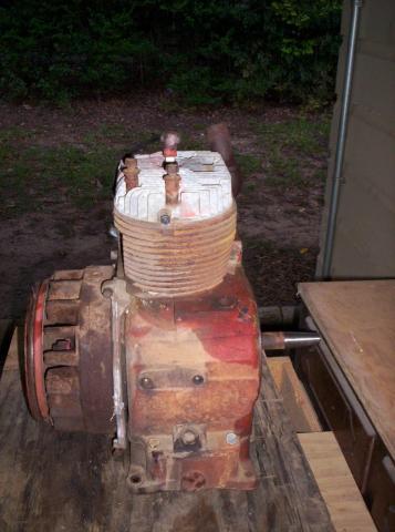

groundhog47 445 #1 Posted October 31, 2012 K-241P, tapered cranshaft. Of course the part number is different but does anyone know if a keyway splined K-241 shat would directly interchange. As of yet unknown on stand or under on journal, and don't want to take it down till can determine if can do a swap. Share this post Link to post Share on other sites
SousaKerry 503 #2 Posted November 1, 2012 All K241 cranks should be the same just the end is machined different. If you want to make sure measure the journals where they go through the main bearings. Share this post Link to post Share on other sites
groundhog47 445 #3 Posted November 2, 2012 Hey, I really do appreciate reply, thanks. I figured as much but another head on the figurin' goes a long way. Share this post Link to post Share on other sites
