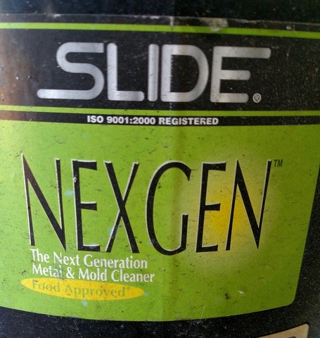

TIGman 2,006 #33 Posted June 6, 2016 Was going to try the ATF/acetone mix this weekend on the 875 slot hitch that was rusted tight. Didn't have any acetone so I used Slide Nexgen in the mix. We use Nexgen all the time at the shop as a cleaner -degreaser. It is citrus- vegetable based biodegradable. Put some on the hitch in the morning and by later afternoon I could start to move the hitch. Just another"Witches Brew" to add to the list. 1 Share this post Link to post Share on other sites
