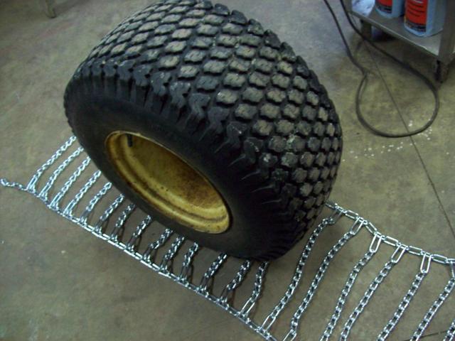

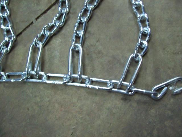

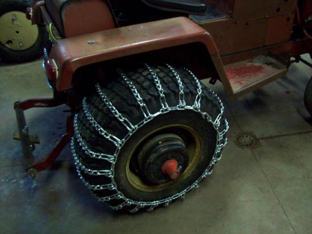

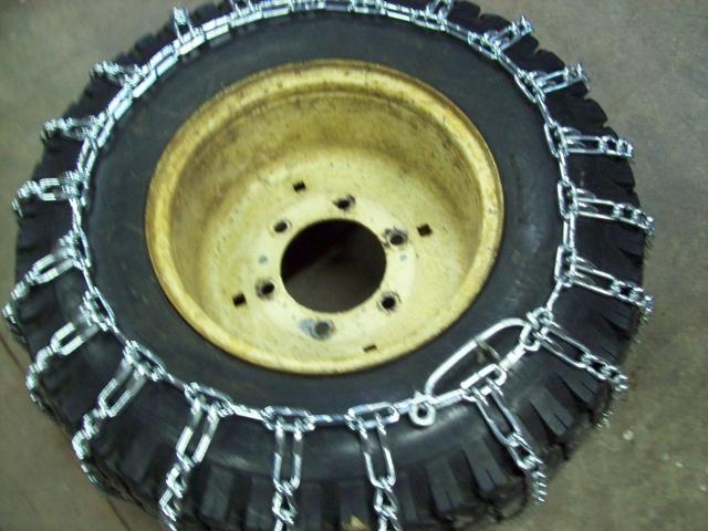

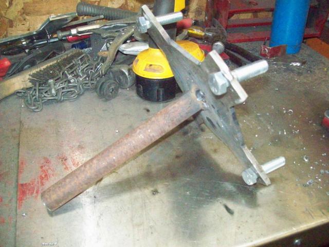

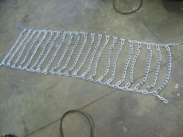

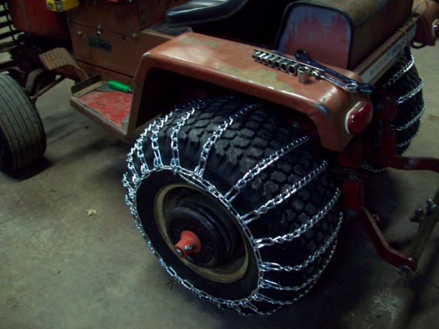

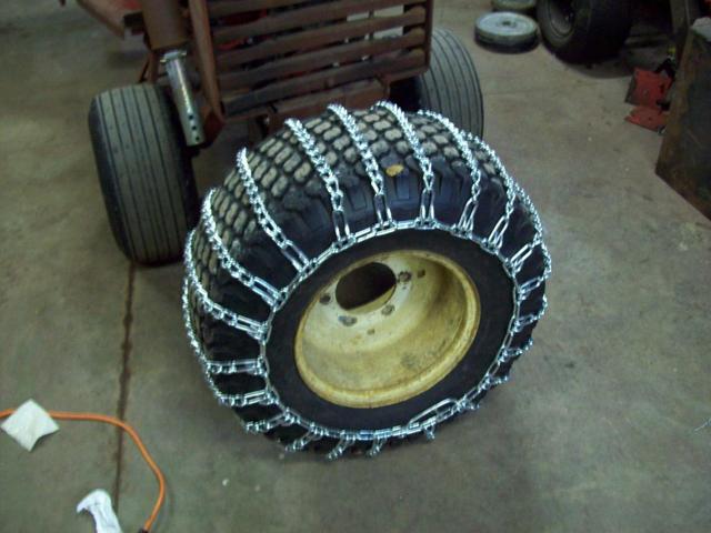

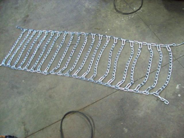

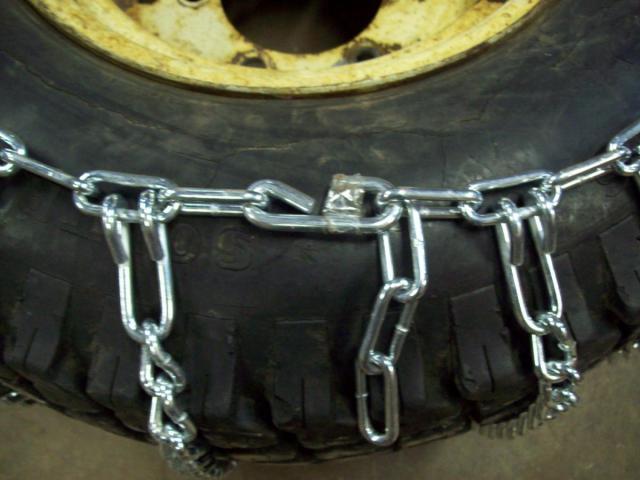

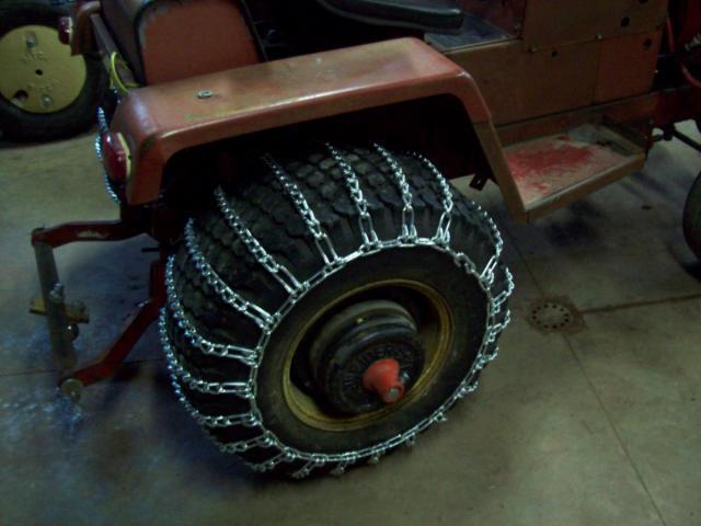

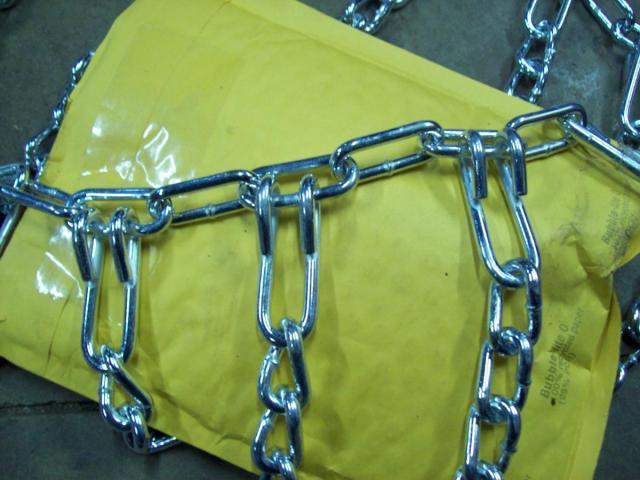

1maidenfan 202 #1 Posted October 28, 2012 Tried loading this in the new "instructional section" but did not load??? Ok, lets try here. Start by removing tire from tractor, lay out chains with cross connectors down as to not puncture tire side walls, remove air from tire, much as possible. (see pix # 1,2 and 3) Next set tire on chain and wrap chain and attach one side, side with tightening lever bar.(see pic #4) Flip tire on its side with the J hook part of chain up, tighten chain as tight as possible.Then flip tire over and tighten adjuster side as tight as possible.(see pic 5 and 6) Stand tire up, adjust chain evenly and fill with air.(pic # 7) My tire recomends 10 psi, I added 15 psi to tighten the chains more. Install on tractor and your done, this took me about an hour but I also installed my home made wheel weight brackets and weights. (pic 8,9 and 10) Hope this helps. 2 Share this post Link to post Share on other sites
AMC RULES 37,254 #2 Posted October 28, 2012 Awesome wheel weight idea. 1 Share this post Link to post Share on other sites
