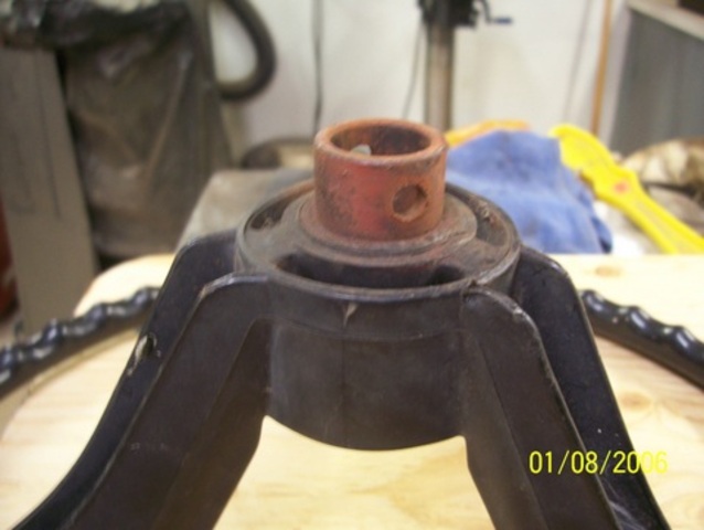

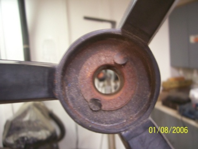

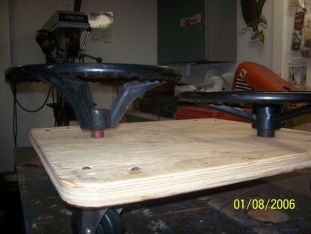

rockinhorse 45 #16 Posted November 3, 2012 GLGRUMPY I have some wheels one is a tall . Here are some pics . If you are intrested give me a call 1-765-525-7105. I live 2 1/2 hrs south of you. I have 2 other steering wheels also these are keyed. $30 for the tall wheel. thanks Karl Share this post Link to post Share on other sites
