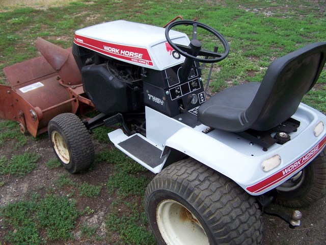

546cowboy 302 #4 Posted October 23, 2012 The replacement seats I have been buying for the last few years when I can find them have a cover that seems to be rubber or something close to that. I have never had one crack or split. I have been getting them at a farm store for about $50 and from what I have seen it's a bargain. Here is a picture of one on my GT1848 Share this post Link to post Share on other sites
Tankman 3,523 #5 Posted October 23, 2012 Like the Cowboy, I found rubber seats (as in his picture). I never purchased one, pick 'em up at the junkie, five bucks. The rubber easily comes off, foam can be washed while the steel bucket is painted. Drill mounting holes as required before paint. Spray adhesive makes the foam stick back in. The rubber cover takes paint easily, I use RustOleum Gloss Black lacquer (rattle can). The seat now mounts with new holes and looks new with the black paint. On another subject, black coarse skateboard grip tape is excellent on the foot rests. Share this post Link to post Share on other sites
