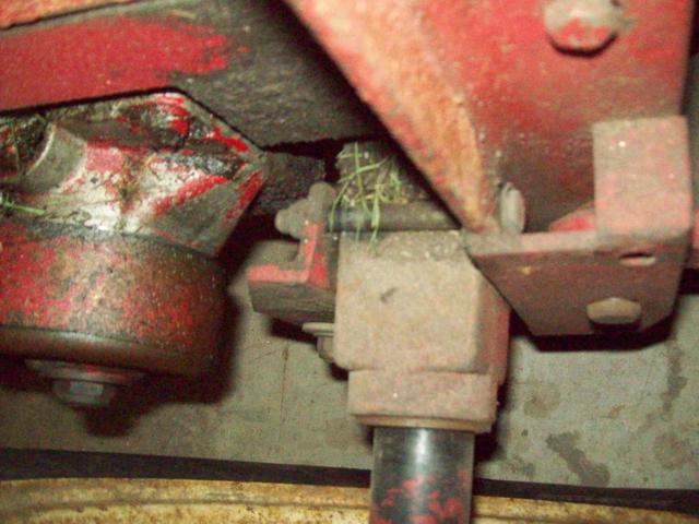

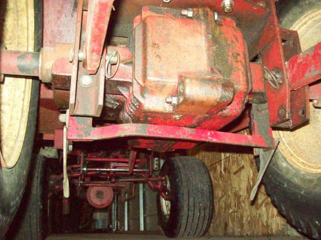

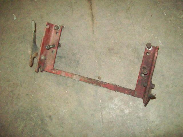

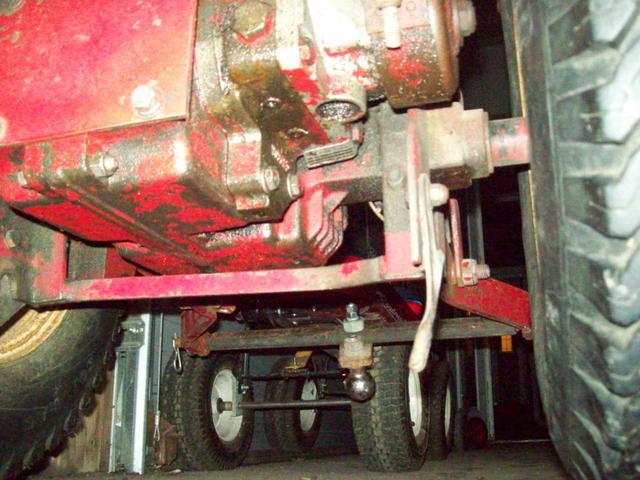

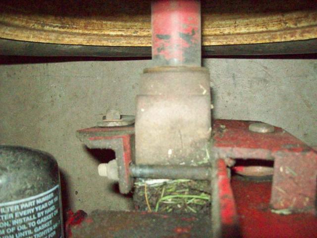

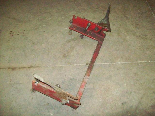

1maidenfan 202 #6 Posted October 23, 2012 maybe it will make more sense when I find some brackets When I compare it to my C120 plow set up, there is no way the brakcets will go on the 18auto because the 3 point hitch brackets go right where the brakets go on the C120 Here some pix, hope they help. Any ?'s Share this post Link to post Share on other sites
blackdogfarm 0 #7 Posted October 23, 2012 oh so the bracket is not like the ones on the smaller tractors this bracket bolts around the axel and through the 3 point hitch brackets. I need the part I guess. :/ Share this post Link to post Share on other sites
1maidenfan 202 #8 Posted October 23, 2012 oh so the bracket is not like the ones on the smaller tractors this bracket bolts around the axel and through the 3 point hitch brackets. I need the part I guess. :/ I have an extra bracket if you need one. Share this post Link to post Share on other sites
