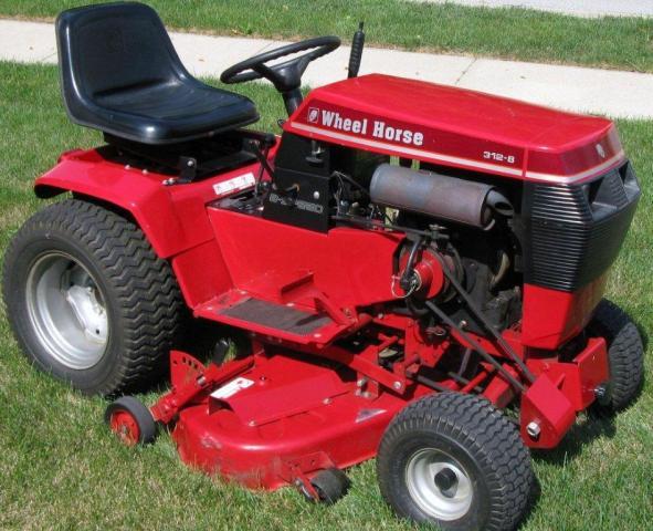

sadixon49 11 #1 Posted October 22, 2012 I've been looking to buy an extra set of rear wheels for my 312-8. I have seen quite a few wheels from JD, Cub Cadets, and Cases on the net. They all look like they would interchange, but I'm wondering if there is someone who knows. To me I would think any 12x7 or 12x8 5 hole rim should work, but some seem to have too small of a center hole, I have a 3.125" center hole on my rims. thanks steve Share this post Link to post Share on other sites

WheelHorseSteve 56 #6 Posted January 7, 2013 If you do end up with another brand that doesn't have a negative enough offset you can do wheel spacers to make up the difference. I got some Jeep 5x4.5 spacers off of eBay and used threaded 7/8" rod to make studs. These off-white painted JD 23x8.5" wide rims work nicely with this arrangement -- if I didn't have the spacers, I'd have rubbing issues for sure: 3 Share this post Link to post Share on other sites
