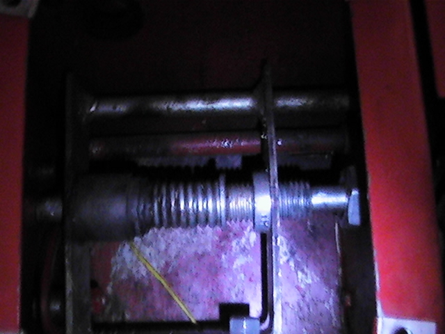

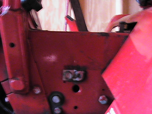

608KEB 812 #3 Posted October 24, 2012 Thanks for the input. I switched the transmissions with no problems. The next issue is the hydro lever. It is stuck. I had to weld the brace that bolts to the frame. When I fixed this problem, The lever would not move until I loosened up the nut that is on the shaft with the spring. Where would I heat this to free up the lever? Share this post Link to post Share on other sites
608KEB 812 #4 Posted October 24, 2012 Would I heat up the threads that are in the picture? Share this post Link to post Share on other sites
kpinnc 16,479 #5 Posted October 25, 2012 If you can get the DCL assembly out, then the area you want to take apart and clean is right where the yellow wire is going- it made a good pointer in this case. That is a cone-shaped part that sets the friction of the DCL, though it isn't obvious without seeing it apart. They sometimes rust and freeze up, which results in the problems you're having. Here's a better view of the assembly: Parts 6-56 and 6-58 tend to rust together over time, so taking them apart and cleaning that up is a good idea. Good luck! Share this post Link to post Share on other sites
608KEB 812 #6 Posted October 25, 2012 I heated it up til it was free. I oiled it the best I could from each side. I also backed off the tension on the spring. It works really well! The movement on the lever is smooth. I have a B-100 auto that I'm restoring and I took that lever apart, so I could understand how it works. Thanks KB Share this post Link to post Share on other sites
