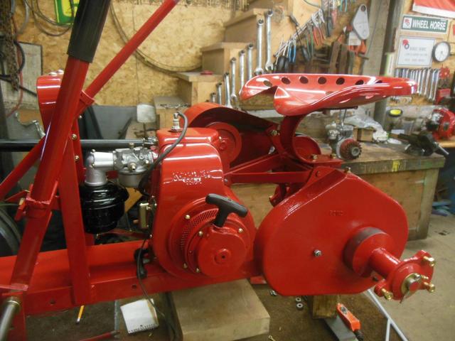

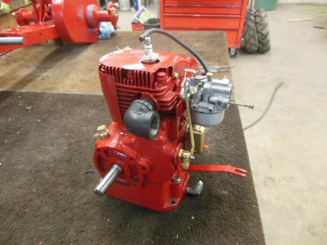

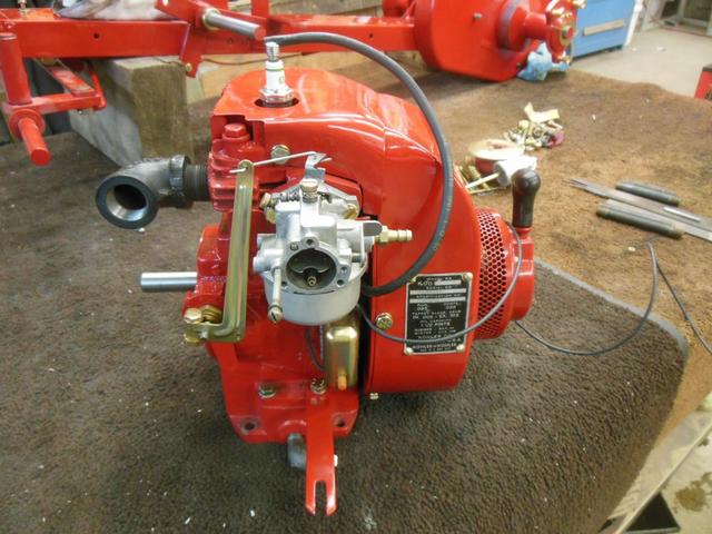

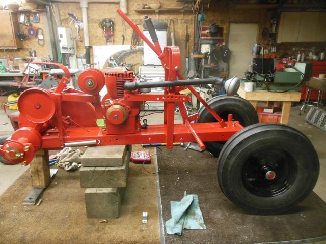

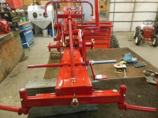

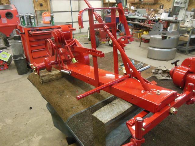

Jake Kuhn 1,599 #81 Posted February 27, 2015 Getting a little closer, engine is now complete other than oil drain and air cleaner, still have to paint the air cleaner, and pick up some screws for the carb elbow. I'm going to run the oil drain off to the side of the frame, its probably not original, but don't want to make a big mess on the frame when changing the oil. Also got the rear lift, and steering together and working good. exaust was painted with rustoleum high temp paint, have had good luck with this on several tractors. 3 Share this post Link to post Share on other sites
Racinbob 13,023 #82 Posted February 27, 2015 You amaze me Jake 1 Share this post Link to post Share on other sites
RedRanger 1,470 #83 Posted February 27, 2015 That coated hardware really completes the project. 1 Share this post Link to post Share on other sites

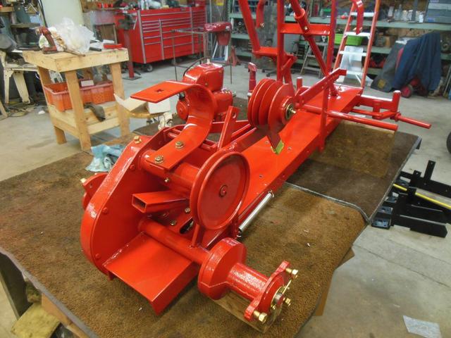

Martin 2,134 #84 Posted February 28, 2015 (edited) Got some parts back today, can finally start putting it together a little more. DSCN3378.JPG DSCN3379.JPG bet you couldn't wait to start putting them parts on once you got them back...... Edited February 28, 2015 by Martin Share this post Link to post Share on other sites

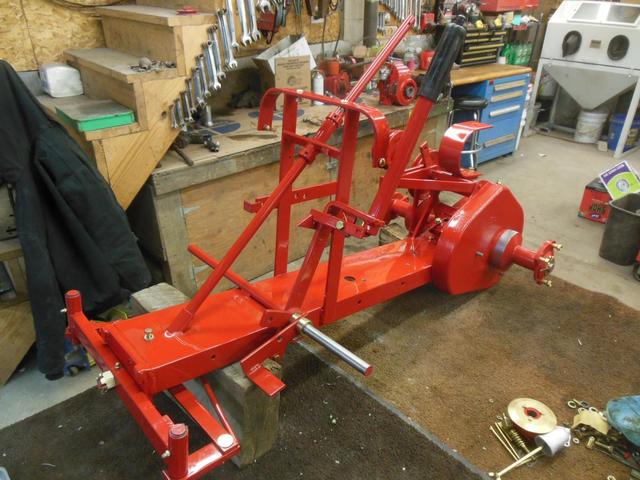

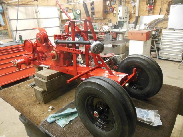

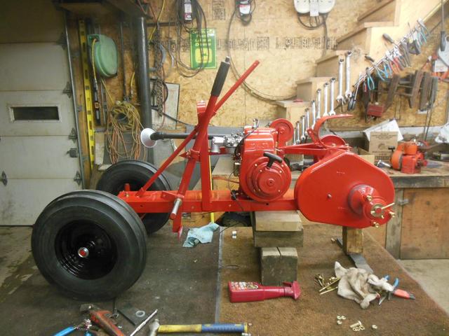

Jake Kuhn 1,599 #87 Posted March 1, 2015 (edited) Here's an update today, didn't get to spend a lot of time on it today, but got the engine back on now, hopefully for the last time and front tires mounted and installed on the tractor, will have to wait until next weekend to get the rears on as I didn't have any tubes. Still need to get the speed selector arm fixed and painted, a friend has had it for a while now, waiting for him to weld in a new piece for me, once I have that painted and back tires mounted its pretty much ready to go together the rest of the way. Edited March 1, 2015 by Jake Kuhn 6 Share this post Link to post Share on other sites

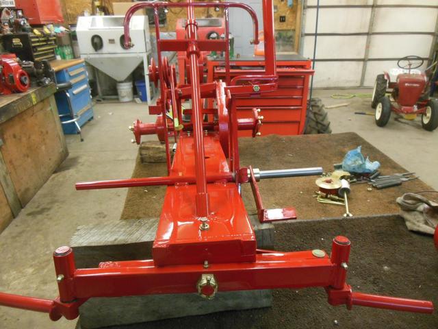

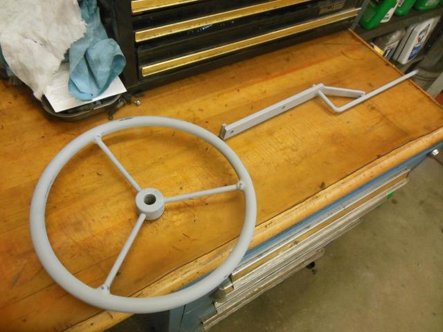

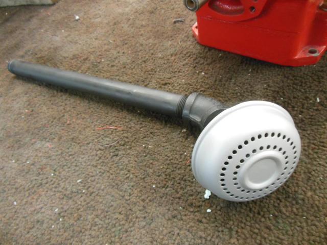

Jake Kuhn 1,599 #88 Posted March 17, 2015 Got the oil bath, seat, and belts/belt guard installed. Also have the steering wheel and speed selector ready for paint, hope to paint those and a brake kit for it tomorrow or thursday. Its getting pretty close! 2 Share this post Link to post Share on other sites
Racinbob 13,023 #89 Posted March 18, 2015 And this is only a partial restore Beautiful job Jake 2 Share this post Link to post Share on other sites
Pullstart 70,508 #90 Posted March 23, 2015 I was just thinking the same thing Racinbob! more great work from Jake 1 Share this post Link to post Share on other sites

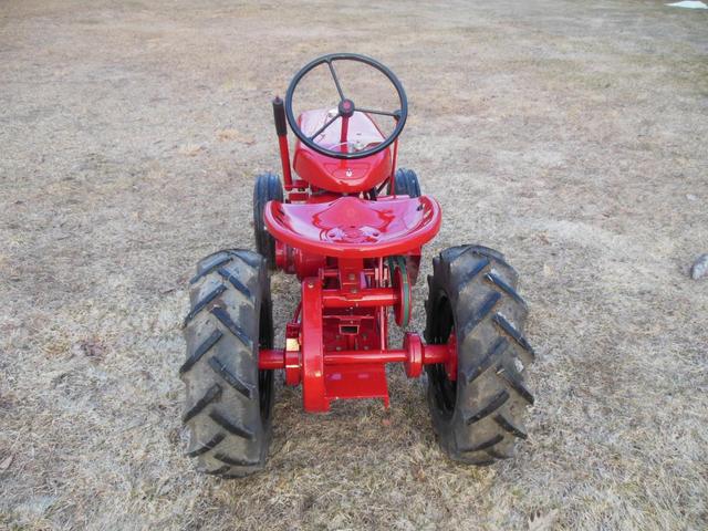

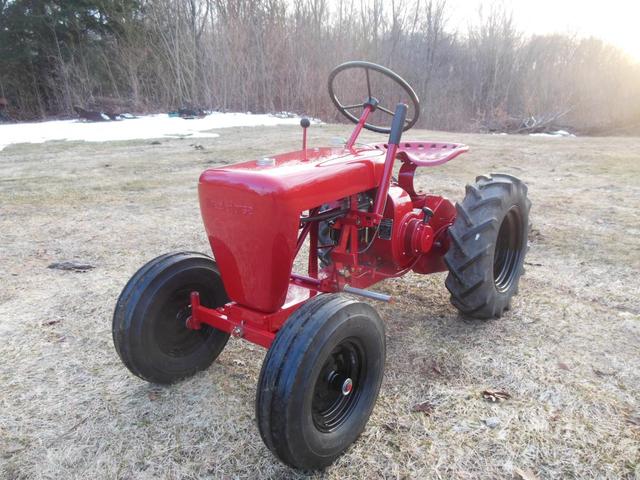

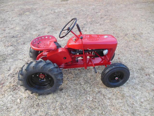

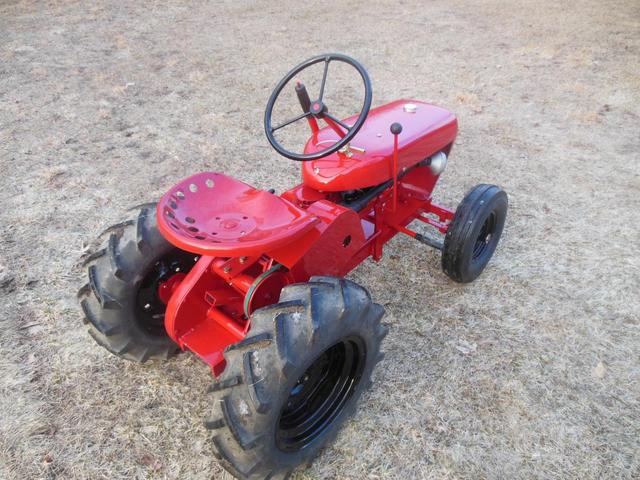

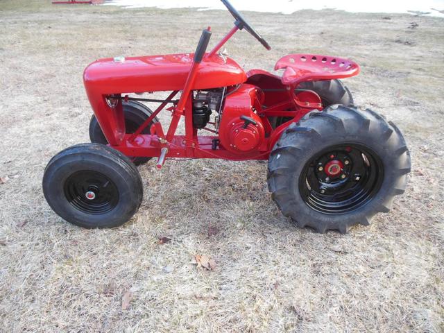

Jake Kuhn 1,599 #91 Posted March 23, 2015 Finally got it out for a ride today. Still have several things to go back and fix, and put my new back tires on, but glad to have it going for now. Runs and drives awesome. 2 Share this post Link to post Share on other sites
dclarke 4,270 #92 Posted March 24, 2015 Looks great, Jake! 1 Share this post Link to post Share on other sites
stevebo-(Moderator) 8,735 #93 Posted March 24, 2015 Jake- That came out really nice. Love to see it all come together. 1 Share this post Link to post Share on other sites
Racinbob 13,023 #94 Posted March 24, 2015 Beautiful job Jake....as always. 1 Share this post Link to post Share on other sites
Pullstart 70,508 #95 Posted March 25, 2015 that looks awesome! 1 Share this post Link to post Share on other sites
AMC RULES 37,259 #96 Posted March 26, 2015 Very nice Jake. Share this post Link to post Share on other sites
Jake Kuhn 1,599 #97 Posted March 28, 2015 Thanks all! Hope to get my new tires mounted tomorrow..and maybe if I feel up to it I will put the decals on. 1 Share this post Link to post Share on other sites
