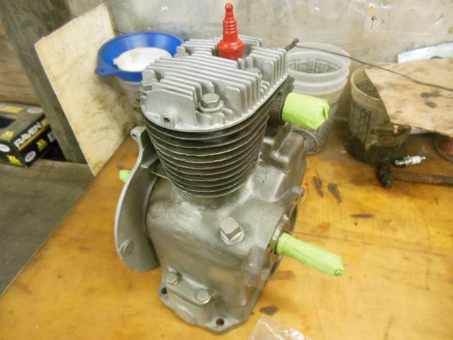

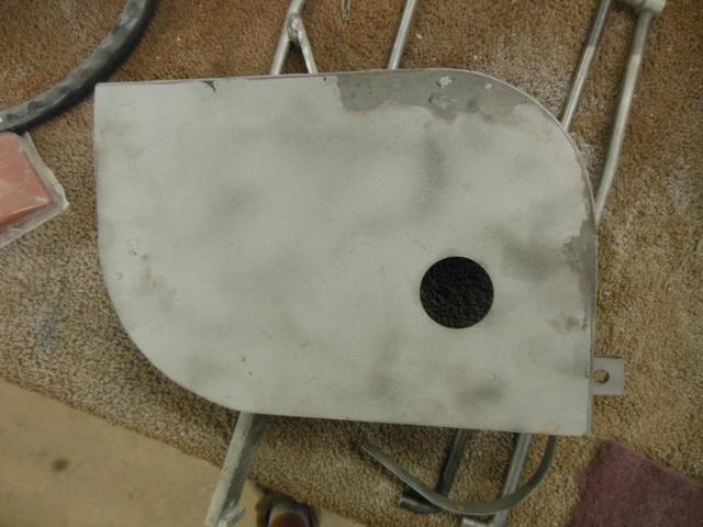

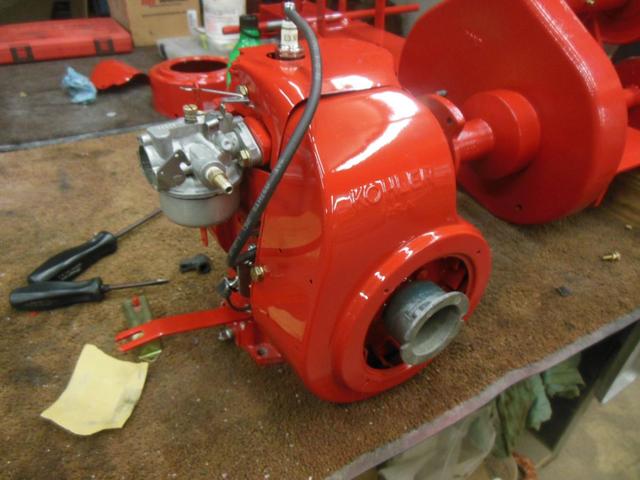

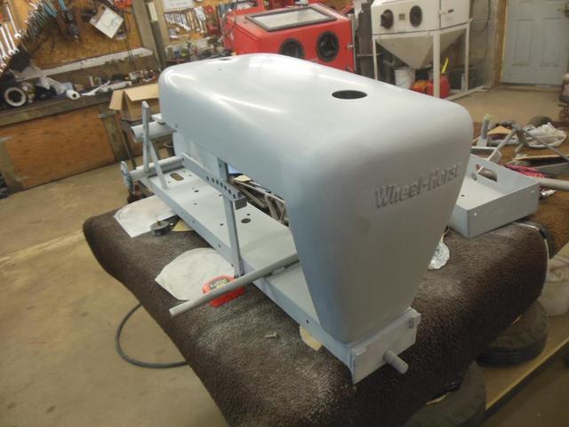

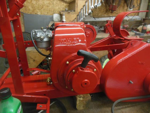

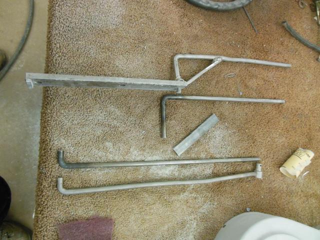

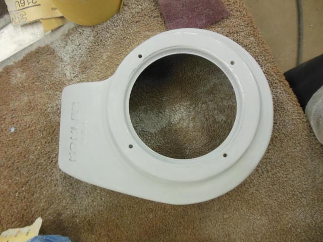

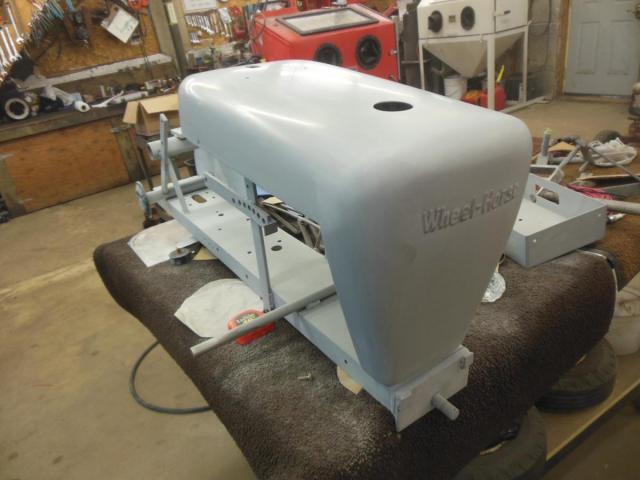

Jake Kuhn 1,599 #51 Posted July 23, 2014 (edited) Here's a little update on the 57. Sunday I put the engine back together as a short block. It ended up just getting new gaskets/seals, a valve job and a new set of rings/ the cylinder honed. It should be a good engine as there was nothing wrong with it before I tore it apart. I got the shroud/hood done and ready for paint. Also, made a new speed selector rod and started making a speed selector arm, just have to pick up a piece of bar stock. Picked up a repop belt guard for it at the show, it is going to take some work to make it nice, but its better than nothing. I have a couple more brackets to finish sanding, and still have to fill some rust pits on the lift lever, but this is getting close to a last batch of paint. I don't see it being an issue on finishing this for the show in september. Anyways, here's a couple photos. Thanks, Jake Edited July 23, 2014 by Jake Kuhn 3 Share this post Link to post Share on other sites

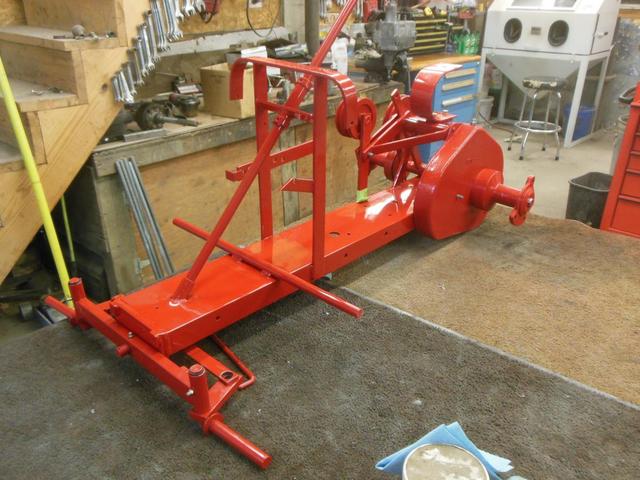

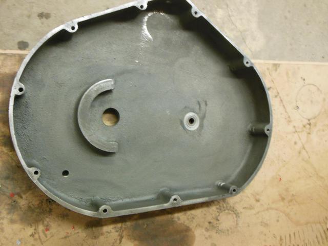

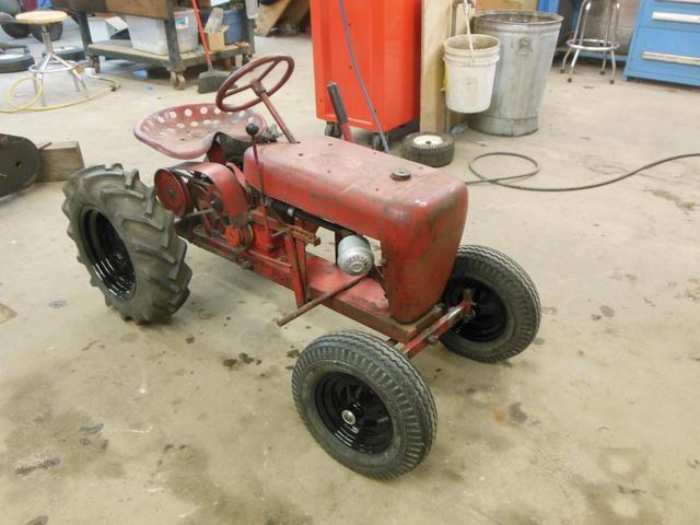

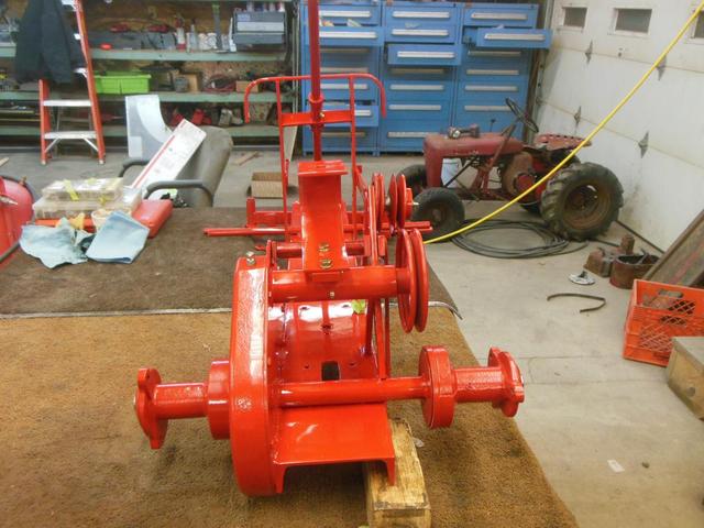

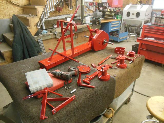

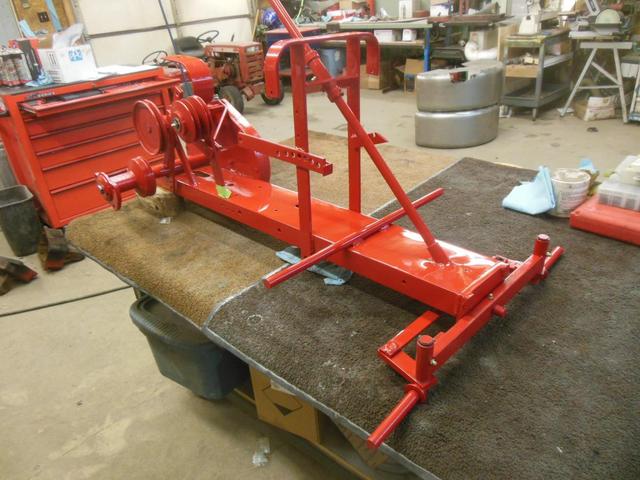

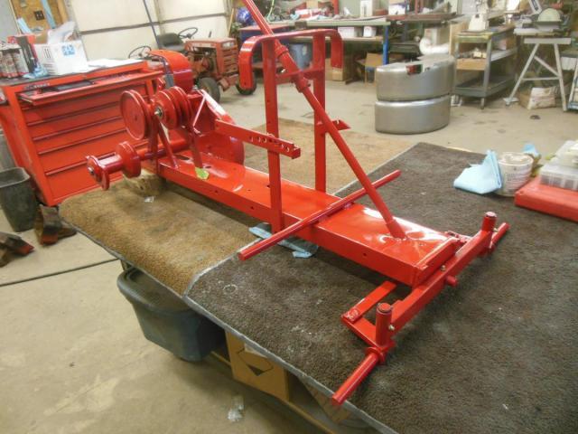

Jake Kuhn 1,599 #53 Posted January 28, 2015 The fun part has began! Got the hood and frame painted on sunday. Tonight I put the drive system and the steering together, it is as far as I can go for now, but was glad to start assembling it. Still have the get the wheels and speed selector arm done, but everything else is done. I am going to get some bolts plated, and then I can put it most of the rest of the way together. Anyways, heres a couple pictures, going together very easy so far, very happy with how its turning out. Thanks, Jake 6 Share this post Link to post Share on other sites

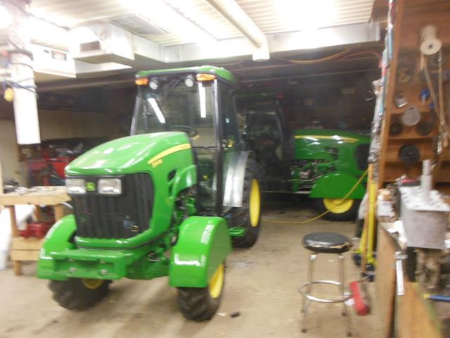

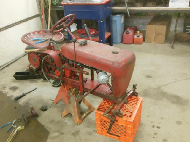

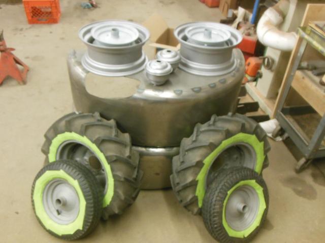

Fun Engineer 863 #59 Posted January 28, 2015 Looking good Jake. This is the time when all your hard work pays off. It's very gratifying to see it resemble a tractor again. What's the story behind those fenders in picture #3? Is that a new project? Sent from my tractor seat. Share this post Link to post Share on other sites
HorseHead1089 100 #60 Posted January 28, 2015 Finally got some stuff painted. The fenders and belt shield go to the 401, the rest is to this. Frame is just about ready for primer now too. DSCN2003.JPG How did you not get paint every where with such a nice even cover. Need to figure out a way to control my paint situation as last time it ended up all over the garage Share this post Link to post Share on other sites
Jake Kuhn 1,599 #61 Posted January 29, 2015 Thanks all for the comments! Dave, the fenders sadly are not for wheel horses...lol My dad builds fenders for the John Deere Orchard tractors as they do not offer fenders on there tractors now, those will be a set of front fenders. He's been building them for about 10 years now, and usually does about 15 tractors a year, the local dealer around here just makes that an option now on the new tractors and buys them from him Here's a couple he did about a couple months ago, don't have a picture with rears mounted. Horsehead, as far as not making a mess, it was not painted where its sitting now, It was painted over at the body shop in the spray booth there, 1 Share this post Link to post Share on other sites

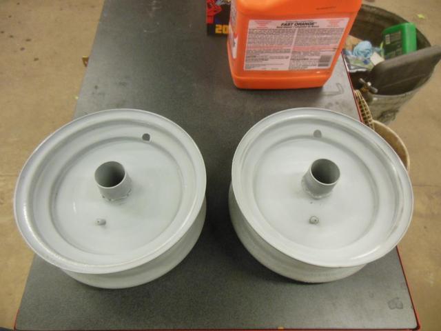

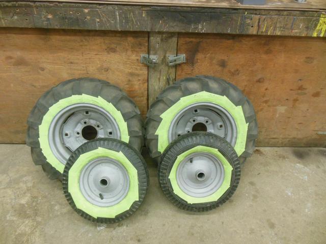

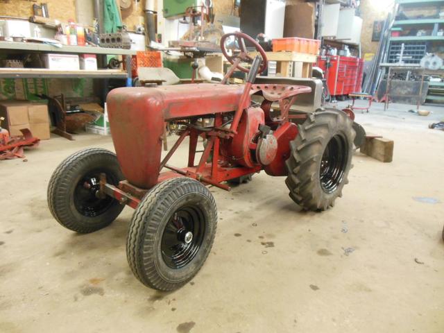

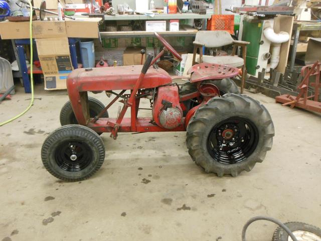

Jake Kuhn 1,599 #62 Posted January 30, 2015 Got the engine running yesterday...seems to run pretty decent, and not smoke. Also, got the front wheels sanded and rears beadblasted, those are now ready for paint, I need to put a freeze plug in the oil bath and paint them black. Thanks, Jake 1 Share this post Link to post Share on other sites

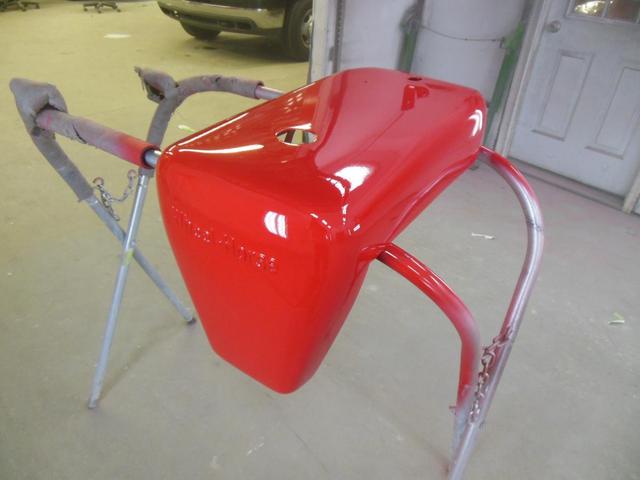

953 nut 66,860 #63 Posted February 1, 2015 Great body and paint work! I presume you are using a quality automotive paint, no way would hardware store enamel come out that good. 1 Share this post Link to post Share on other sites

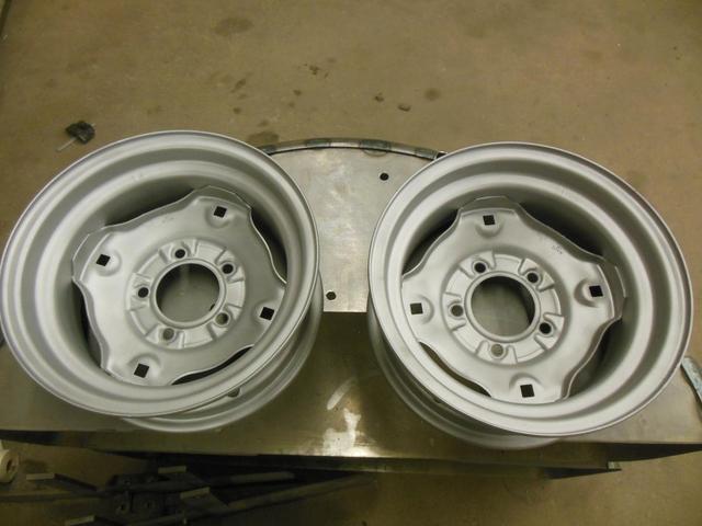

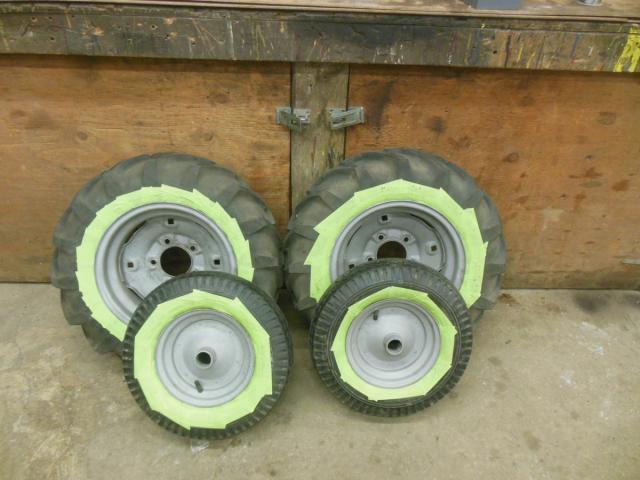

Jake Kuhn 1,599 #67 Posted February 2, 2015 thanks all for the comments! This did start out as a partial redo, but part way through I decided to switch gears....I was just going to prime it and mechanically make it right, but ended up going for a full resto....wanted to do it right the first time. I may suffer under the same disease as you martin, but I'm not that good with details yet....maybe someday. Anyways, not much new progress on the rj, I did go through the recoil today, as it was not catching, put new pauls, and felts inside it, and it now works good, and got it mounted, looks good on there. And also, while I was going to paint the rims black for this, I wanted to paint the rims on the 55 I picked up a couple weeks ago, blasted them, and hope to spray these parts black tomorrow. And while the rj was sitting there with no wheels, I wanted to fix the leaking rear end, turns out the axle has a lot of slop in it, I didn't mess with it much today just ripped it apart, hopefully I can just change the bushings, and seal and it will be ok, but not sure yet. Anyways, here's a couple pics of it as it sits Have no school tomorrow from the snow, so hope to work on the rear end on the 55 tomorrow. 1 Share this post Link to post Share on other sites

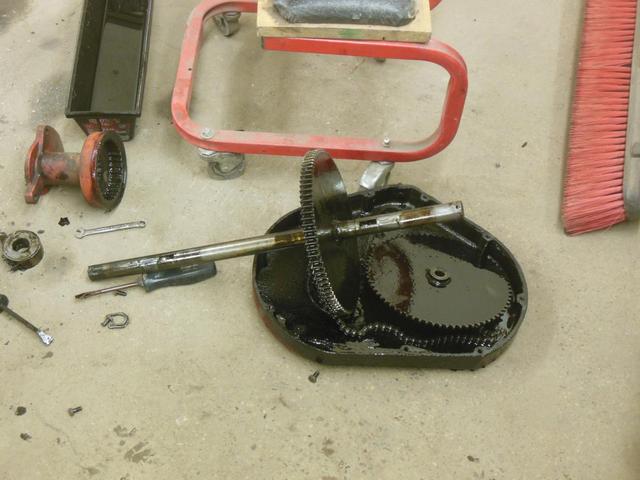

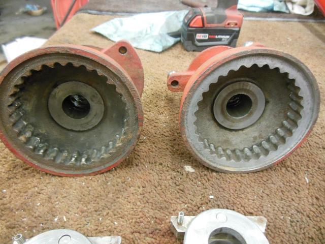

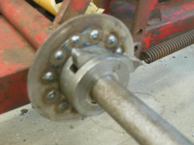

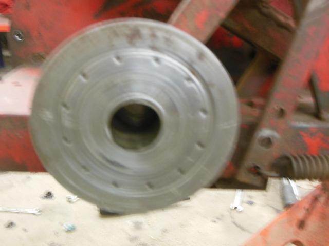

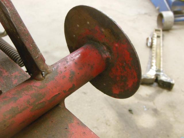

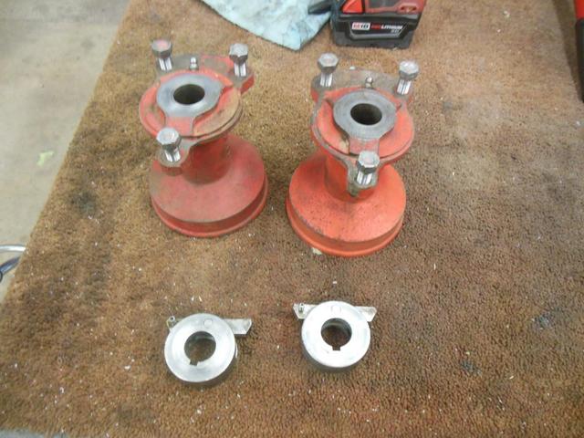

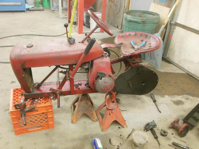

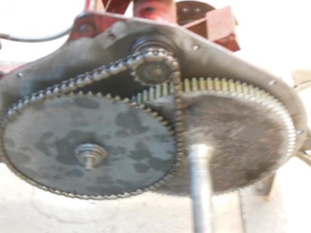

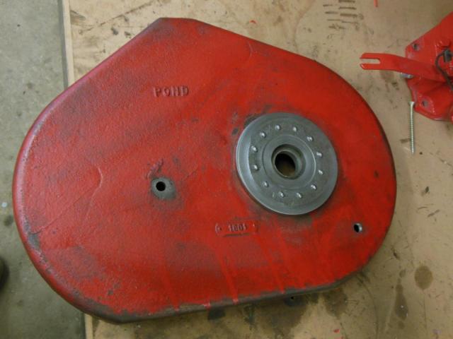

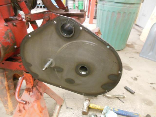

Jake Kuhn 1,599 #73 Posted February 5, 2015 Go it back together today...rear end actually ended up being pretty bad., one of the bushings was badly worn, which made the axle move up and down which just about destroyed the axle/gear as well as the other gear. Luckily I had a parts tractor I bought at the big show that had gears in it I used to fix this one. Also noticed it only drove from one wheel, it looks this one was messed up from the factory as they welded the plate on backwards that cause the pauls to engage, the hub is however in great shape on that side which is a plug, to get it driving again just ended up welding where the dimples were and now it guides the springs and the paul engages driving the wheel! Also cleaned up the spindles old dried up grease and got everything nice and smooth, also added a set of the pins that go in the tie bar which helped tighten it up some. Here's a few pictures of it in progress and back together, Gear case cover cleaned up... where the plate was installed wrong and welded hubs/pauls cleaned up and back side of the case and finally a shot before the cover was installed Back on all 4's 5 Share this post Link to post Share on other sites

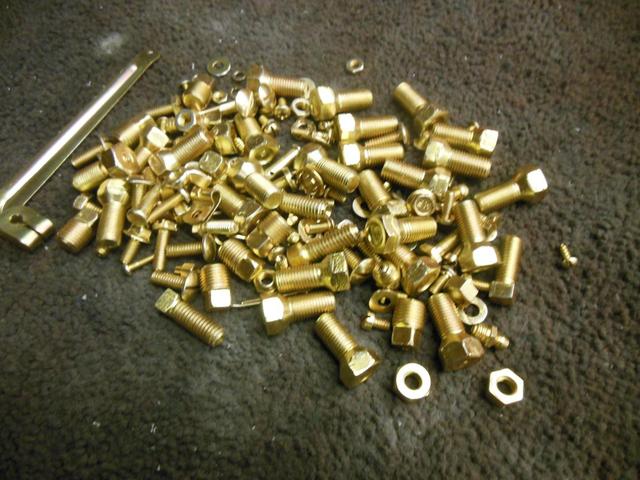

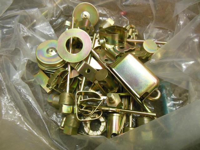

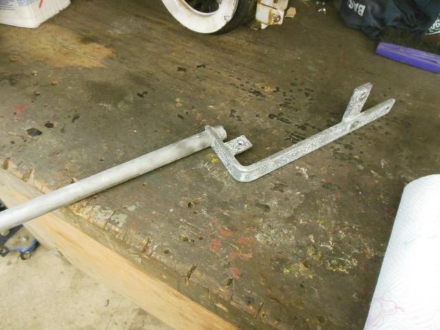

Jake Kuhn 1,599 #74 Posted February 26, 2015 Got some parts back today, can finally start putting it together a little more. 3 Share this post Link to post Share on other sites
newt 14 #75 Posted February 26, 2015 hi, Jake, nice work! if I ever restore my rj like this, it will be parked in the living room, never see sun again!! what kind of plating or coating did you use on all that hardware? and where do you get it done? it really looks good! thanks - newt 1 Share this post Link to post Share on other sites
