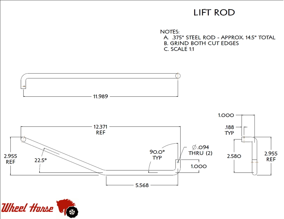

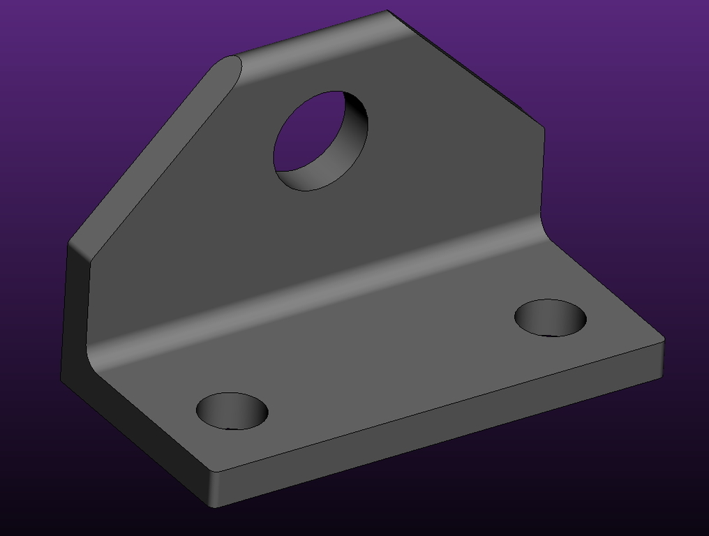

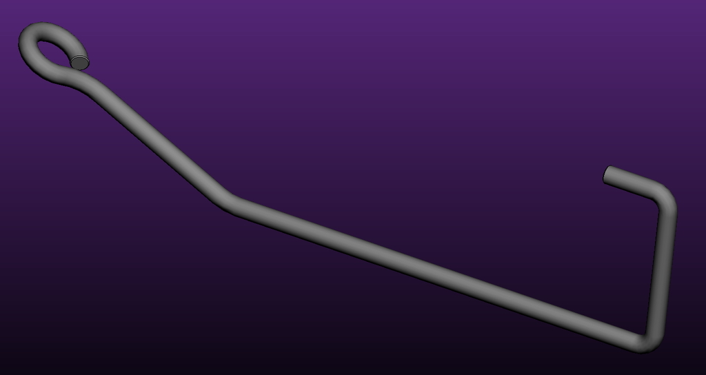

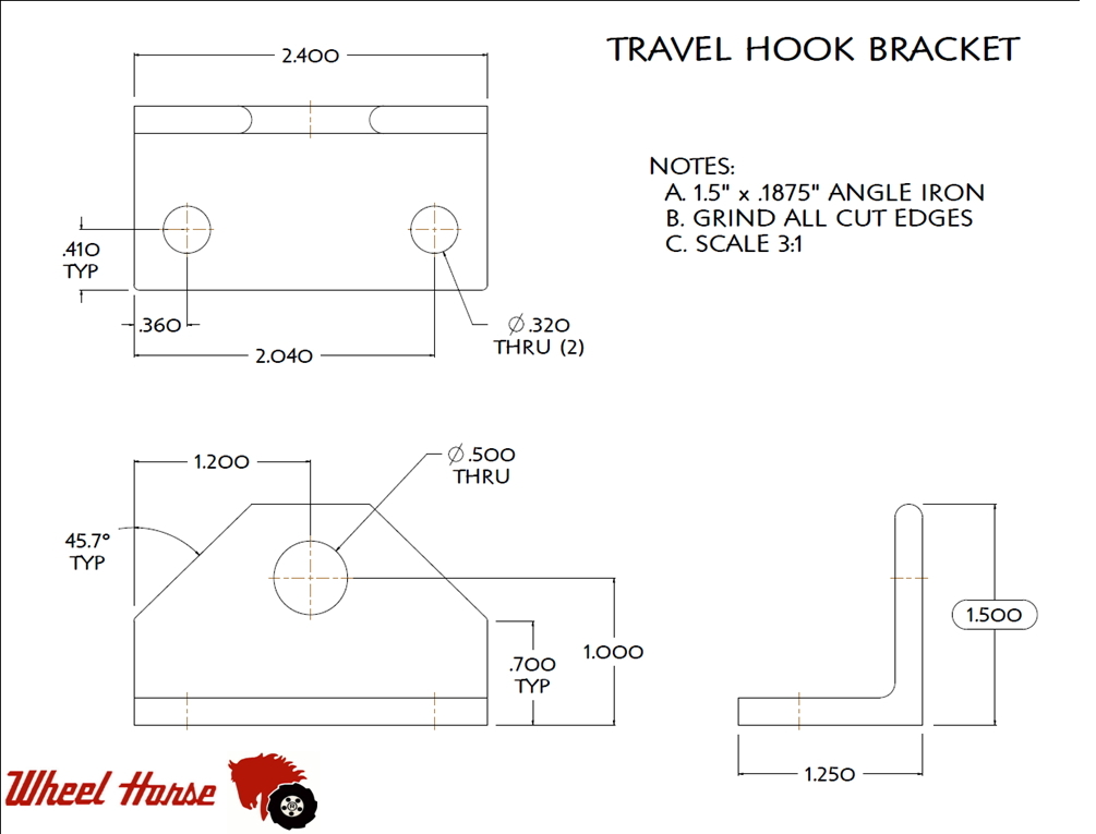

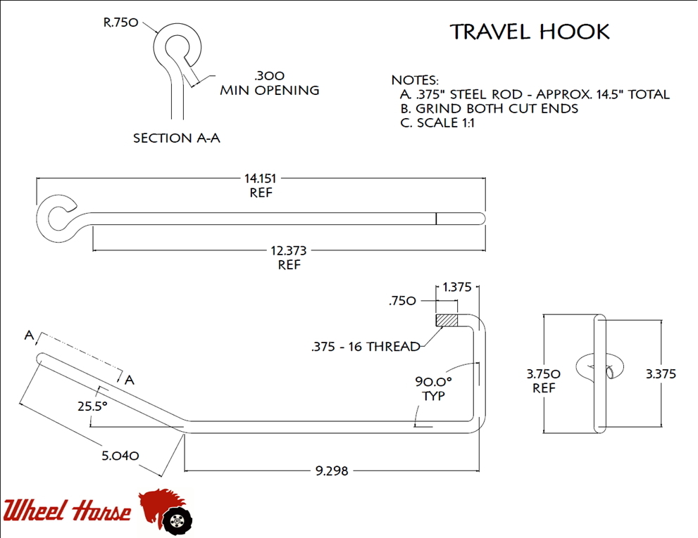

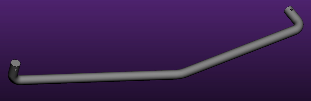

dclarke 4,113 #1 Posted October 18, 2012 These are for my "867" with a SMS425 sickle. 4 Share this post Link to post Share on other sites
sorekiwi 761 #2 Posted October 18, 2012 A BIG Thank you for Denny for coming up with this. The travel hook is missing on a lot of the sickle mowers that turn up, and the lift rod will enable those that have the early ones that werent equiped with one to make their mowers a bunch more user friendly. THANK YOU!! 1 Share this post Link to post Share on other sites
dclarke 4,113 #3 Posted July 24, 2017 Here are the specs again, seems photobucket no longer lets me share them. 2 Share this post Link to post Share on other sites
WHX?? 53,722 #4 Posted July 24, 2017 Thanks for digging this out of the cellar Denny, way better than my lousy pics & measures! I was a little off on my angles! I'll put a link to it in my current sickle thread. Any chance you have the grass rod? Share this post Link to post Share on other sites
