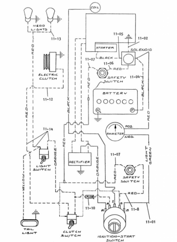

I am trying to breath life into a 73 automatic no name tractor that I have had for a few years now. The electrical harness was a mess and so many parts were robbed over the years that I am starting over. I have the simple diagrams for the engine but what I am missing is the section that covers the electric PTO wiring and associated safety switches.
I had the tractor running the other day by hot-wiring the thing and moving it back and forth in the yard with a battery jumper cabled to the motor.
Thanks in advance
rmaynard
post-2221-0-96676200-1350504977_thumb.pn
SousaKerry
Ok so there is no safety circuit that prevents you from starting the motor with the clutch on??
rmaynard
It looks to me like your ignition switch has two run positions. The lights and clutch are not energized until the switch is moved to the accessories position
Don1977
If you look at the wiring diagram the clutch switch has 4 wires attached and one runs through a safety switch that is attached to start on the key switch. That tells me it won't start with the PTO switch on.
