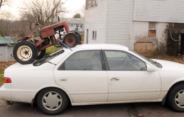

tomtractor 71 #2 Posted October 17, 2012 Nice style. I am hoping to purchase a Beaver tractor. Take off the tires and slip it into the back of my Toyota Matrix. I am hoping it will work. Attached is the first RJ I purchased. It wouldn't fit into my car! There are always options. 3 Share this post Link to post Share on other sites
AMC RULES 37,254 #3 Posted October 17, 2012 So...how much did that ticket cost you? Share this post Link to post Share on other sites

roscoemi 245 #12 Posted October 18, 2012 Tomtractor, that is redneck as hell. I like it. :greetings-clappingyellow: Share this post Link to post Share on other sites
