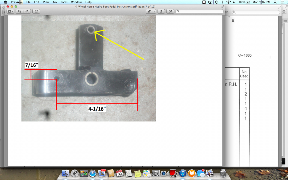

Martin 2,135 #57 Posted December 31, 2013 is the hole that is drilled in the side of the hydro cam control drilled EXACTLY as in the instructions? Share this post Link to post Share on other sites

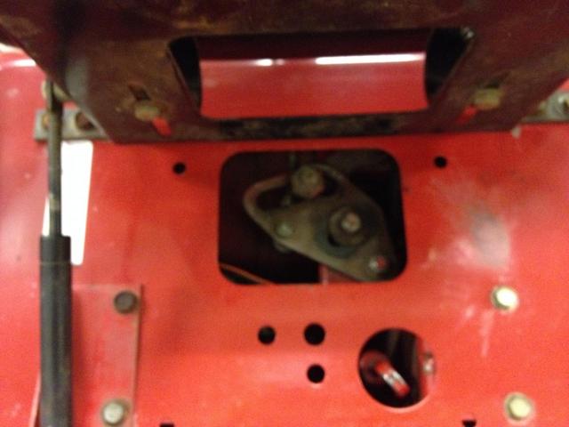

Martin 2,135 #60 Posted December 31, 2013 (edited) Brice, just an fyi...... heres my install.... i replaced the plastic bushings when i did mine as they were trashed...... video of it running is just a post or two down. you can see how my pedal is setup, maybe something else might stand out in the video thats not right with yours..... I'm sure we can get it sorted for you. just don't start a grinding on anything........ Edited December 31, 2013 by Martin Share this post Link to post Share on other sites

ba2988 28 #62 Posted December 31, 2013 (edited) Just took it apart to double check the measurements of the hole that I drilled in the cam. I'm exactly 4 1/16th on the long edge but am actually at 8/16 at center (instead of 7/16) on the short edge. Do you think the 1/16 variance is causing the issue? If so...I could elongate the hole or maybe swap from my other tractor and try again. Here is a link to video before I took apart. http://www.flickr.com/photos/97170477@N03/11660804384/ Edited December 31, 2013 by ba2988 Share this post Link to post Share on other sites
mattd860 163 #63 Posted December 31, 2013 Just took it apart to double check the measurements of the hole that I drilled in the cam. I'm exactly 4 1/16th on the long edge but am actually at 8/16 at center (instead of 7/16) on the short edge. Do you think the 1/16 variance is causing the issue? If so...I could elongate the hole or maybe swap from my other tractor and try again. It could be an issue but I'm not sure it will create the drastic issue that you are experiencing. However, just to be 100% sure I would swap it out from the other tractor. Share this post Link to post Share on other sites

Martin 2,135 #65 Posted December 31, 2013 (edited) Brice, two things... first, the extra spacer on the end of the rod where it connects to the hydro cam control, should only be one there...... the rod comes across at a slight angle when looking down from the top, yours looks like it runs parallel with the length of the tractor. second, i can tell you have way more travel in reverse than forward, can you do another video the same but this time showing the pump brackets etc....? Edited December 31, 2013 by Martin Share this post Link to post Share on other sites

Martin 2,135 #67 Posted December 31, 2013 look at where your neutral position is compared with the neutral in my pic above. neutral should be right where the loud clunk is as you are going into reverse in your video. the position is sort of above the point in the bottom of the slot in that bracket. start in that general position and rotate the cam ( large hex under the bolt) to get the wheels to stop rotating and find your neutral...... that is where you should be at the back before attaching your rod...... way too much travel in reverse. Share this post Link to post Share on other sites
