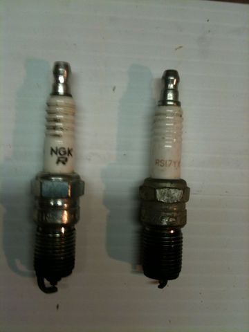

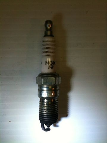

Save Old Iron 1,576 #38 Posted October 22, 2012 The replacement NGK plugs were not equipped with washers either. Cheers, Paul Paul, thanks for the info on the sparkplugs. I never really took the time to look closely at the position of the plug tip in relation to the bottom of a K cylinder head. We will see how this all evolves. :eusa-think: Share this post Link to post Share on other sites
