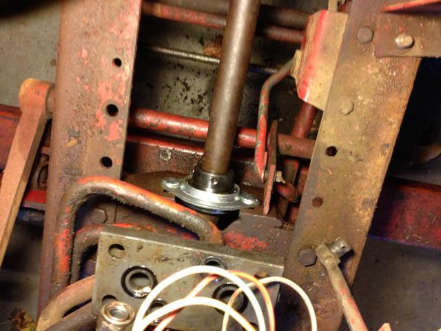

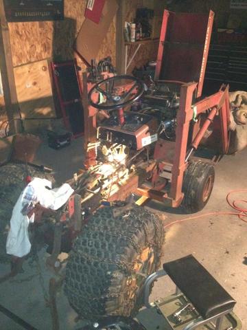

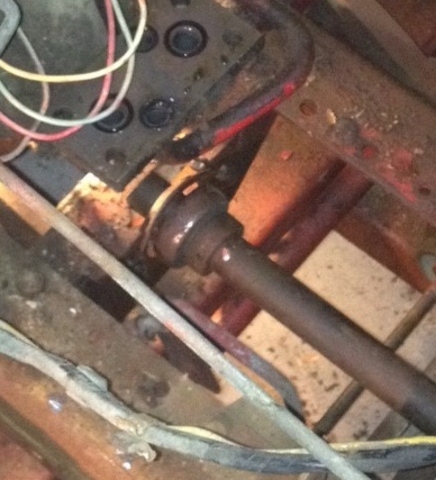

brandon701 23 #1 Posted October 11, 2012 Is it a common problem for the hydraulic transmission shaft and the coupler that attaches to the engine to strip out? Well mine did and now im in the process of repairing it. I think i may have another transmission and coupler if the 18 automatic tractor has the same transmission and coupler. I also found another problem. The mid pto shaft bearing that is under the transmission is shot. I was wondering if you have to remove the pto shaft to replace the bearing and also were am I going to find one. I have included a picture of the bearing and also just a general picture of what the tractor looks like now. Share this post Link to post Share on other sites

1maidenfan 202 #3 Posted October 11, 2012 For starters lets start by saying "nice tractor with front loader" those couplers do go out and they are available here and there.(ebay easiest place to find them) As far as the center bearing on the pto, I believe you have to remove the whole shaft in order to replace the bearings and its not that easy at least it wasnt when I removed mine. If I remember right the center one is the hardest one to remove but since you have the trans out of yours you should be able to reach it pretty easialy. I get all my bearings locally at a place called applied industrial technologies. P.S. The coupler should be the same on all the D series tractors as long as you have a twin engine (kohler or onan) Share this post Link to post Share on other sites
1maidenfan 202 #4 Posted October 11, 2012 For starters lets start by saying "nice tractor with front loader" those couplers do go out and they are available here and there.(ebay easiest place to find them) As far as the center bearing on the pto, I believe you have to remove the whole shaft in order to replace the bearings and its not that easy at least it wasnt when I removed mine. If I remember right the center one is the hardest one to remove but since you have the trans out of yours you should be able to reach it pretty easialy. I get all my bearings locally at a place called applied industrial technologies. P.S. The coupler should be the same on all the D series tractors as long as you have a twin engine (kohler or onan) There is a new (n.o.s.) one on ebay right now but they want top dollar for it. Might check with a local TORO dealer also, might get lucky and find one there. Keep us posted on your progress. Share this post Link to post Share on other sites

Trouty56 567 #6 Posted October 11, 2012 Those bearings on the PTO have a locking collar, There is a set screw but the collar gets tight as the bearing rotates or visa versa. Here is an example of what to purchase.... http://www.fastenal.com/web/products/detail.ex?sku=0402136 1 Share this post Link to post Share on other sites
brandon701 23 #7 Posted October 11, 2012 Is that bearing suppose to be seated in some sort of case. Kind of hard to example what im trying to say on the internet. In the bearing picture there is something that the bearing rides in that is bolted to the frame. That is under the hydraulic connection. Share this post Link to post Share on other sites
Marv 994 #8 Posted October 12, 2012 There should be two "flanges" like the one in the picture beside the bearing. They get bolted together and hold the bearing between them. The collar that locks the bearing to the shaft is tightened on the shaft by turning the collar on the bearing after the bearing is in place on the shaft. If the bearing is an original installation and was done according to the instructions.the collar is tightend on the shaft in the opposite direction from what you would think. Consequently, when you go to remove the bearing you have to loosen the collar by rotating it in the correct direction. I am not at home now but when I get there I will check the direction and let you know. PM me if you like. I may be able to email the instructions. I get my bearings from KAMAN which I think is the Applied Technologies mentioned. Share this post Link to post Share on other sites

Trouty56 567 #10 Posted October 12, 2012 Is that bearing suppose to be seated in some sort of case. Kind of hard to example what im trying to say on the internet. In the bearing picture there is something that the bearing rides in that is bolted to the frame. That is under the hydraulic connection. Look at the front bearing... There is a similar flange assembly to hold the insert bearing. Pto Shaft.pdf Share this post Link to post Share on other sites

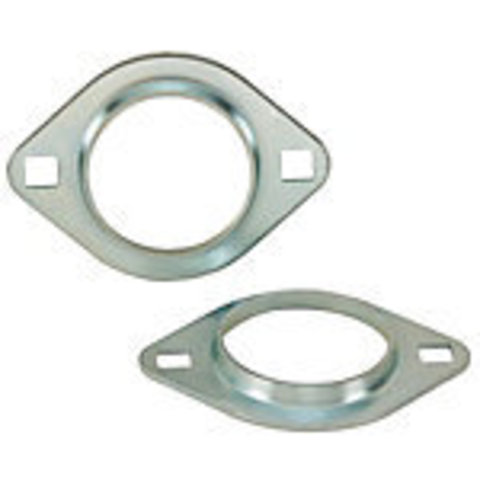

brandon701 23 #20 Posted October 14, 2012 Purchased some flanges at tractor supply tonight. Hope they fit. Share this post Link to post Share on other sites
1maidenfan 202 #21 Posted October 14, 2012 Purchased some flanges at tractor supply tonight. Hope they fit. Can you show us some pix of what you found at tractor supply? Thanks Share this post Link to post Share on other sites
brandon701 23 #22 Posted October 14, 2012 Looks something like this. I dont know if its the right one or not. Share this post Link to post Share on other sites
