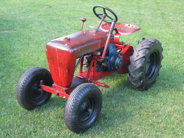

How can I make new paiint blend in with original paint. I have seen this done on cars before. I have a newely painted belt guard and brackets that I want to use. Thanks! krazy_horse

Bob, It is a nice old original tractor, I would like to keep the org. platina look. I want it to function as it should,some one else will get that chance later on. Thanks for the reply. krazy_horse

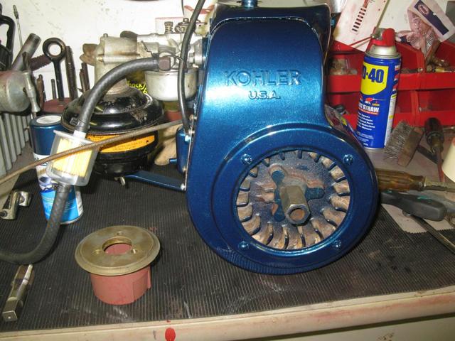

For some reason I do not remember I had to re paint the engine tins on my well aged 56 RJ. After paint I scuffed them up with scotchbrite and thinner. Came out pretty good IMO.
