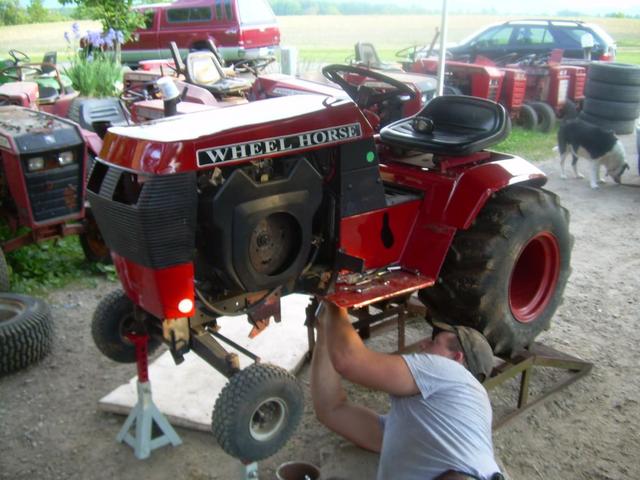

baerpath
This is a 20hp in a 312-8, size of a 25hp is the same. But you need the flat top air cleaner the tall round one won't fit under
You'll need to make your own mounts but we know you can do it.
Deere Hunter
Yes it can be done. Used 1/4" steel plate under the engine to mount it. The only thing that wouldnt fit was the plastic air cleaner top but the air filter cleared.
