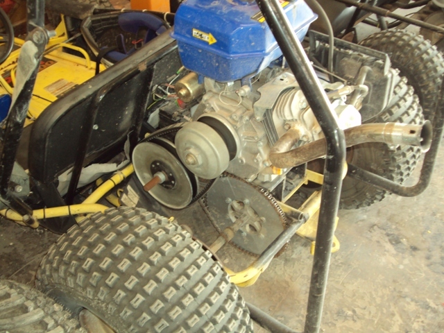

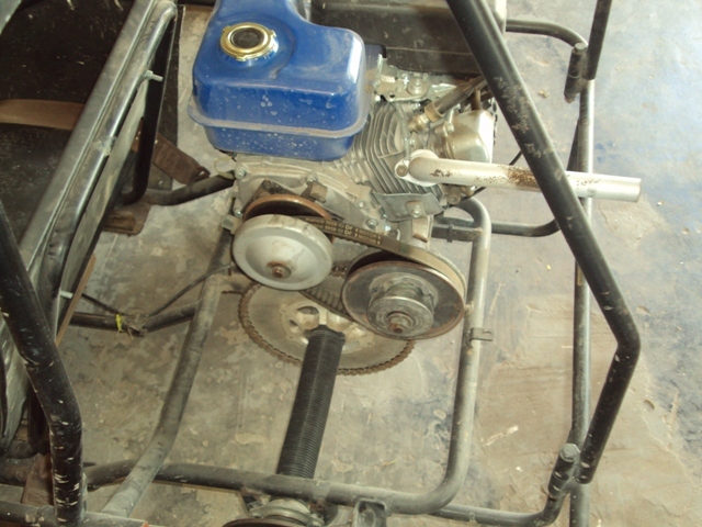

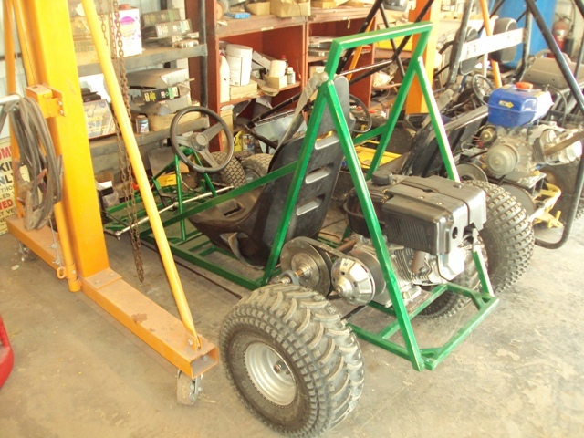

bowtiebutler956 650 #8 Posted October 14, 2012 I remove the governors on all my off road buggies, but definitely not my Garden Tractors! The buggies are hot rodded toys that we try to get every last drop of speed out of, and to date I have'nt had one explode yet, but there's always tomorrow! Matt :flags-texas: Share this post Link to post Share on other sites
