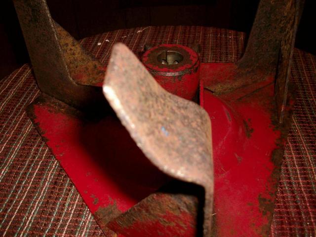

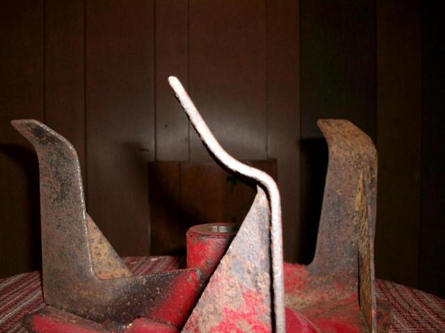

scraper 4 #1 Posted October 5, 2012 I'm almost done with the rebuild. looking at the impeller, I'm not sure whether that one bent fin is supposed to be that way or not. Anybody have an undamaged impeller to compare it to. If it is bent, what is the correct angle of the fin. Share this post Link to post Share on other sites
KATO 115 #2 Posted October 5, 2012 Looks like some one sucked up a piece of wood or something !!!! it should look like the other two, not sure of the exact angle ,but they should all be the same. KEN Share this post Link to post Share on other sites
AMC RULES 37,223 #3 Posted October 5, 2012 Ouch...that looks painful. Share this post Link to post Share on other sites
wallfish 18,451 #4 Posted October 5, 2012 Like KATO said "They should all be the same". Probably use some heat to bend it back so it doesn't crack. Share this post Link to post Share on other sites
Tankman 3,523 #5 Posted October 5, 2012 A 5 lb. sledge and a block should do the trick. All should be the same, or as identical as possible. Share this post Link to post Share on other sites
