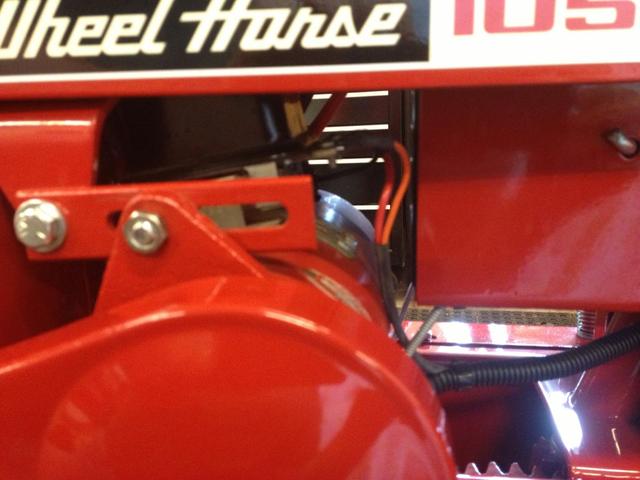

855ownerJoel 32 #5 Posted October 25, 2012 Martin, Do you have or could you send me a close up photo of the belt pulley on the engine (PTO as I see many call it)? I need to look at mine, for proper restore. I think mine is wrong since its a double pulley and i believe it should be a triple. Thanks Share this post Link to post Share on other sites
Martin 2,135 #6 Posted October 25, 2012 this one? this is the correct one, a double..... outside groove trans drive belt, inside groove hydro pump drive belt. the pto drive pulley fits on the end of the output shaft and is not shown in these two pics....... looks like this one on my 1057...... 1 Share this post Link to post Share on other sites
