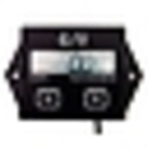

sadixon49 11 #28 Posted October 5, 2012 I bought a tach/hourmeter off of evil-bay a couple of years ago. A generic tiny-tach, I believe I spent less than $20.00 with shipping. The tach was installed on my new Toro 726OXE snowblower to keep track of service hours. It is a very simple induction tach, just wrap the pickup wire around the spark plug wire and mount the tach on the dash. I used double sided tape to mount mine. At those prices I can't imagine why more people don't do this. It shows hours of service when not running and rpm when running. steve Share this post Link to post Share on other sites
