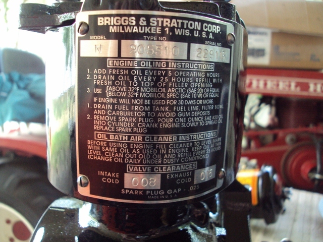

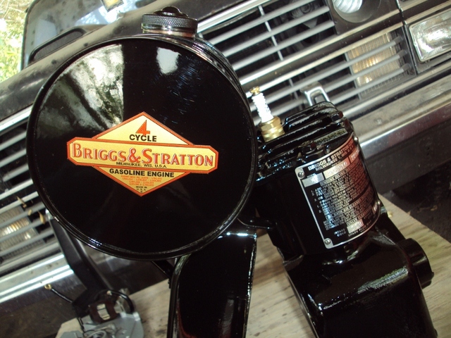

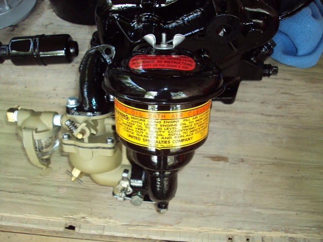

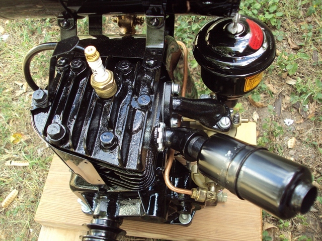

bowtiebutler956 650 #26 Posted October 1, 2012 I got my new ID tag, and decals in the mail today, and WOW. They look fantastic!! Here are a couple pics. Matt :flags-texas: 1 Share this post Link to post Share on other sites

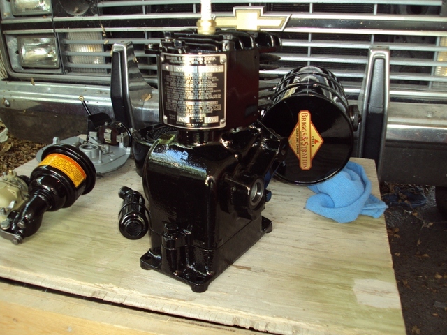

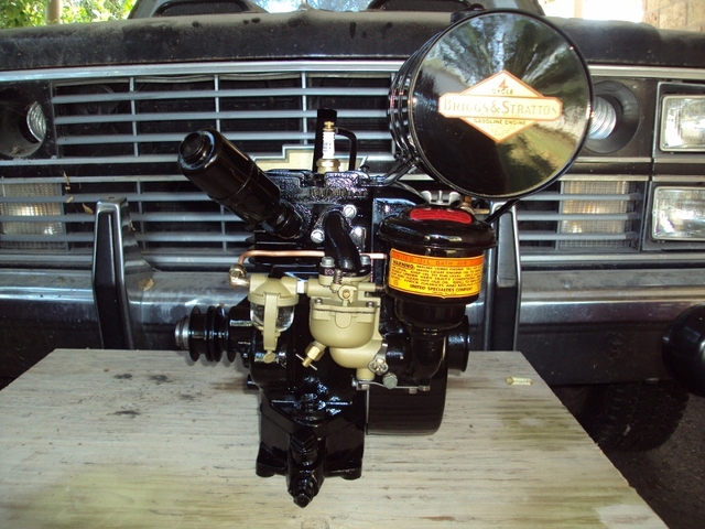

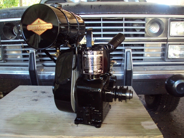

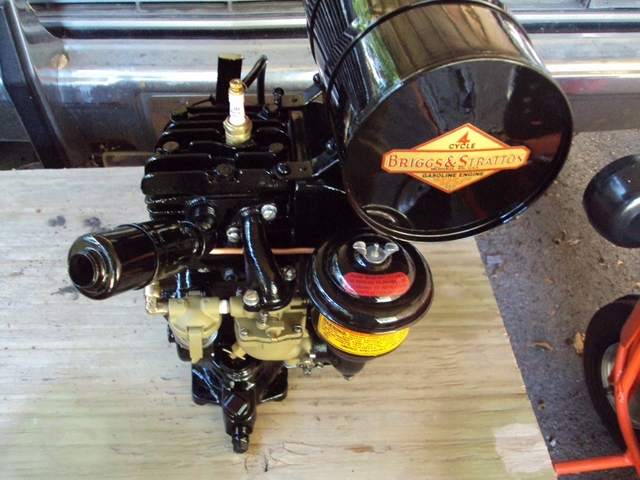

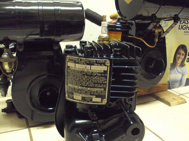

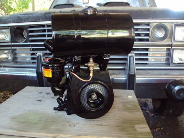

bowtiebutler956 650 #27 Posted October 4, 2012 Although I'm still waiting on a couple parts to come in, I decided to mock the engine up so I could fit the fuel line, and check a couple other things. Thought I'd post a couple pics, to see what you guys think. Matt :flags-texas: Share this post Link to post Share on other sites
Martin 2,133 #28 Posted October 4, 2012 looking good matt. those id plates and the decals really finish it off..... that chevy is bringing back some memories. i really liked the few 81-87 gm full size trucks i had. also a 89 blazer and 90 suburban too...... 1 Share this post Link to post Share on other sites
bowtiebutler956 650 #29 Posted October 4, 2012 looking good matt. those id plates and the decals really finish it off..... that chevy is bringing back some memories. i really liked the few 81-87 gm full size trucks i had. also a 89 blazer and 90 suburban too...... Thanks Martin. I've always been a sucker for these old Chevy trucks, and although its very neglected at the moment, this is my baby. She's a runner with a 383 stroker, with Scat forged rotating assembley, Manley forged pistons, Brodix IK200 heads, Lunati VooDoo series 292 cam, Edlebrock RPM Air Gap intake, Holley 800 DP Carb with a Proform main body, and the list goes on, and on. If I could get the transmission to stop exploding on me with its 3000rpm stall, and competion shift kit, I'd enjoy it a whole lot more! I really should go with a THM400, but with 4.10 gears, the THM700r4's overdrive, and lockup make for a much nicer highway RPM. I'm really enjoying seeing this little Briggs come together. Matt :flags-texas: 1 Share this post Link to post Share on other sites
AMC RULES 37,187 #30 Posted October 4, 2012 Engine looks like a work of art...who repops the ID tags Matt? 1 Share this post Link to post Share on other sites
bowtiebutler956 650 #31 Posted October 4, 2012 Engine looks like a work of art...who repops the ID tags Matt? Craig, It was done by a place called Yesterday's Rides Metalworks. They did a fantastic job. Matt :flags-texas: Share this post Link to post Share on other sites

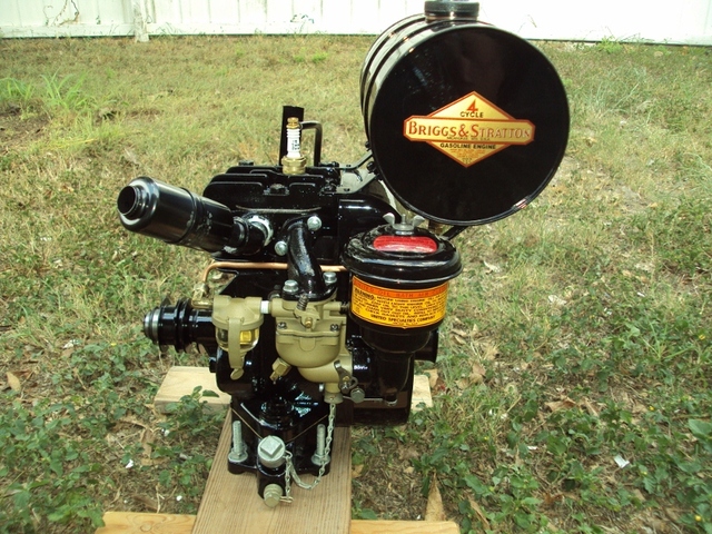

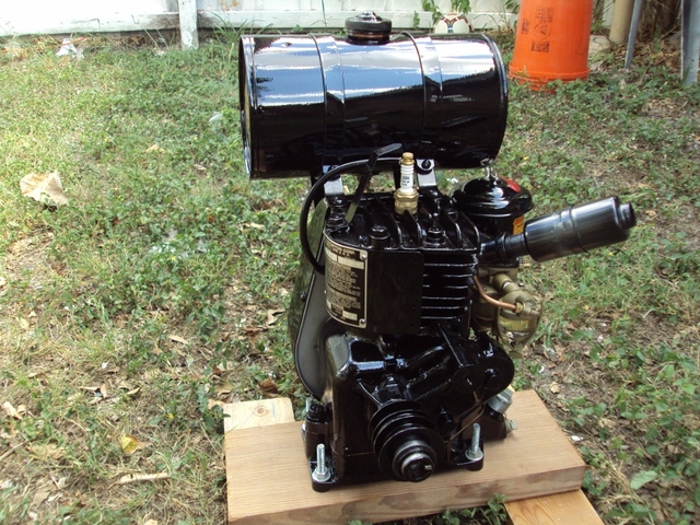

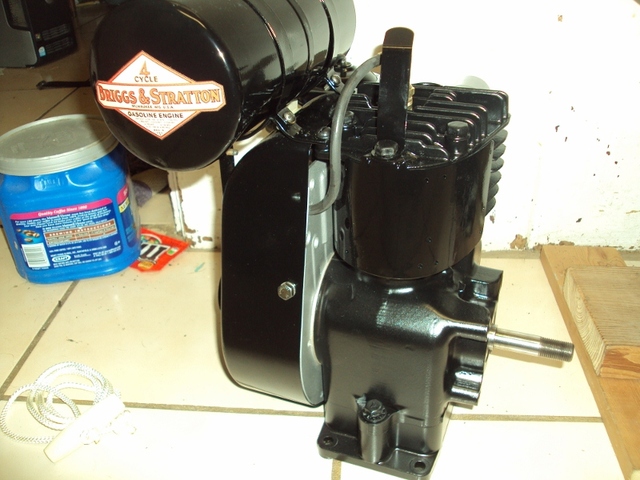

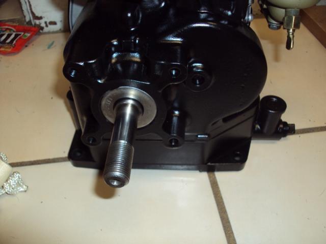

bowtiebutler956 650 #34 Posted October 11, 2012 Well, its finished! This little engine runs fantastic, and I couldn't be happier with it. Here is a video, and a few pics. Thanks Matt http://youtu.be/Q--p_qa0DwI Share this post Link to post Share on other sites
groundhog47 347 #35 Posted October 11, 2012 Hef'll be wantin' that as a centerfold. Wow US HAD SOME TOUGH BUILT LITTLE ENGINES. Great job! 1 Share this post Link to post Share on other sites
KATO 115 #36 Posted October 11, 2012 That looks AMAZING !!!!! 1 Share this post Link to post Share on other sites

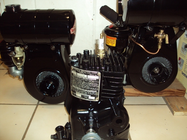

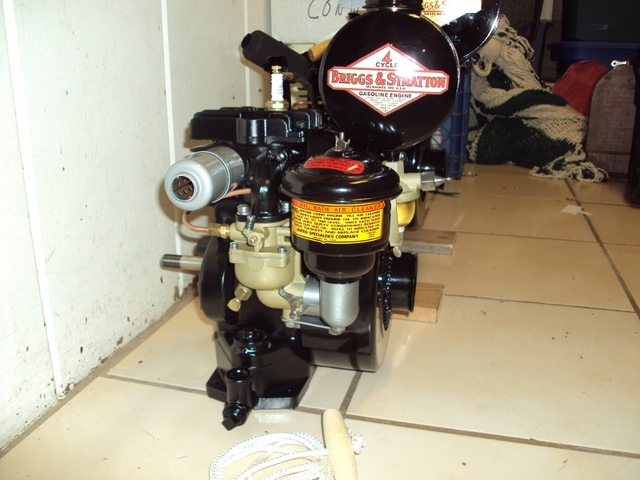

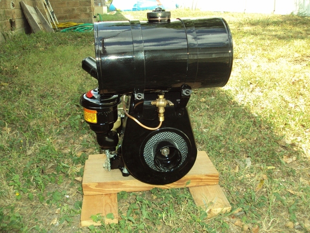

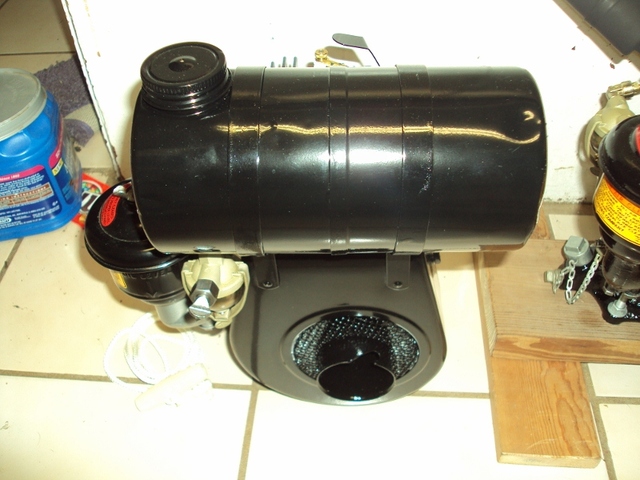

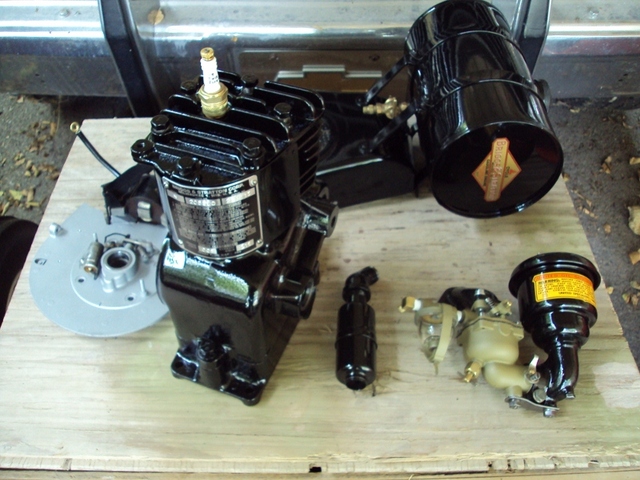

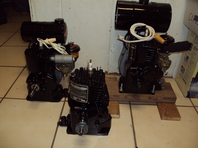

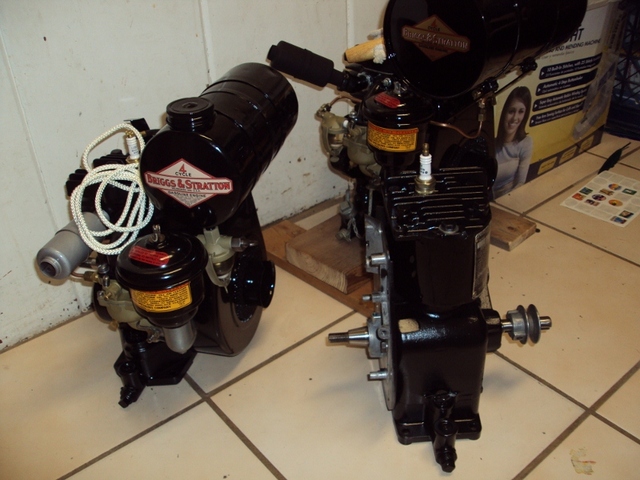

bowtiebutler956 650 #43 Posted October 14, 2012 Actually since we're talking about this hobby, I thought I'd show a couple more N's I'm working on. Actually one is complete. I have a bunch of these little engines, and I decided its time to at least get them fixed, and looking presentable. The 44 N in this thread had everything done right, and correct, but we can't spend the big bucks on all of them, so these are economy builds. The one in the pics that is complete (a1950 NP) was in great shape inside, so it just got a valve job, new crank seals, gaskets, a rattle can paint job, new cheaper decals (they look cheaper too) , and I ordered a new ID tag as the original is in very poor shape. It runs fantastic, and doesn't smoke at all. The one in the pics that isn't complete (a 1949 N) got a hone job, and new rings, valves lapped, and a rattle can paint job. Its ID tag is still in ok shape, so I'll use it. It should be done very soon. I have a 52 NPR6 to start on, as soon as this one is done. Keep in mind that while these are all varitions of the model N, none of them are the same. Each is a different variation of the the same line. I know, I got it Bad! And yes, these pics were taken in my house, actually in my storage room. My wife is already complaining about the smell, but I like the smell of fresh paint, and gasoline! Matt :flags-texas: Share this post Link to post Share on other sites
