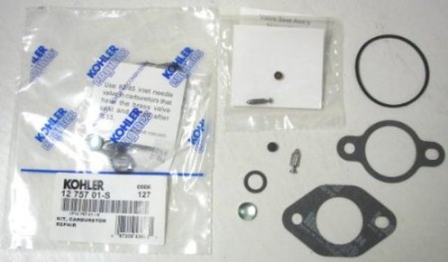

krazy_horse 59 #12 Posted September 28, 2012 that part number is a primeline or napa part number. the kohler number for that kit is 1275701-s for ch11-14, cv11-15 looks like the kohler kit is missing the same parts... just looked up a manual on the command engines and looks like the baffle isnt used on that model. the inlet seat is smaller than the earlier k carbs.... This kit is like the NAPA kit I bought notice the small seat and needle valve in the plastic package. I was told that was for the Magnum. I put the large one in the K-181 without the baffel gasket and it seems to run good so far.By the way there is Kits on Fle-Bay with Kohler spelled Kholer printed on the package.. Regards, Jim Share this post Link to post Share on other sites
krazy_horse 59 #13 Posted September 28, 2012 Martin, There has been a big mix up on this carb. kit. It has been bothering me and that is why I started this Advent because when I received this kit I found I was short some parts and had other parts I didn't need. I called in an order to NAPA the first of the week including a K-181 carb kit. I was sent a#7-030004 in the Kohler package. I had cleaned the carb. put the bowl gasket in along with the large needle valve and matching seat, no baffle gasket,I had to supply my own O-ring for the fuel inlet. So I got to checking in the out door catalog and called Napa this afternoon and gave them the numbers to which they said"We gave you the wrong kit but bring it back and we will exchange it for you" Well that's not going to happen because I have used about two thirds of it. Any way, sorry for the confusion.In the old days when you bought a carburetor repair kit you got everything. Again I was just ranting. Sorry, Regards, Jim 1 Share this post Link to post Share on other sites
