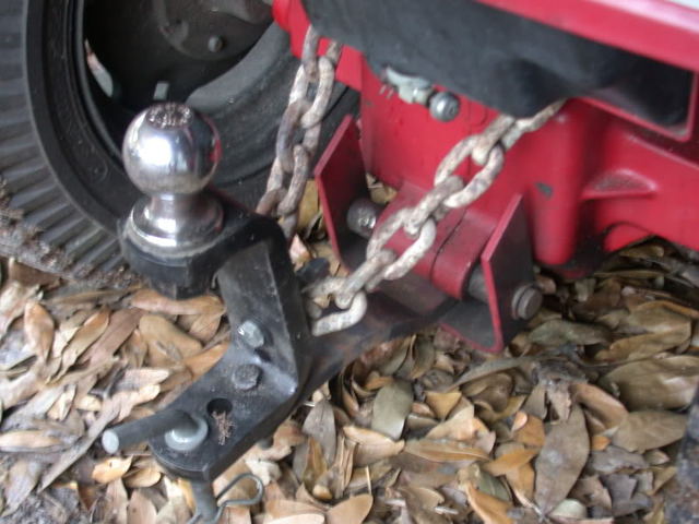

over60pirate 24 #4 Posted September 27, 2012 Unless you have wheel weights now, I would put the weight plates on the wheels. Why put more weight/strain on the wheel bearings/axles. You could rig a chain to help support weights on the hitch. Share this post Link to post Share on other sites

over60pirate 24 #7 Posted September 30, 2012 I have moved trailers with 150# tongue weight with this: Share this post Link to post Share on other sites

kpinnc 16,354 #9 Posted October 1, 2012 Just be sure to put something on the hitch to reduce the amount of concentrated pressure on the bottom of the tranny. "over60pirates" way above with the chains supporting the leverage is one way, and adding a "foot" under there is another: The hitch isn't the weak spot, but rather the upward force applied to the bottom of the transmission case. Trust me, they will crack. The more you spread out the load, the better. Cast iron will take quite a load, but if you "bounce" the weight, it will crack like glass in winter. Share this post Link to post Share on other sites
B-100 Dan 7 #10 Posted October 1, 2012 That is not the slot hitch, Over60pirate, thats the draw bar, the slot hitch is above the draw bar. The tractor in pic does not have a slot hitch on it. I've also pulled and hauled lots of weight on the draw bar. Just trying to clear up, thats all. Share this post Link to post Share on other sites
