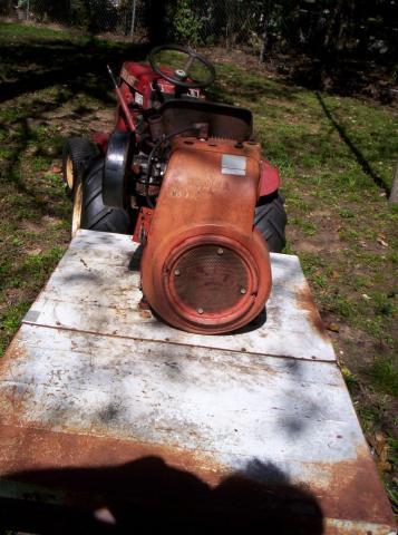

Well again thanks all >>>>>>>IT'S ALIVE, runs like a top on gravity feed remote tank> Was so excited, couldn't let grandson know, he's in school, couldn't get my son so let him hear it on answer/message, called my wife, she heard it runnin' but wasn't nearly as excited. It's on a straight pipe where old muffler was, reved it up and let off, beautiful pop, pop, pop. Idle is good but not good enough. Well, you know what the main problem was>>>>>>>CONDENSER. Then I didn't get flywheel properly (Maynard says....when will you have time to do it over), sheared the key, replaced (do over)(had alredy cleaned carb and reset points 15 times). When that flywheel key sheared it was bangin' like a loose rod, just about gave up and quote krazy_horse (Jim) "don't let it beat you!!" I didn't and kept on> Next gas tank and fuel pump (works but rusted inside), now I can think about a keyed crank also. Thanks all for the advice and support. Gerry
